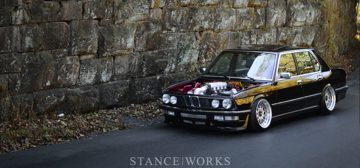

In the quest for improved suspension component options, better geometry, more steering angle, and if I were to guess, simply something to do, Dirk tore the car's front suspension and subframe out completely. In its place now sits a modified Z3 front subframe and steering rack, converting the car away from its original bus-style steering system. Aiding in the endeavor is an SLR Mini Angle kit, along with BC Racing coilovers, E46 control arms, and E46 330i brakes. Together, the setup makes for an E28 that boogies just a little bit harder than your run-of-the-mill example.
Clearly, Dirk isn't afraid to drive the car, and hard at that. Nevertheless, it's still a daily driver. Following the adage "What good is going fast if you don't look good doing it," his daily driver tightly hugs a gorgeous set of BBS RC041s - E36 M-technic wheels - that have been converted to 3-piece. Measuring out to 17x10 in the front and 17x10.5 out back, the car beautifully executes an OEM-plus-and-then-some style. Its further complimented by chrome euro bumpers, door handles, mirrors, and of course, Pfeba and BBS trimmings around the base of the car.
The outrageousness of a missing hood isn't beyond Dirk either. "I seem like a dick with the hood always off since, I still haven't gotten around to finding an undamaged one to modify. Oh well," he jokes. The complete lack of a hood makes for a bear-all peep show, and Dirk isn't afraid to show the gorgeous motor and candy-apple-red engine bay.
