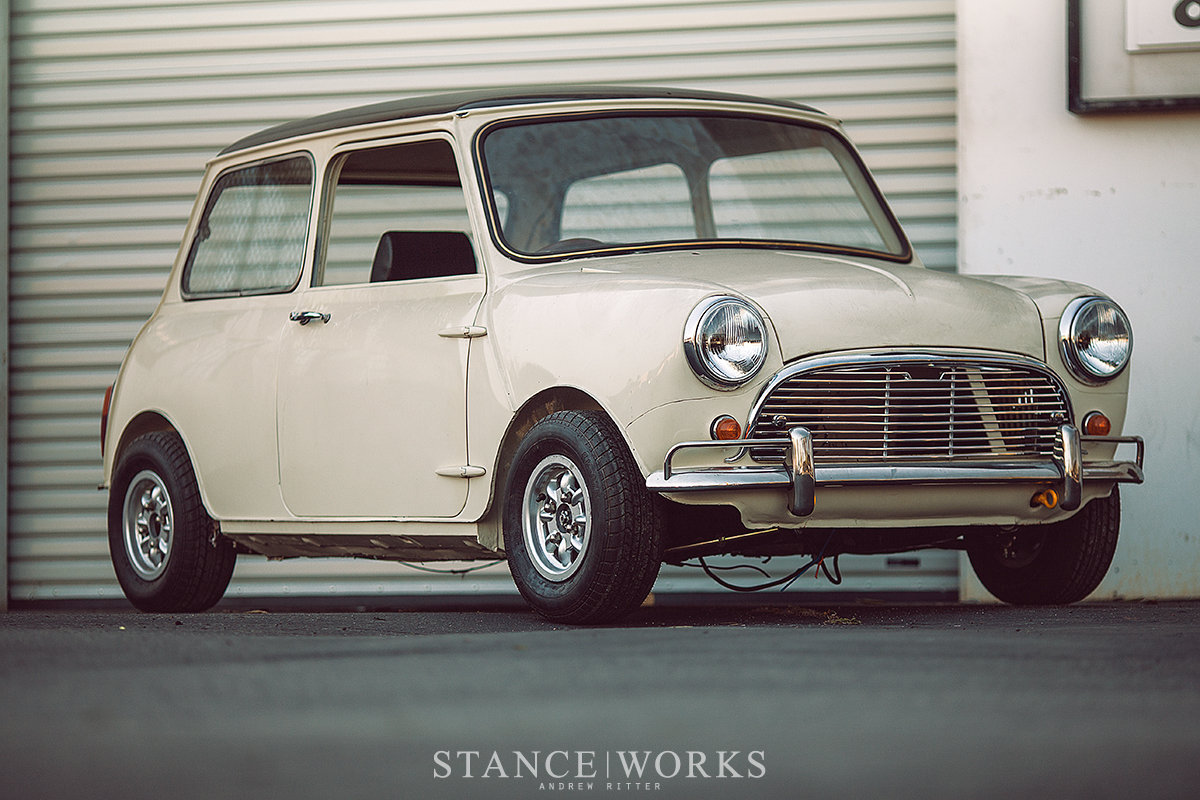

A little over 6 months ago, Mike and I loaded up his Land Cruiser and set the navigation towards a small town in the vast desert that lines the eastern half of the Golden State. Nestled in a small barn amidst a deserted tourist attraction was a little 1969 Mk2 Morris Mini that had come to a pause partway through a restoration. The body was sorted and a new layer of Old English White coated the panels, but without an engine or an interior, it sat as a shell patiently waiting for someone to kick the restoration back into gear. Being a ’69 meant that this Morris came with the external-hinged doors and sliding glass windows that are indicative of the early Mini models that I lusted after, and with its rust free metalwork I knew I had to jump on the opportunity. By the end of the day, we had a transport arranged and we were making room for the new Mini project in the StanceWorks Garage.
Having a bare shell felt like a wonderful blank canvas to start with, and the completed body meant that I could move straight into rebuilding it, unhindered by any necessary rusty repairs. On the flip-side, however, I began to realize that a bare shell also presented a few challenges. Over the years I’ve grown accustomed to the strategy of disassembling something, learning how it would all go back together along the way, but with only the bare essentials bolted to my new Mk2 project, I found that I’d be simply filling in the blanks with no previous guidelines. Fortunately for me, the guys at Mini Spares were happy to help. With its founding in 1975, their team has decades of experience in the restoration and racing of Minis, so I reached out to tap into their collective knowledge to see if we could put my Mk2 puzzle back together again. Noah , one of the members at Mini Spares, broke out the parts reference guides and walked me through the random little bits that I’d need to bring life back to my Mini. After penning a list of part numbers, I began my wait as the boxes made their way across the Atlantic Ocean.
Within a week, the StanceWorks shop space was filled with boxes from the UK. I laid out the new parts and took the first steps in the reassembly. Up front, the Mini received a facelift and a minor backdate, opting for the more understated Mk1 Grill to fit my vision for the build. A pair of Cibié headlights returned a period look to the car, taking the place of a pair of modern buckets that had been bolted in at some point. Without any bumpers included in the original sale, I looked through MiniSpare’s offerings and finally decided on a set of their stainless steel bumpers with the optional overriders. The overriders and corner bars date back to the early Mk1 Minis of the early 60s which is the era from which I draw much of my inspiration. With each new part bolted onto the face of my Mini, it began to look more and more like a real car.

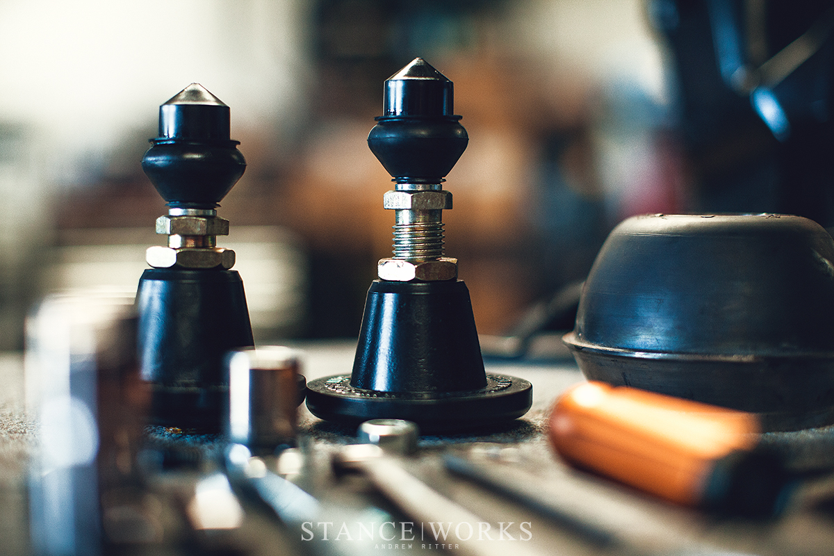

Up top is where the Mini’s suspension is incredibly unique. In place of the usual metal springs that we’re all familiar with, Mini utilized a rubber cone that functions in a similar way. As the Minis age and parts become more sparse, Mini Spares has taken it upon themselves to ensure that quality parts remain available for enthusiasts. Often times, quality rubber pieces are hard to find, but Mini Spares teamed up with a manufacturer to develop a set of rubber cones that could endure aggressive use while providing a performance-oriented “spring rate”. I opted for their ‘Red Dot’ cones which ought to offer a firm road/track ride. In the same way that coilovers offer height adjustments, a pair of Hi-Lo trumpets will give me the ability to spin the rubber cones up and down, fine tuning the ride height. The top arms that would house the Hi-Los received a coat of the heavy duty Chassis Black before being rebuilt with a new set of roller bearings and shaft.
