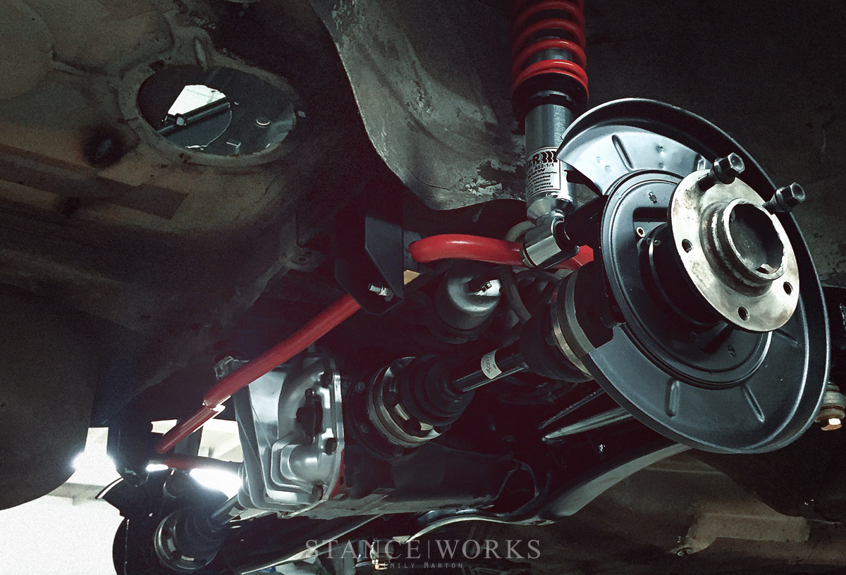

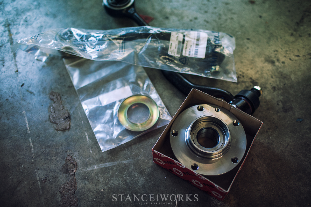

As the car underwent reassembly, I aimed to rebuild everything in its entirety as it went back on the car. For the rear end, this included parts like new rear shock mounts, new wheel bearings, new axles, new brakes, and dog bones. At the nose of the car, new control arms, sway bar links, bearings, hubs, tie rods, and more all brought the car back to new. Even small components like fresh bearing lock rings, dust shields, and collar nuts were fitted to the car. Best of all, the availability of OEM BMW parts meant that BimmerWorld was able to supply me with the best of the best. With the original components having suffered 30 years and 120,000 miles of unmaintained abuse, I’m confident the new stuff will last for quite some time to come.

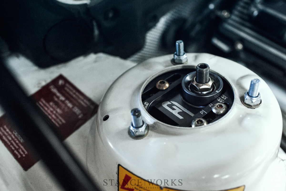

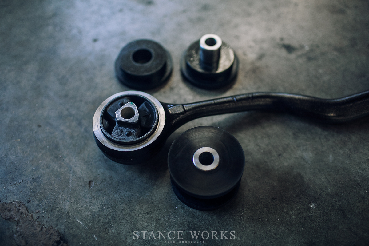

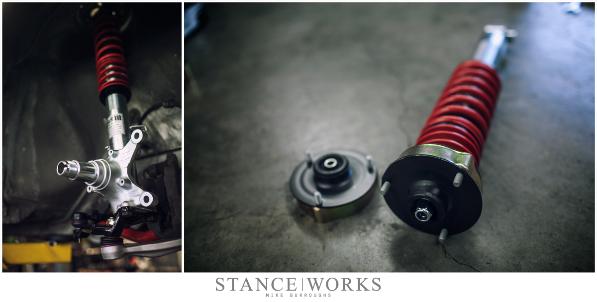

When it came to upping performance, BimmerWorld was able to shine – As a retailer for an incredible number of high-performance brands, as well as a huge number of parts of their own, the E28 was treated to some real treats. Powerflex race bushings were fitted to every component under the car – control arms, subframes, sway bar mounts, and more – and perched atop the H&R coilovers is a set of Ground Control race-spec camber plates, allowing for fine adjustment of the sedan’s alignment. I aimed to keep the car’s driveline close to factory-spec following the engine rebuild, but BimmerWorld sourced the car a JB Racing 11-pound flywheel and 6-puck clutch, giving a bit of freedom and “oomph” to the S38B35 powerplant. Urethane mounts support the engine, and a 16″ Spal Fan was paired with the large aluminum CSF radiator at the very nose of the car, all available from BimmerWorld for cars headed to the track.
