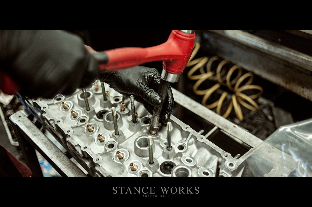

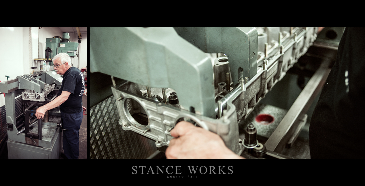

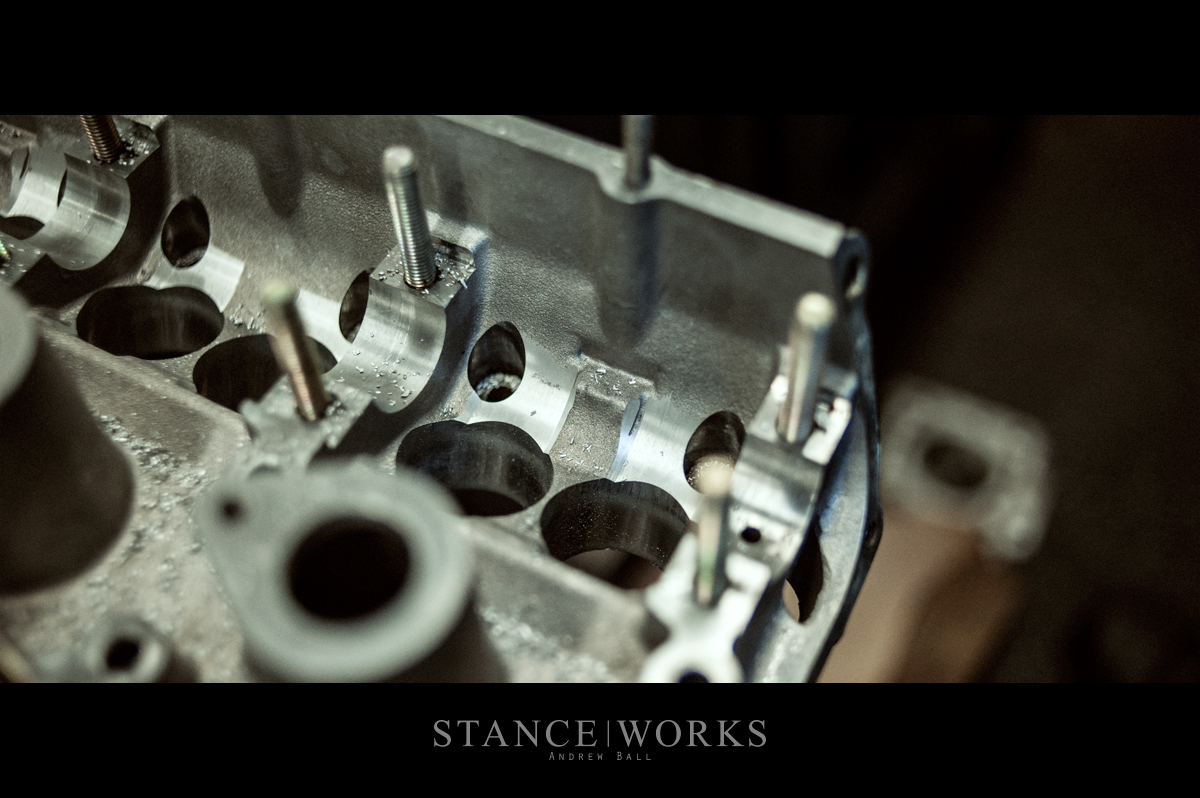

With cleanup out of the way, the team moved towards headwork. After testing for trueness, machine work began, starting with clearancing the intermediate head for the massive 299/294 Cat Cams that will eventually be installed. On the head itself, high-performance valve guides were fitted, along with balanced and blueprinted lightweight stainless valves, dual valve springs, and titanium valve retainers. Solid lifters, adjustable cam gears, and more, all help to pull every ounce of performance from BMW’s head design, and together, the setup allows for burst-revving up to 12,000RPM, adding a degree of safety against mechanical over-revving.

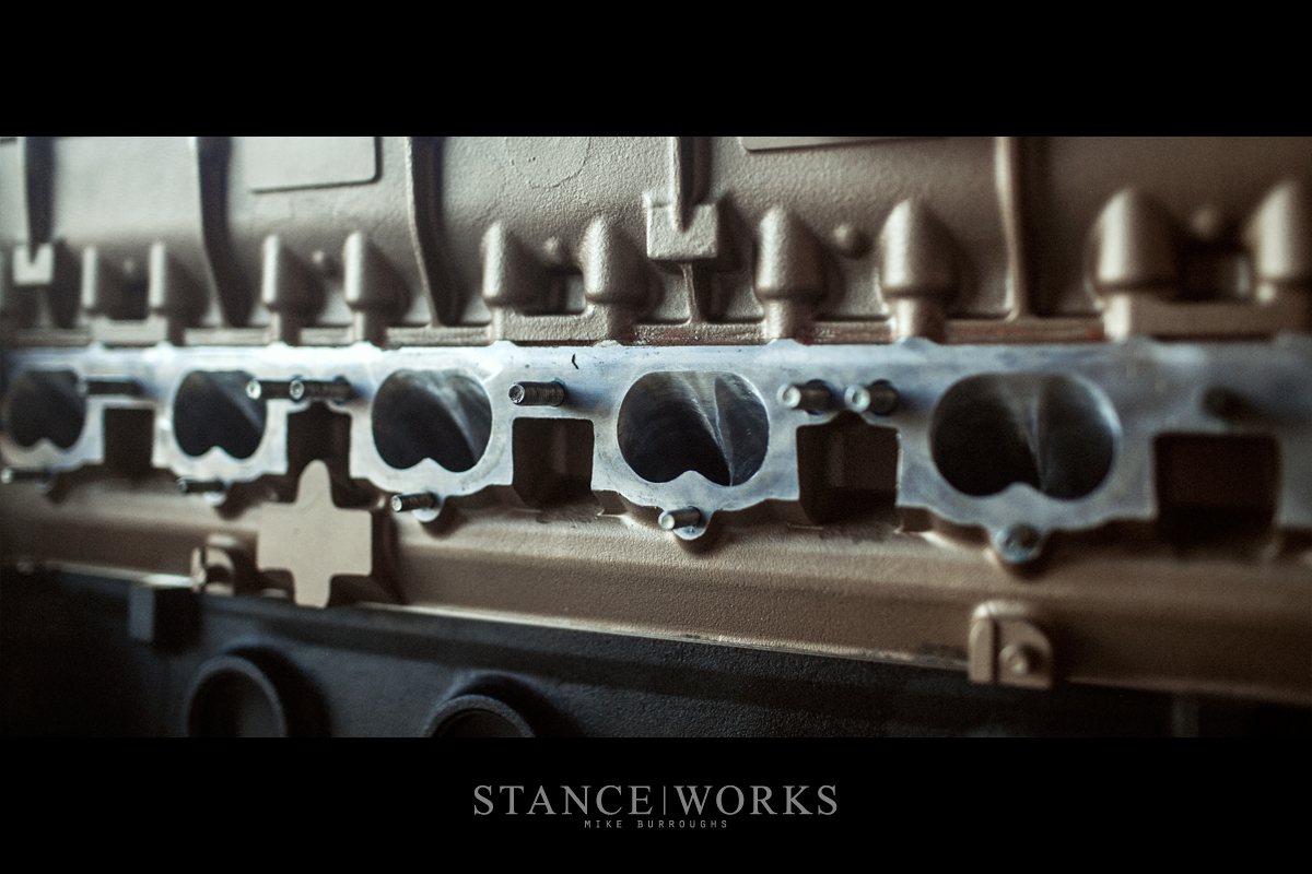

Fancy parts make for a fancy motor, but it’s VAC’s headwork that will really make the S38 sing. Armed with a flow bench and the knowledge to push the S38 head to its limit, meticulous but extreme port and polish work was performed. The valves were unshrouded, and VAC Motorsport’s top-performance level valve job, including cutting a full radius for the exhaust seats, was performed. A final bit of cleanup, deburring, and resurfacing, all measured on the flowbench for maximum performance, had the head ready for its paint and final assembly.

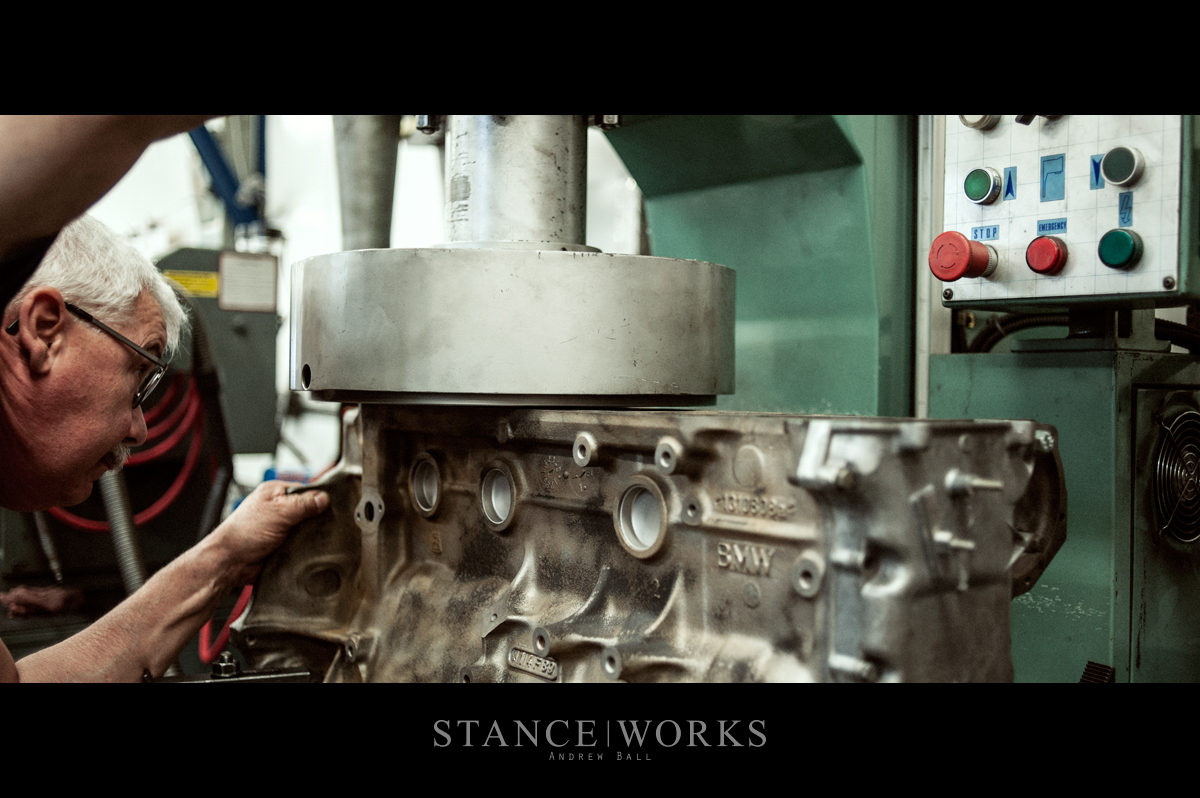

On the other side of the shop, the block received a similar treatment. With the surface decked and trued, the cylinders were bored, this time with a little extra room. Custom forged JE high-compression featherweight pistons are paired with forged 144mm connecting rods, helping to keep the rotating assembly both light and strong, and yields a compression ratio of 14:1. The two halves of the engine are sealed, of course, with an MLS headgasket, and ARP hardware, as found throughout the engine.

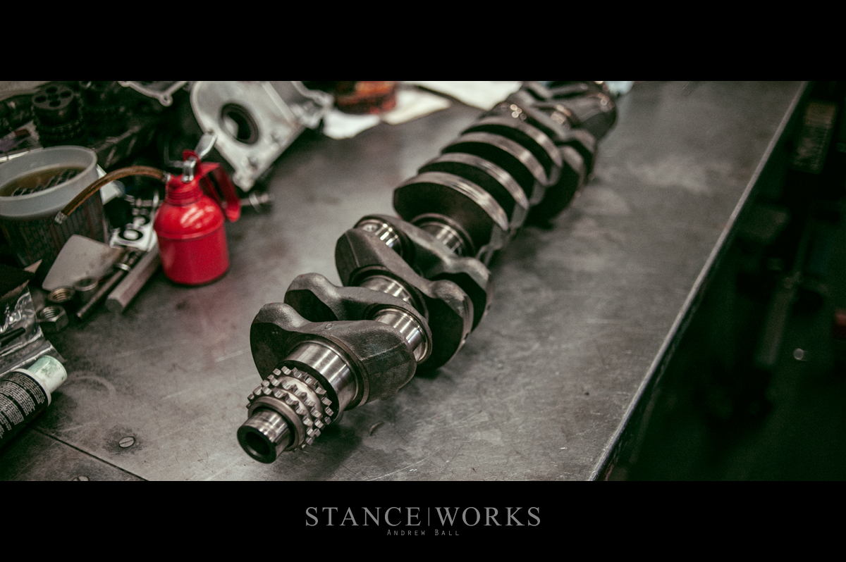

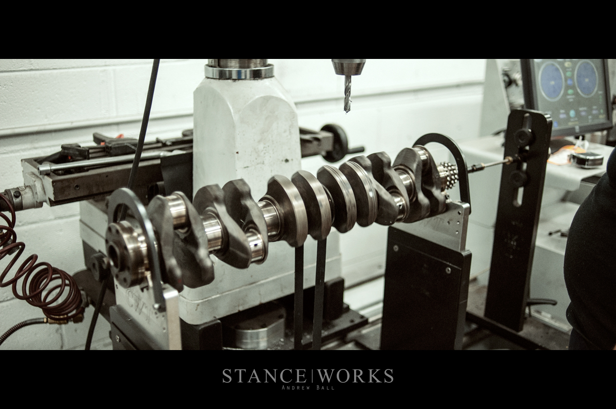

The only factory component that remains inside the engine is the crankshaft – but even it receives the VAC Motorsports treatment. Polishing, knife-edging, and balancing all help to allow the S38 to rev high and keep friction to a minimum.

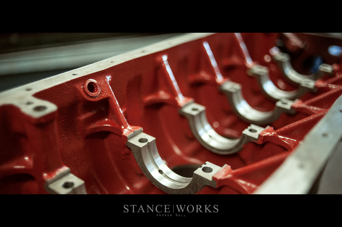

One of the final stages of assembly includes the finish work, which isn’t just limited to the outside. VAC Motorsports coats the inside of the block and its passageways with a special hydophobic paint, which helps to keep temps down, as well as oil and coolant flowing without restriction. After curing, and with the rotating assembly in place, the bottom of the block is capped with a custom aluminum dry-sump oil pan.
Behind the scenes, the engine was completely assembled and shipped to Southern California, where Rusty sat waiting for a new heart, but not before a bit of final paintwork. Initially, my request for gold and black was met with questionable looks and an “are you sure about that?” or two, but following completion, the team at VAC agrees it couldn’t have turned out better, and pulls its inspiration from the black-and-gold colorways of BMW’s race engines in the 1980s, such as the iconic M12.

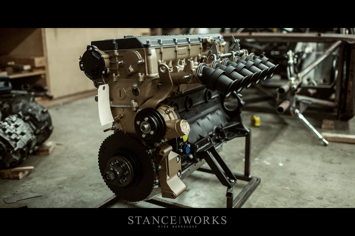

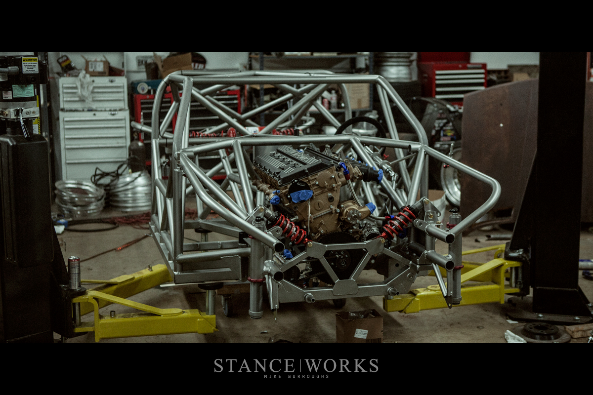

After a long wait, the engine was just about ready to be mounted into the tube chassis we had built, although a number of components had to be installed, fitted, and a few still made. We mounted the bored-out 48mm throttle bodies, as well as new velocity stacks, which made maximum use of the scaled-up intake ports on the head. On the flip side, our friend Robert Chavez of Shrobsbilt custom-fabbed a stainless header and exhaust, to make the most of the outbound flow. (You can see more of Robert’s talents and his work on the exhaust build in our feature by clicking here.)
There was, of course, plenty of plumbing, the dry sump system, and the engine electrics that needed installation and setup too, which took time to organize, mount, and set up correctly; however, the engine itself was delivered more or less ready to fire up. Finishing the car that surrounded it took many more months, but the end result was clearly worthwhile.
Below, Rusty’s engine sits in its final form, and has since been put to work turning over massive hoosiers and scrambling the car down back streets as we prepare it for its first track day. The engine itself is merely a shell of its previous form, retaining almost nothing from its original composition. VAC Motorsports has built a reputation upon quality, engineering, and of course, building truly spectacular engines, and Rusty’s S38B36  can stand with their best, and may just be the wildest they’ve built. With no holds barred and no penny spared, there was no better choice than to partner with VAC Motorsports to build the ultimate all-motor S38 for one truly ridiculous BMW.
