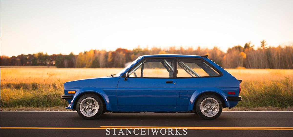

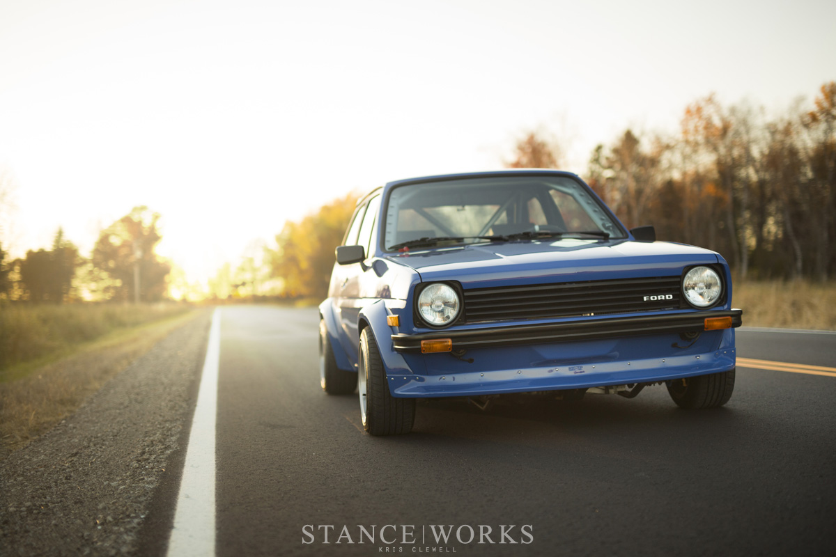

The cars had originally been a California cars, but were brought over to the north in the back of a pair of U-Haul trucks quite some time ago. The nearly rust-free baby blue rolling chassis cost Karl just $500. Karl recalls:  “So I bought the ’78 for the grassroots challenge. And I got it home, I start tearing it apart, and I’m like, this thing is too clean to cut up and make into a race car.” At that juncture, Karl decided to bail on the original plan and start building something a little more special. “At that point I was just going to put a Escort motor in it, a single overhead cam, 1.6, and just clean it up, make it nice.”
The car had the interior  painted, and was caged almost right away, but as with all of us, life got in the way. The car ended up tucked away while Karl was busy with his job, buying a house, and life in general. In the meantime, Karl had bought a much newer Focus SVT. Inspired by the drivetrain, he found a motor and transmission on ebay and bought it. Unfortunately the engine showed up in brutal condition. The bosses of the block were broken off at the mounts. Repairable, but once Karl looked into the trouble people were having with the 6 speed Getrag, the swap seemed less reasonable. He shelved the swap, eventually sold it,  and moved on. The spark to get back to work on his old Fiesta died once again.

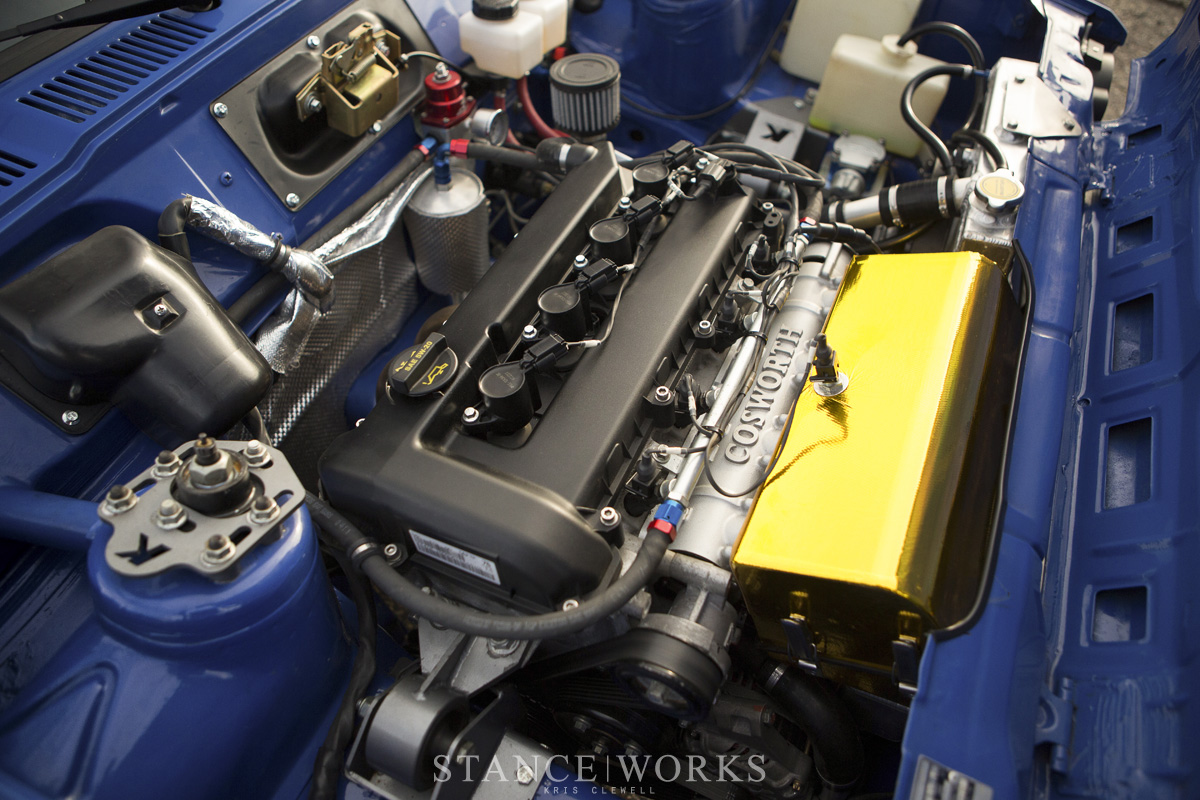

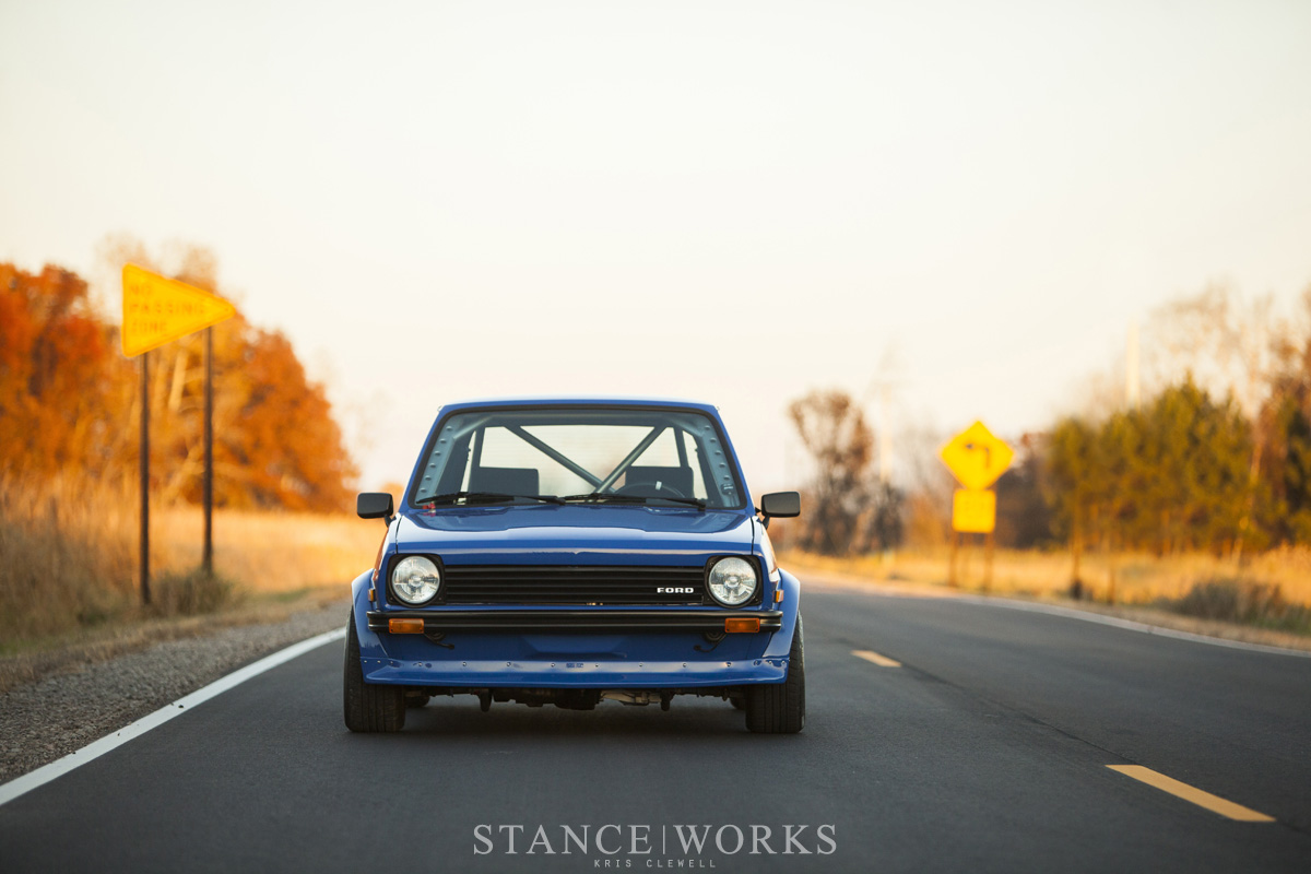

Karl eventually decided to go the Duratec route. He picked up a 2.0 from a 2008 Ford Focus. Not satisfied with a stock engine, he swapped out the cams, and built an airbox for the motor to house 100mm Cosworth individual throttle bodies. The entire motor is run with an MBE systems ECU. This turns a wheezing 130hp, into a 200hp monster. In an 1800lb car, the engine is a handful. Putting the power to the ground is a quaife limited slip equipped and built transmission from a 2008 Fiesta imported from Europe. Lucky for Karl, the transmission sits in just the right place, and the stock axles bolt right up. The frame rail on the transmission side needed some modification, and mounts needed to be built for the engine, but everything was pretty straight forward.
As a suspension designer for QA1, it was only natural Karl didn’t want to leave the stock suspension as-is. “Suspension-wise, the stock stuff is pretty horrible.” Karl mentioned. The stock setup is a standard Macpherson strut assembly in front, and a solid axle in the rear. When the car and suspension were being developed, Ford is known to have purchased cars from different manufacturers, and to have disassembled them. Being Fords first front wheel drive car, they needed input on engine and suspension design.  It was a risky venture, as Ford had no tooling or factories to build anything front wheel drive at the time.  It was a design by committee product and obviously was not going to live up to Karl’s standards, so he redesigned the entire suspension.

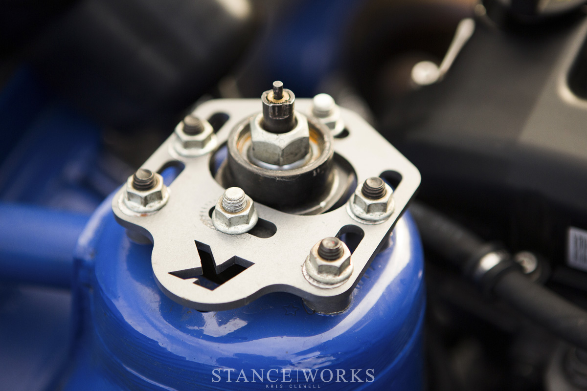

The front is now fully adjustable, and is built for the twisties with spherical bearings, QA1 coilover struts with titanium springs, custom built caster/camber plates, and the steering rack out of a Ford XR2. The rear is now an independent rear suspension. Aluminum trailing arms, custom sway bar,  and QA1 coilovers now replace the original design. The design was so good Karl was able to sell over 50 sets. There have been a few imitations of his design come along, but none of them have held water in comparison.

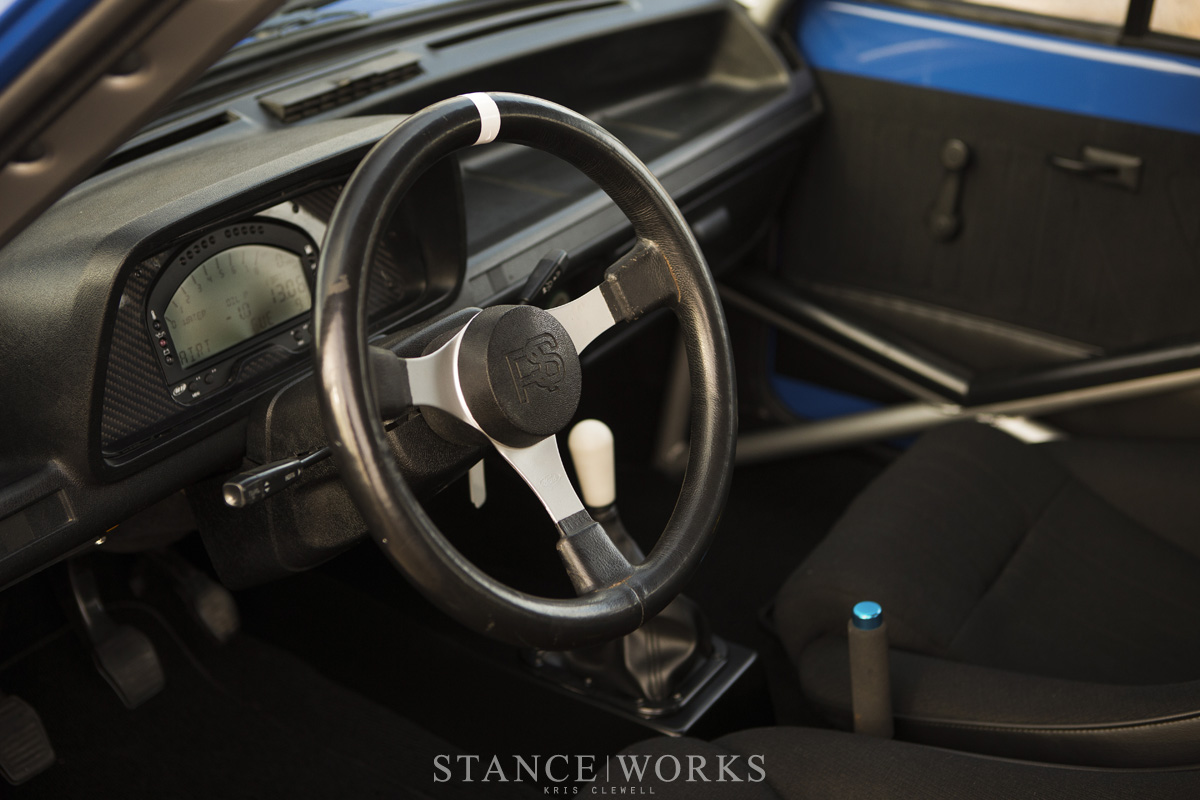

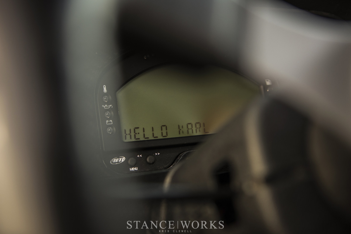

I had an opportunity to drive this car after Karl and I finished up the shoot. With roots in GTIs and MK1 Golfs, I welcomed the opportunity. Climbing in was tight. I felt like I was putting on a brand new shoe. It felt just right, and I knew once I started out, it would only get better with time. I was surrounded with RS badges inside and out, and in front of me was a digital display letting me know I was amongst the perfect mix of old school style with modern technology.

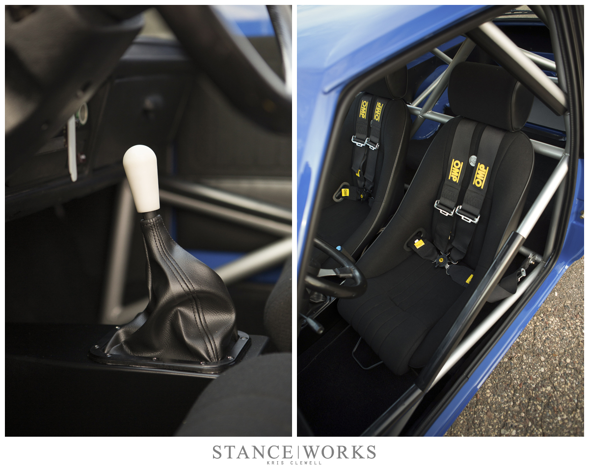

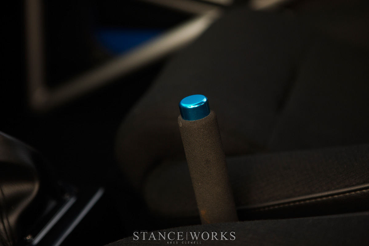

After startup, I made my way around the accoutrements of the interior. The derlin shifter felt comfortable in my hand as I tilted the shifter back and forth in the gates. I saw the manual e-brake lever, and knew I wasn’t going anywhere near it. The RS steering wheel was a good size. The pedals were in the right spots. I started the car. The digital display jumped, and the motor came to life on it’s stiff mounts. Pulling away the car felt immediately nimble. Under power I could feel the diff fighting for purchase even on the smooth tarmac. The throttle bodies sang loudly about all the power they were making. The gearbox shifted smooth, and rowing through the gears felt natural and intuitive. My senses were pleased, and I left the experience with a smile. I talked to Karl about the overall experience with the car. ““When I knew it was a rust-free one, I knew I wanted to build it into the nicest one.” I think he succeeded.
