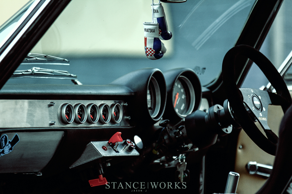

Within hours of purchasing the car, Jason had the build underway, and a slew of factory Alfa Romeo parts, including the original engine, hit the used market.  A suitable SR20 was sourced and lowered into the engine bay, and custom mounts were fabricated to mate the beast with its heart. The firewall and trans tunnel were cut out and rebuilt to make room, and the engine was moved back substantially from its original position, offering a better distribution of weight and allowing ample space for the required intercooler setup.

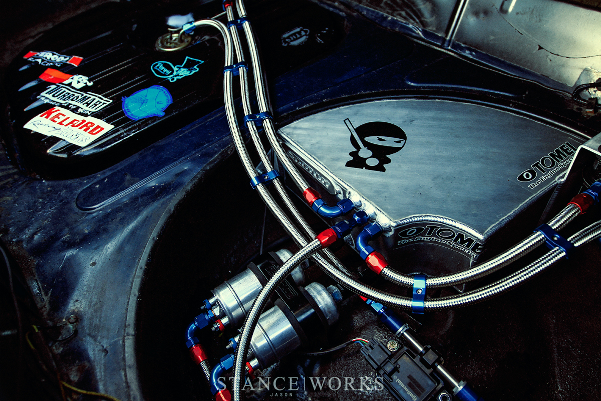

The engine itself was cracked open and fitted with rocker lockers, mild cams, and adjustable cam gears, giving the engine’s top end a mild bump, but it’s all that was needed. A custom exhaust manifold was fabricated to move the turbocharger forward, making room for the dump pipe within the Alfa’s petite engine bay. Plenty of details further hint at the car’s manner; a number of AN fittings and braided lines run throughout the engine bay, and even make an appearance at the nose of the car for the oil cooler. Underneath, a 3″ stainless exhaust pipes out the hot air, and at the tail of the car, a custom surge tank and Link computer help keep the 85% ethanol fuel mixture flowing.
Jason’s extensive modifications and the foreign heart were in lieu of his promises to the car’s original owner. “The owner was passionate about keeping things period with the car.  I had to keep my mouth stitched well shut about my future plans, lest I offend.  I knew my plans wouldn’t find too many ears keen to know about my build,” Jason says. He had the man thoroughly convinced that his GTV was in a purist’s hands, but it couldn’t have been further from the truth.
To be fair, the previous owner may have approved of some changes, such as the suspension, for example. For the car’s running gear, Jason turned to Alfaholics, whom he insists provide the best suspension solutions, bar none. GTA-R spec suspension was fitted to the chassis, and for stopping power, GTA-R 6-pot billet calipers paired with big discs, braided lines, and an adjustable balance box were sourced.

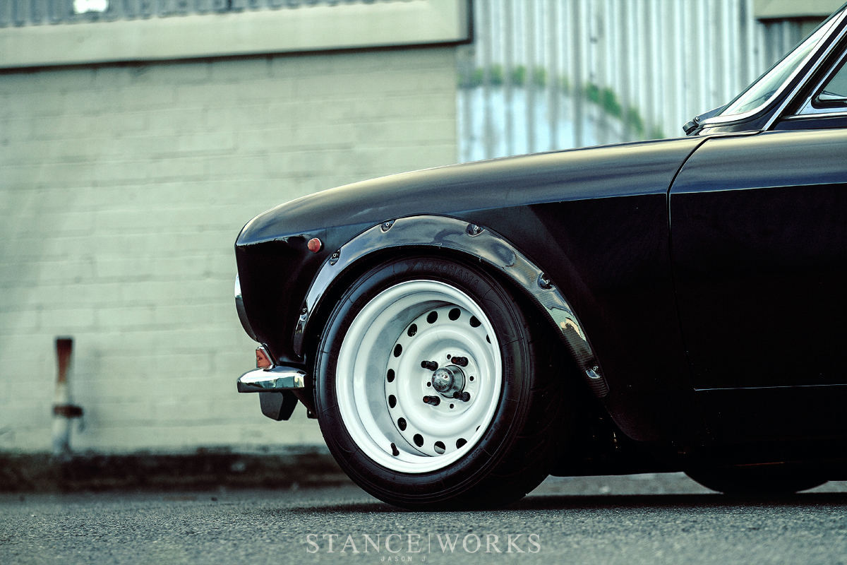

With Jason’s power figures, the 15×8 GTA replica wheels many Alfa owners seek out wouldn’t have been wide enough to keep contact with the tarmac. Instead, Jason searched near and far for a set of 15″ steel wheels with a “chaser” style pattern in the center and the elusive 4×108 bolt patter. Eventually, a set of Saab wheels fit his needs. The wheels were then welded into custom barrels, widening the fronts out to 15×9 and the rears out to an impressive 15×10 inches, enormous for such a tiny car.
To fit the wheels, Jason passed on the go-to GTA-M rivet-on arches, deeming them “played out” as well as unacceptable on a step-nose car. Although unbefitting to most, the obvious answer of classic 240Z flares was perfectly suited to the irreverent spirit of the build. Furthermore, the minor clearance added from the arches was all that was needed to fit the Yokohama semi-slicks.
