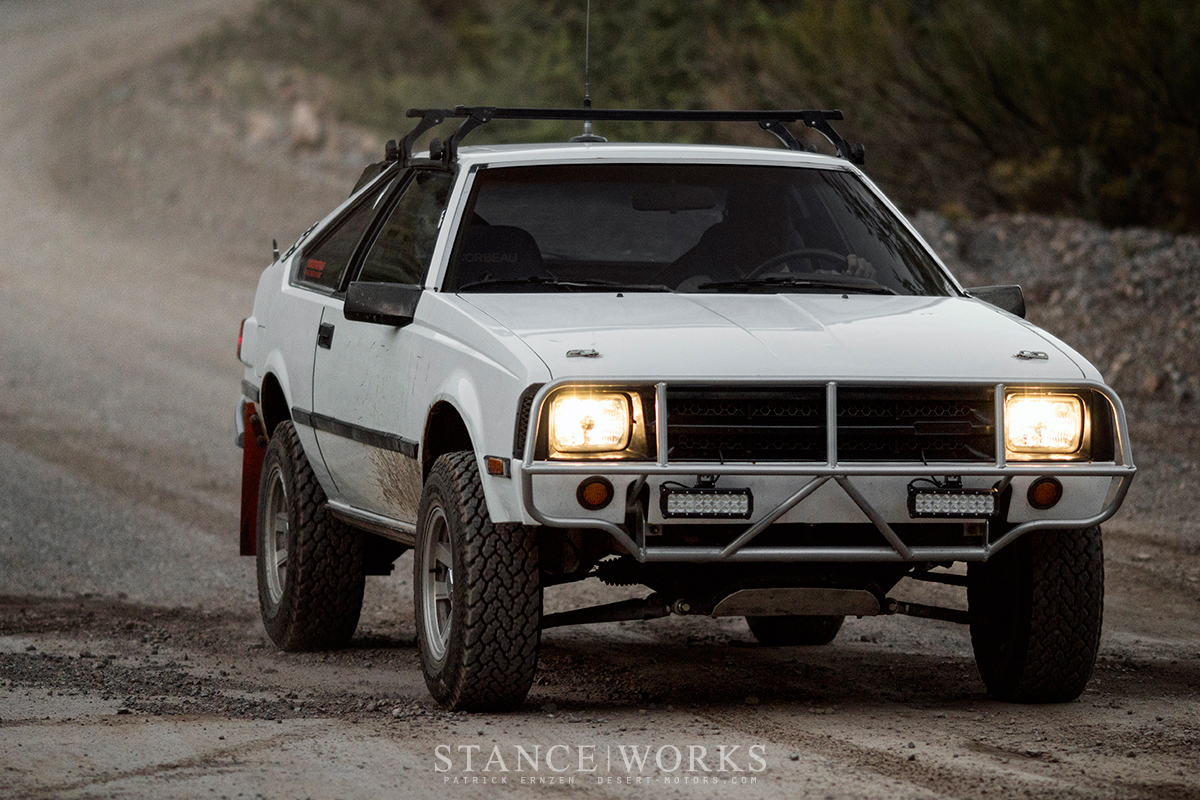

Eventually, Jon moved on once more, this time landing at the RA64 Toyota Celica, an obvious choice in his eyes. It began as Jon dreaming up a project to kill off newly-found spare time, and between MotorStorm on the PS3, Mad Max Movies, and rally coverage both new and old, Jon was desiring something rather "atypical". Among his ideal options were the Nissan 200SX, the Ford Mustang II, and the Mazda RX2 or RX3; however, at the top of the list was either the Cosworth Escort, and the RA64, which had captured Jon's interest thanks to its Group B Safari configuration that had raced in the early '80s. With the Celica so high on the list, and still easy to find at the time in 2009, Jon searched far and wide for the right car, eventually landing on a $400 rust-free example that "only needed a fuel pump"
In the end, the Celica needed more than just a fuel pump; a full 1/4" of crankshaft play was reason enough for fresh engine. Jon built a replacement 22RE to stock spec, with the only change being an OEM-style K&N air filter. Reliability is paramount in the sport of rallying, and while power plays a crucial role, Jon sought to focus on other aspects of the car to maximize performance, namely the suspension. "Where to start?..," Jon jests, hinting that little remains in the way of factory components.

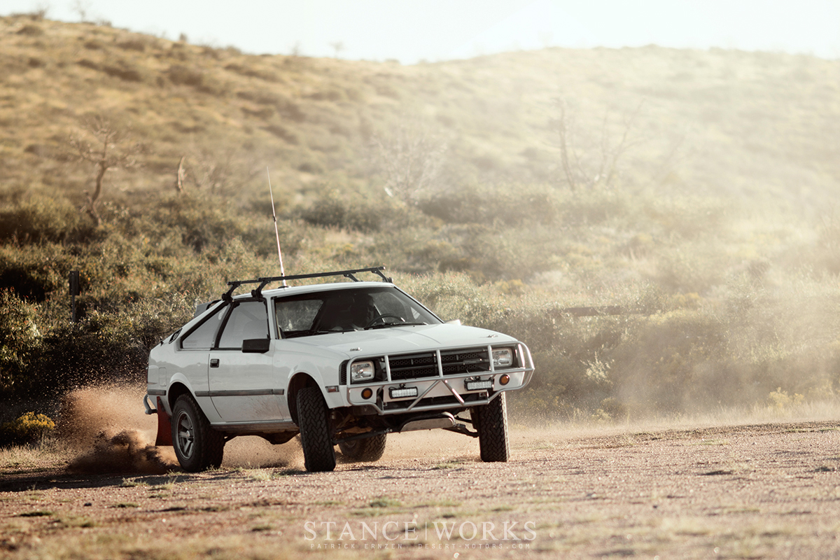

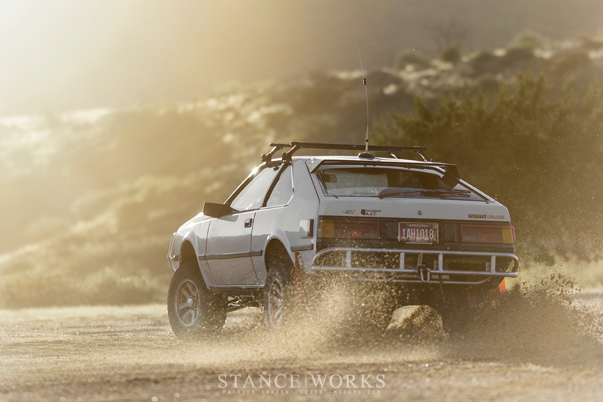

Under the back of the car, the factory axle has been swapped out for a 7.5" axle from a mid-'80s Toyota van, used primarily for its width and matching lug pattern. A Supra LSD was installed, and a rebuild kit that doubled the lockup force brought the package up to snuff. The axle is attached with a modified upper 4-link system, accommodating nearly double the factory suspension travel. The rear shocks, Fox 10" remote-reservoir offroad race units, tie in to the custom cage, built by Jon himself. 15" long race springs perch the rear of the hatchback high above the 27" tires, giving the car ample ability to clear most obstacles rallying may throw its way.
Under the front end, things get even more custom. Bilstein 30mm inverted mono-tube race struts, originally run in the TRD Camry road race car, have been fitted, combined with 2" strut-top spacers. The front subframe was dropped 3", and tucked in 3" on each side for mounting, allowing for custom 3" longer a-arms. The tie rods were relocated to above the steering arms, and double-shear mounts were made for the heim joint outer ends. Lastly, dual-rate coilover springs were fitted, lifting the front to match the rear. Furthermore, the chassis itself has been modified; slotting in the floor where the rear seats used to be allows for adjustable 4-link mounts, tied to the cage, for the rear end.

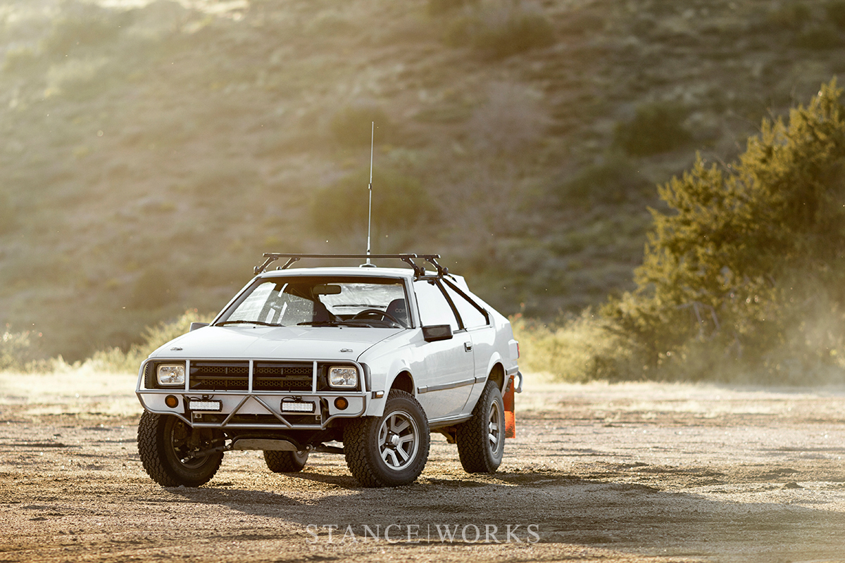

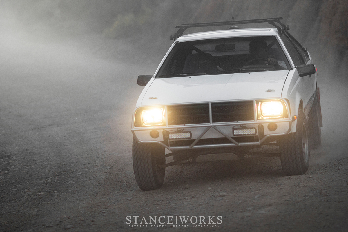

The exterior of the car has been executed perfectly, oozing style from every angle while embracing the entirely functional aspect of the build. The most obvious change to the car is the lack of pop-up headlamps; the 3rd generation Celica was originally equipped with pop-up units, as well as bumpers that jutted obtrusively from both the front and rear of the car. The front end conversion was an important factor for Jon in making the car unique, as well as harking to the Group B counterpart he is so inspired by. The swap took several years of research, skill, and a bit of luck. After removing the factory front and, a Mazda truck grille was chopped up and fitted. Custom cornerlight caps blend the grille into the fenders, and a custom-made valence was fabricated from scratch to polish out the front end, giving his Celica a one-of-a-kind face that brings the rally aesthetic in full force. Tubular bumpers, front and rear, are pulled from different racing disciplines: Safari Group B at the nose, and off-road double-tube style out back, with a 2" receiver hitch for towing when needed.

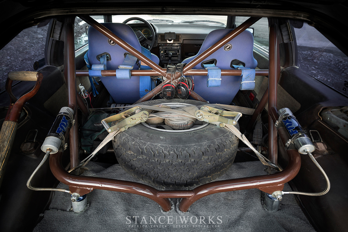

The last details fall inside the car. A pair of blue Corbeau seats keep Jon planted while the back end slides through loose dirt and gravel, and five-point harnesses lock him in place for safety. The rear seat has been removed to make room for the cage, and in the back, a full-size spare is mounted, as well as a shovel and tools, in case the need arises. Lastly, the factory radio has been replaced with a dual-band HAM radio for use while working rallies, which the car does often. The car is primarily used as a Lead Car or Course Closing Car, both of which are vital in operating successful events. In comparison to most club-level racers, Jon says the car runs mid-pack: fast enough to open a stage, and fast enough to chase down the back car to ensure everyone gets through the stage safely. "It can be important to get someone to the scene of an accident, or give a car a quick tug out of a soft spot they've gotten stuck in," and it's with that mindset that the car has been built, following Jon's roots as a crewman and his inherent desire to help others race.
