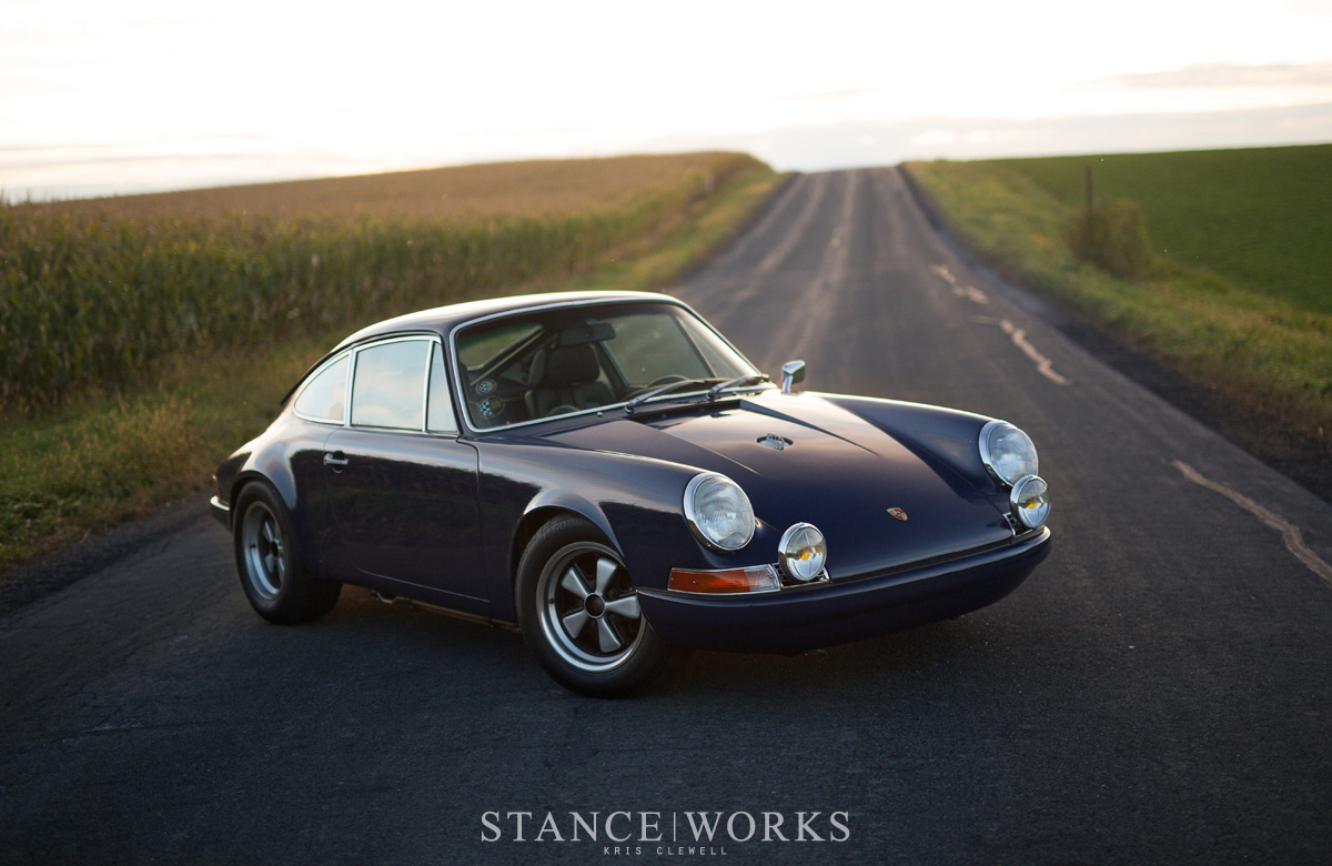

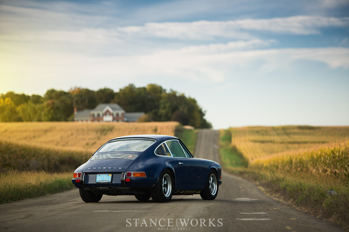

The car came from Jupiter, Florida, a suburb of Miami. It was on the early 911S registry and fit the bill for exactly what Bobby was looking for. “The car had an 8.5:1 3-liter in it that was fine but really, it was a little bit of a dog. The paint was good from 20 feet but it was cracked in the paint on the roof.” What hid under the patina was a fairly solid chassis, which is just what Mark at Accumoto needed to work his magic, though Bobby admits: “ Like anything else, it was a little bit more innocent to begin with, but the slippery slope…..” Decisions arose such as to take the car from a narrow bodied, slab-sided car, to a wider flared car. It’s difficult to take a 911 and spin a unique thread into it, without stepping too far out of the box. With such an iconic shape, its easy to go too far, and be shunned by the purists and the restomod crowd.

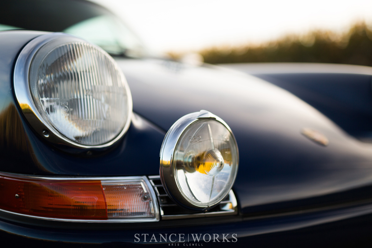

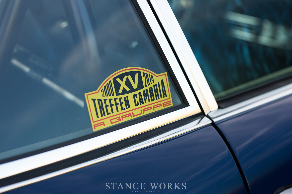

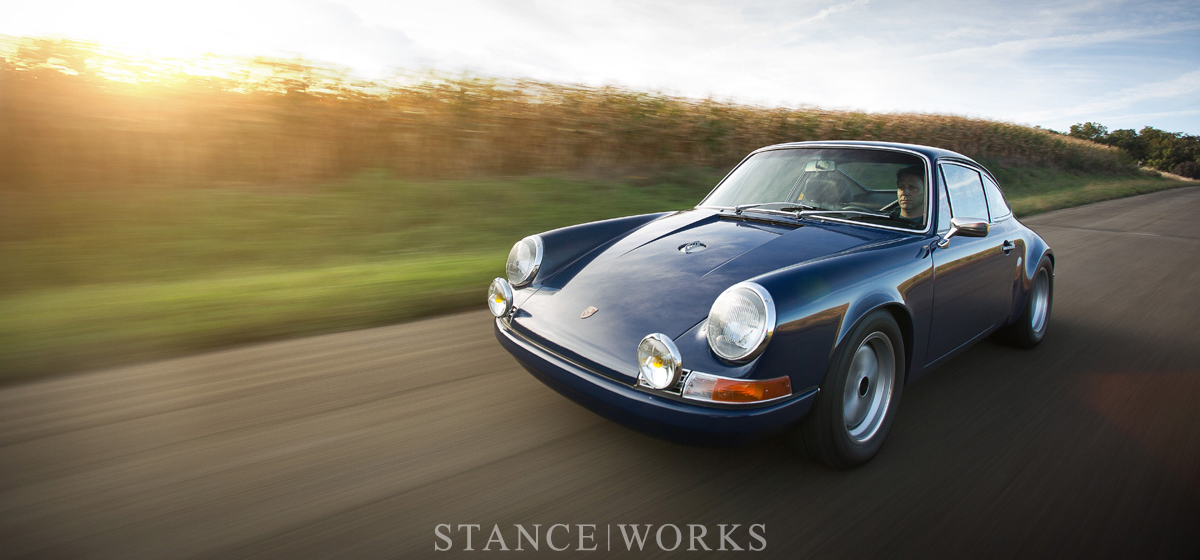

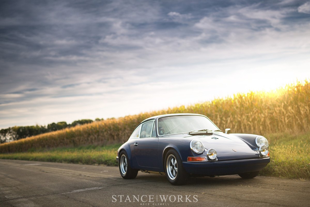

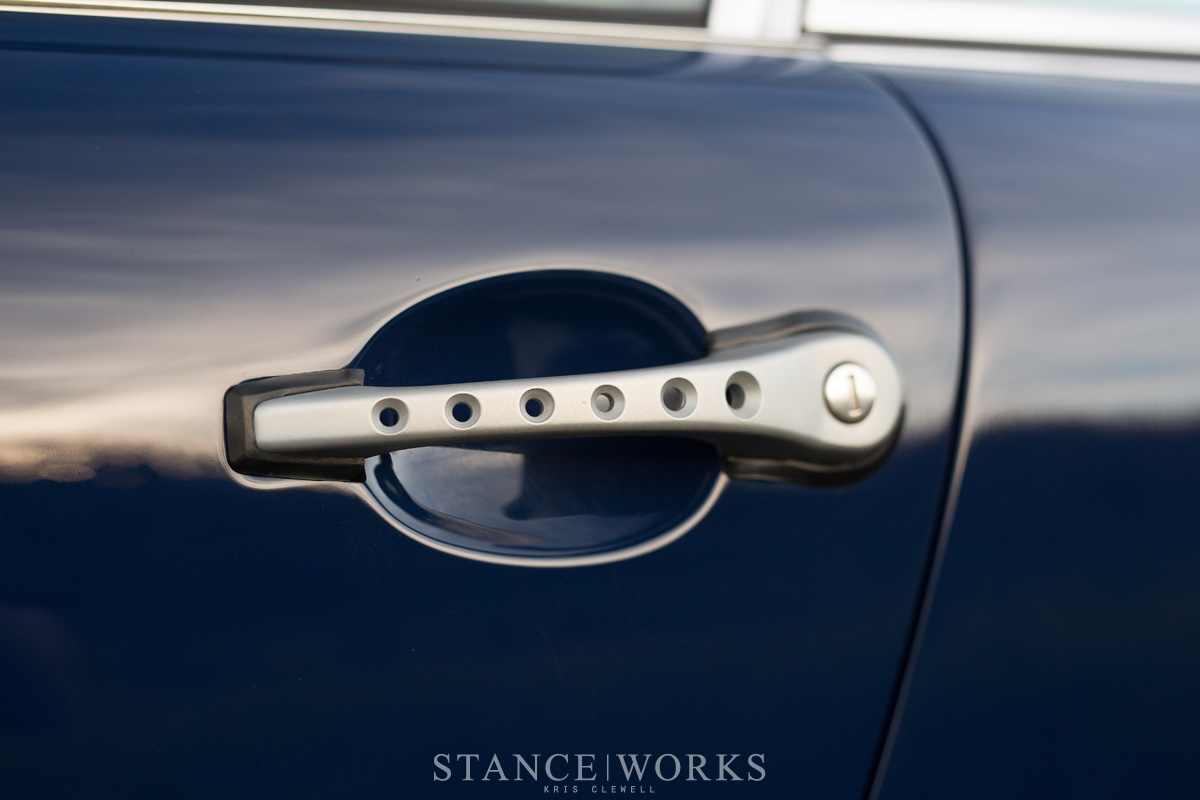

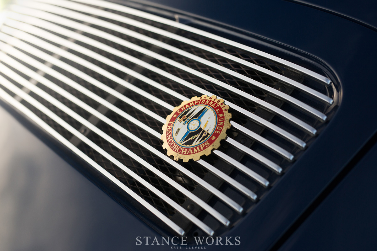

Small details surround the exterior to give a unique identity. From a distance, the rare Marchal fog lights give an instant peek into what is a list of tastefully implemented bits. Period correct stickers, the 24 hour badge sit that on the glass, and the rear deck lid. all fit well. Anodized door handles are drilled, an idea Mark had floating around in his mind long ago. The car looks fairly OEM+ at that first glance, but the center fill gas tank buttons up the hood, and hints at the more aggressive under pinnings.

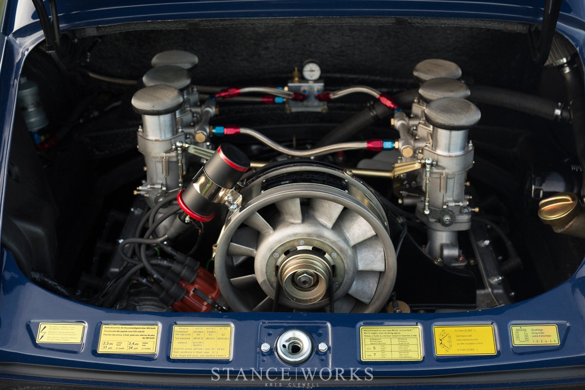

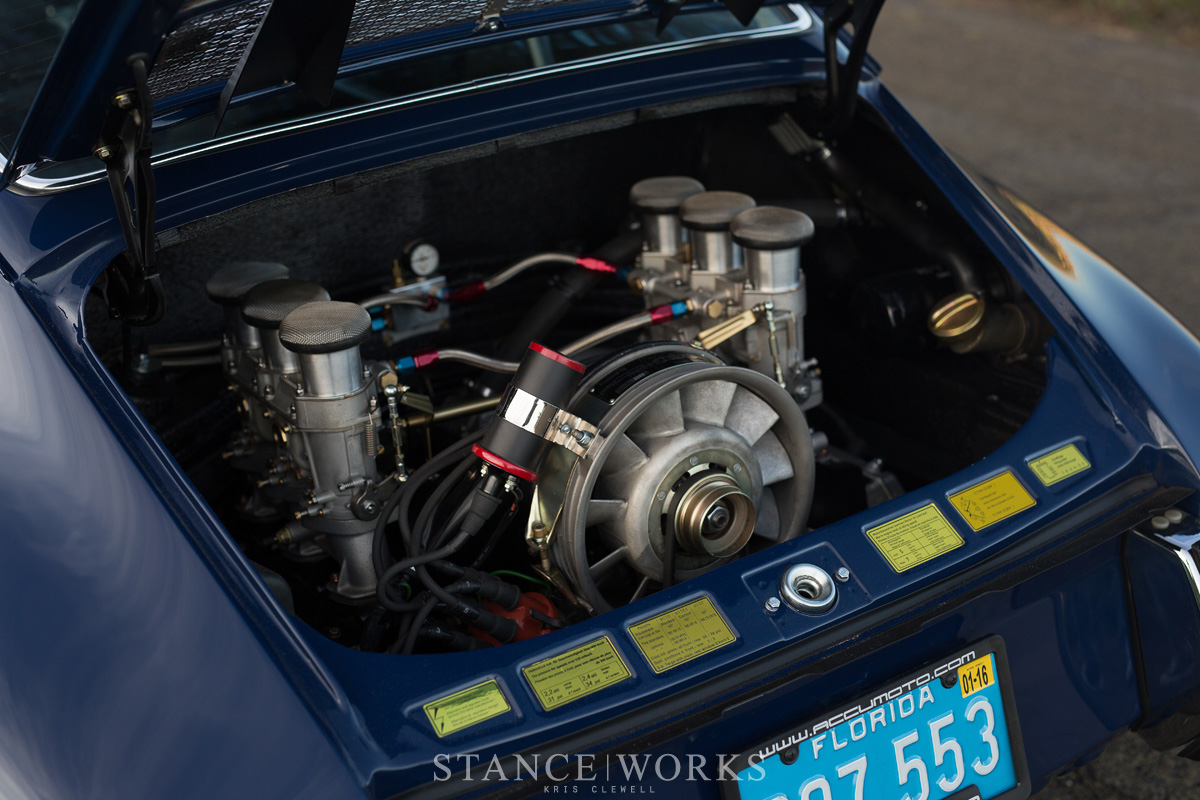

A stock 1971 911T would have had around 140hp. While the “slow cars driven fast” thing is a great rule, being underpowered is another story. Bobby and Mark decided to bump the 3.0 that was swapped into the car by the previous owner to a 3.2, and the short stroke 3.2 is widely agreed to be one of the best engine combinations for an old air cooled 911. The T’s engine is oversquare, and rev happy, pulling nicely to the redline. Helping a set of 46mm PMO downdraft carburetors breath is a set of polished and ported heads, and DC60 Cams. To help with the high RPM workout, the case is filled with high quality internals, including Pauter rods, and just outside it, JE 9.5:1 pistons. As written, Bobby did not go higher than 9.5:1 compression. The layout of the cylinder heads relative to the spark plug location, and the heat generated in an air-cooled engine limit compression. Since the shoot, the engine has been twin plugged, which allows for more timing, more compression, and then of course, more power.

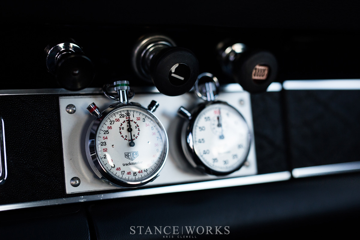

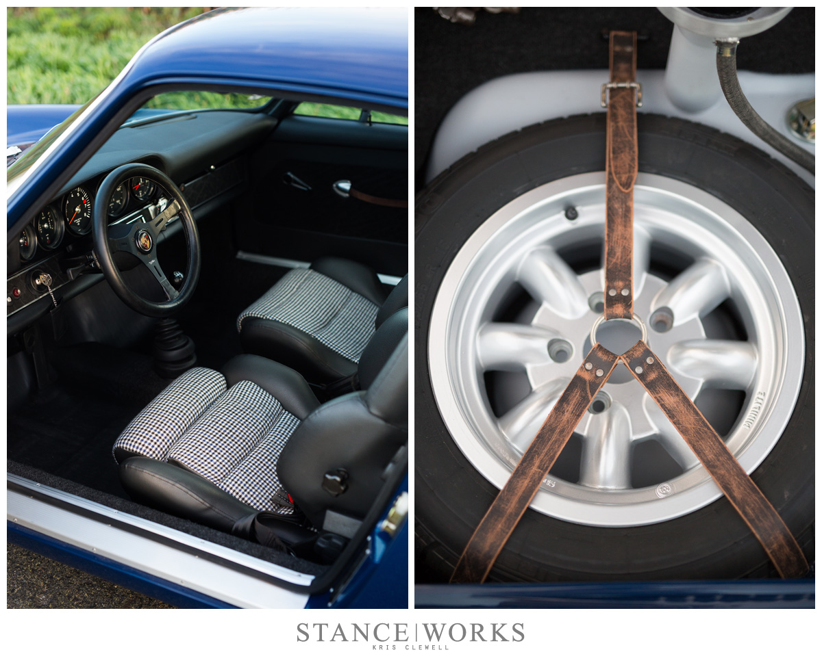

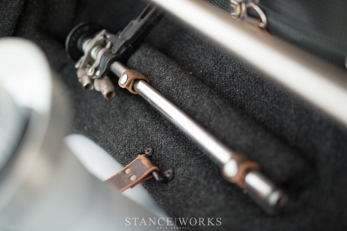

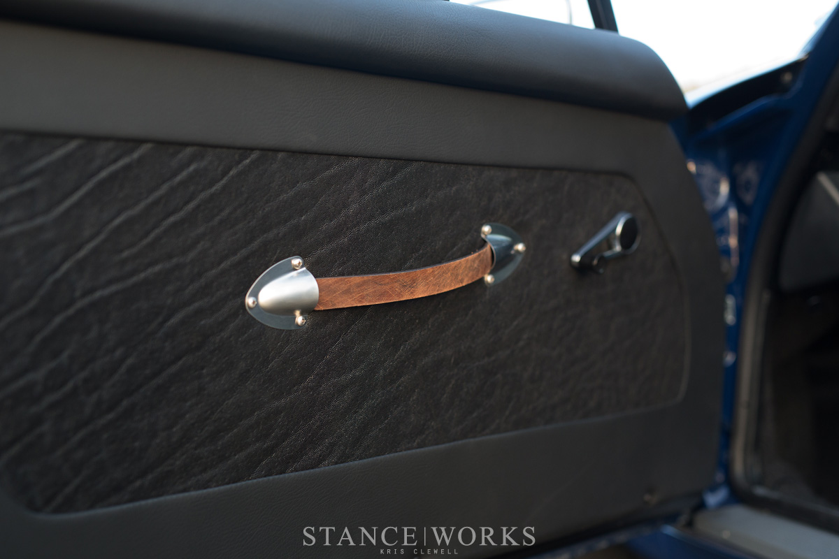

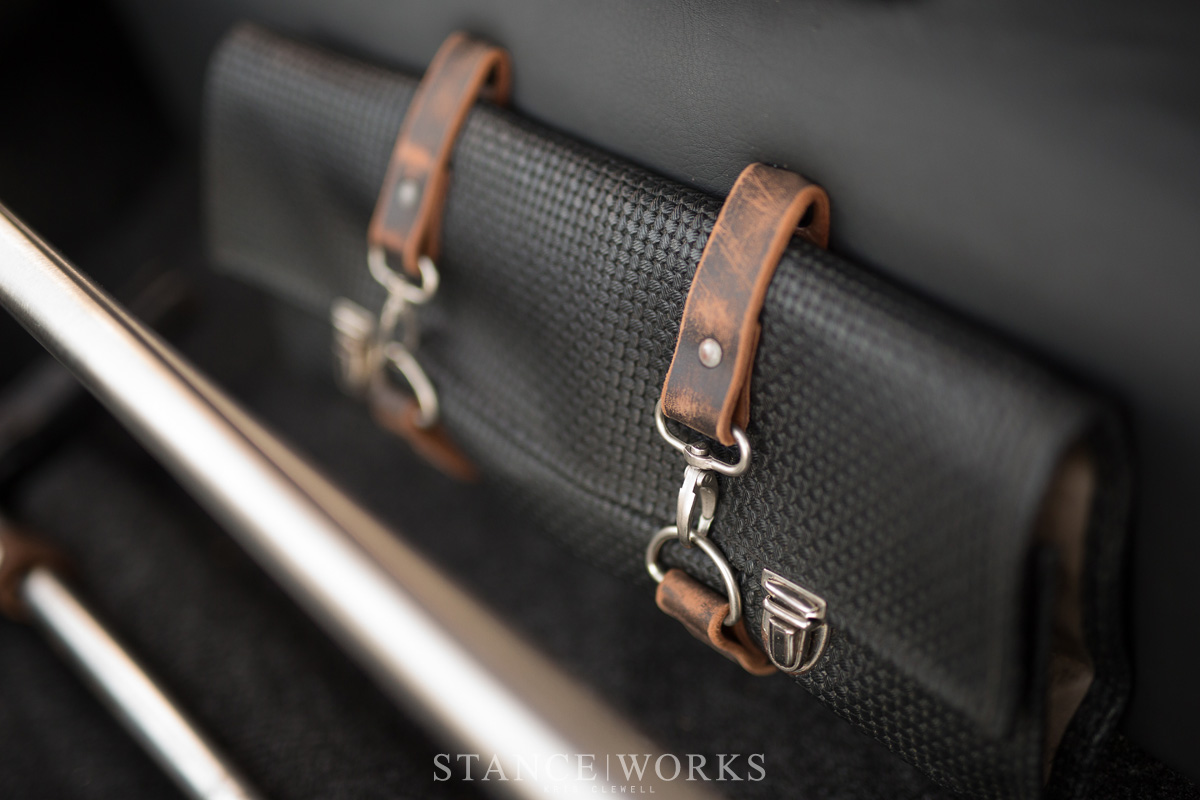

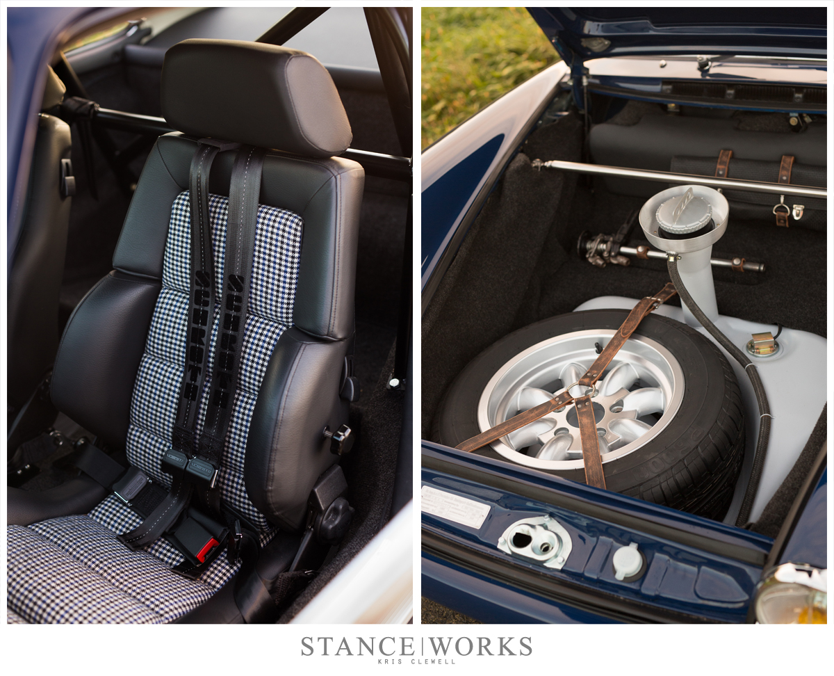

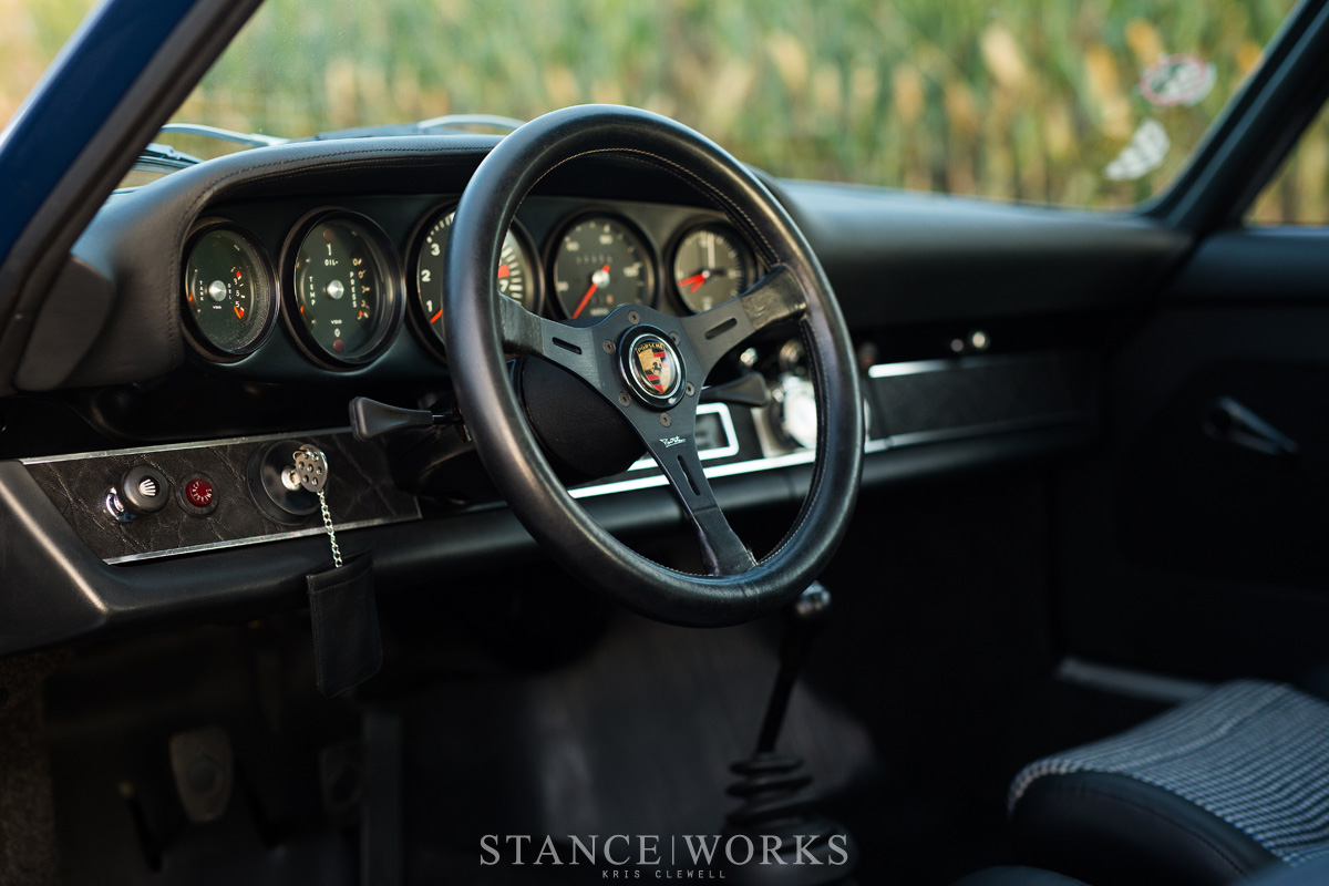

One of the only things not undecided when the car was built was the interior. It’s inspired by his father, whom had brain cancer. Right before he was diagnosed, he had been building a ‘32 ford. It’s color, prophetically, was a dark blue. Porsche’s interior, with its elephant leather, and houndstooth plaid inserts, was something his father would be proud of. The driving position is commandeered atop a set of Recaros. LSA for the driver, and LSB for the passenger. The feel of the road comes through the steering rack to a Ronnie Peterson Momo Signature wheel. Period correct Tag Heuer trackmaster rally timers replace the radio, something you definitely dont need in almost any air-cooled Porsche. Generally, if you want to see whether a car is built completely, and details minded, you look in the trunk. There, this 911 is nicely organized, and kept tidy by leather straps. The panasport spare harkens back to motorsport days. A front strut bar stabilizes what ties an old 911 to its roots. The original torsion bar suspension remains, and bolted to it, a classic set of 15×7 & 15×8 Fuchs with an RSR finish rounds out the exterior.
