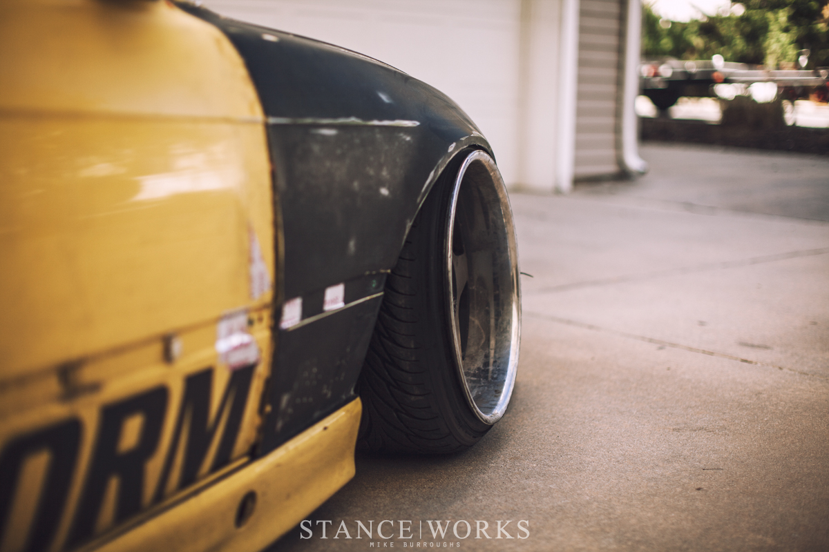

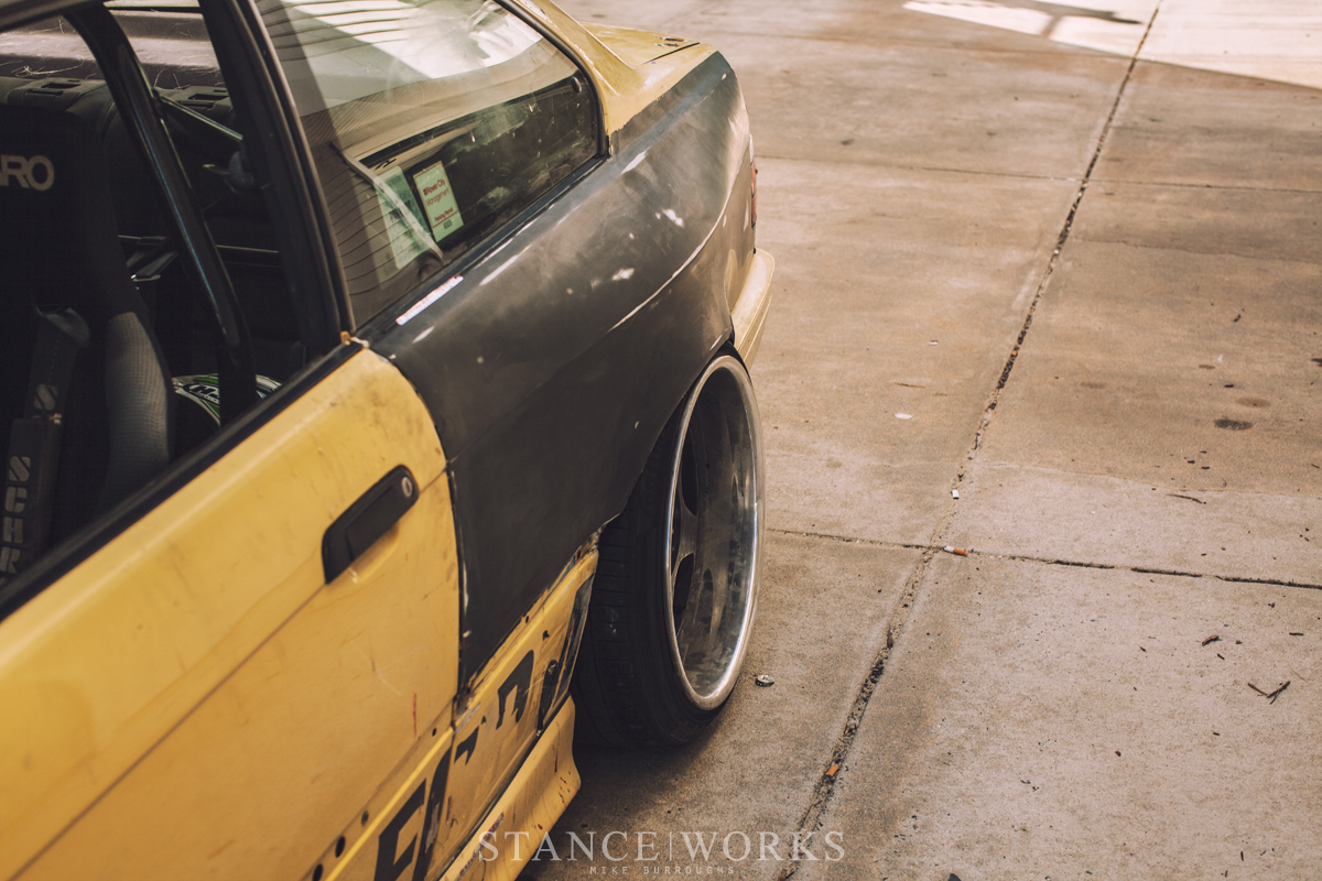

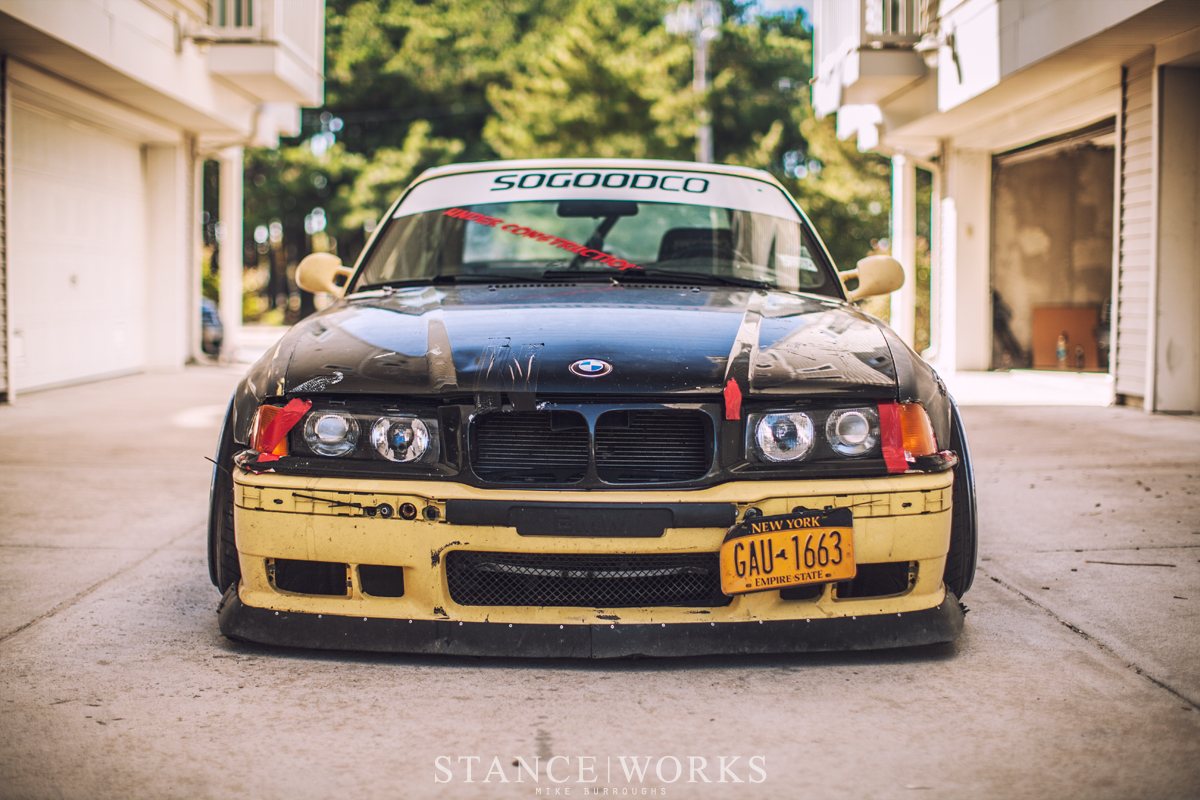

However, the imperfection Ollie touts is only skin-deep. Underneath has been a long-term goal of bringing a vision to fruition. The vision stemmed from a very simple desire: Ollie wanted a widebody kit for his car, but the simplicity of the desire was overshadowed by an insistence that form didn’t have to follow function. “In my opinion, every available option for going wider kills the lines,” he said – lines which Ollie had grown far too fond of to heavily alter. “Even the rare ACS widebody waters down the sharp lines of the car. E30 M3 style box flares don’t translate to the E36 chassis. The inverted body line just doesn’t work for me even though it’s a beautiful thing on the E30 M3. I truly don’t like box fenders without any sort of flare to them on E36s, and grafted E46 flares are too bubbly.”
It’s immediately obvious that Ollie thoroughly considered all options, but it’s certainly understandable how he reached such a conclusion. What separates Ollie from most of us, however, is his reaction to such a predicament. Where most would admit defeat, and few would decide to fix the problem for themselves, Ollie took it one step further: in his mind, a plan flourished to fix the problem not only for himself, but for anyone who wanted in on the action. With no experience in fiberglass work, plug-making, or anything in between, Ollie set out to not only build overfenders for the car he had grown to love, he set out to make molds and to begin a company that could see his vision through, providing like-minded enthusiasts with the design he felt worthy.
Ollie began from the ground up, scouring the internet for information to get the ball rolling. Phone calls to businesses in the industry helped point him in the right direction, but it was trial and error that carved the path. As he tells it, there’s no one set way to create a “plug” – the original part which molds for future overfenders and arches are taken from. “ It’s a goal that can be reached in numerous ways, and finding the right one, one that fit within the budget and worked in unison with the project at hand, proved to be a challenge.  With an industry filled with a variety of products and materials that can be used to accomplish the job, Ollie quickly found that everyone seemed to be set in their ways, insisting their own method was the proper one. It was a long series of hurdles that made gaining headway an up-hill battle. “Research was difficult. I decided to just dive in and see what worked for me.”
The project began in his mother’s garage, which Ollie touts as more akin to a shed than anything else. Suspended tarps re-routed water that found its way in through the leaky roof, which as always absorbed into the gravel that made up the floor. The car stayed dry, but the workspace would become waterlogged any time inclement weather made an appearance. Nevertheless, Ollie made due, and began crafting the kit. “I made a few sets of flares before deciding to make the full quarter overfenders. By the time I started to make the fenders, I had a precise idea in my head.”
The first step in making the kit was to build a “skeleton” on the car to the proportions he desired, keeping both sides completely even, using plexi-glass cut-outs that were affixed to the E36’s factory sheet metal. Using a 2-part expanding foam, Ollie filled the gaps, which he shaved and sanded, adding foam and body filler as necessary to achieve the correct shape. His goal was straightforward: “I aimed to keep the same shape as the OEM arches to keep a very factory look.” The differences were twofold – more obviously, he wanted wider arches for the widebody looks and the performance he was after. On the other hand, he wanted to raise the arch height, known by most as “radiusing”, to allow for a larger wheel-and-tire diameter without a needed change in ride height. After perfecting the shape, which took more than a few revisions, he coated everything with fiberglass to create a solid, non-porous surface which he then smoothed out to a perfect finish using body filler, finishing putty, and a polishable polyester surface primer.

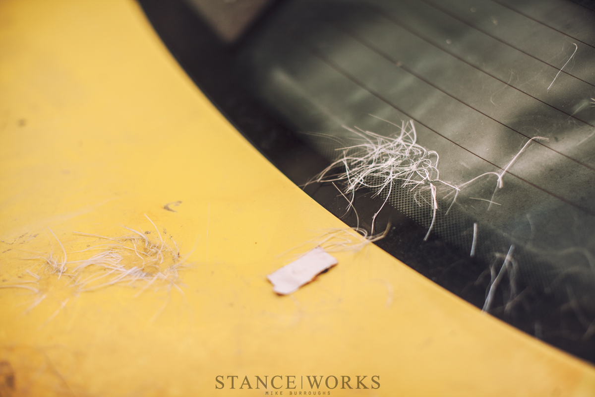

With that, creating the plugs was complete, and creating the molds began. Once Ollie had pulled a mold of each corner, he was finally able to start creating the final FRP (fiberglass reinforced plastic) overfenders, which mirrored the process of creating the molds themselves. “I’d lay down my exterior layer of gel coat, allowing it to tack up. That’s then followed with multiple layers of 1.5oz chopped strand mat fiberglass, reinforcements, and resin.”
The lack of insulation and HVAC in his mother’s garage meant that Ollie was stuck fighting with temperatures and a steep learning curve to figure out and perfect his process. “In the cold, it would take days for the resin to cure. Then in the summer time, the garage would heat up and make the resin and gel coat kick within minutes.” On more than one occasion, Ollie nearly called it quits when the gel-coat would “alligator,” a result of the gel-coat kicking too quickly and wrinkling. The effect was caused by more than just varying temps; sometimes, the application would be too thin, other times, it’d be the result of too much catalyst. He even found that the gel-coat reacted negatively with the primer he was using. Each error meant the laborious removal of the cured gel-coat from the panels, refinishing and smoothing, and starting once more. It was a trial-and-error fight that only the truly dedicated would persevere through.
