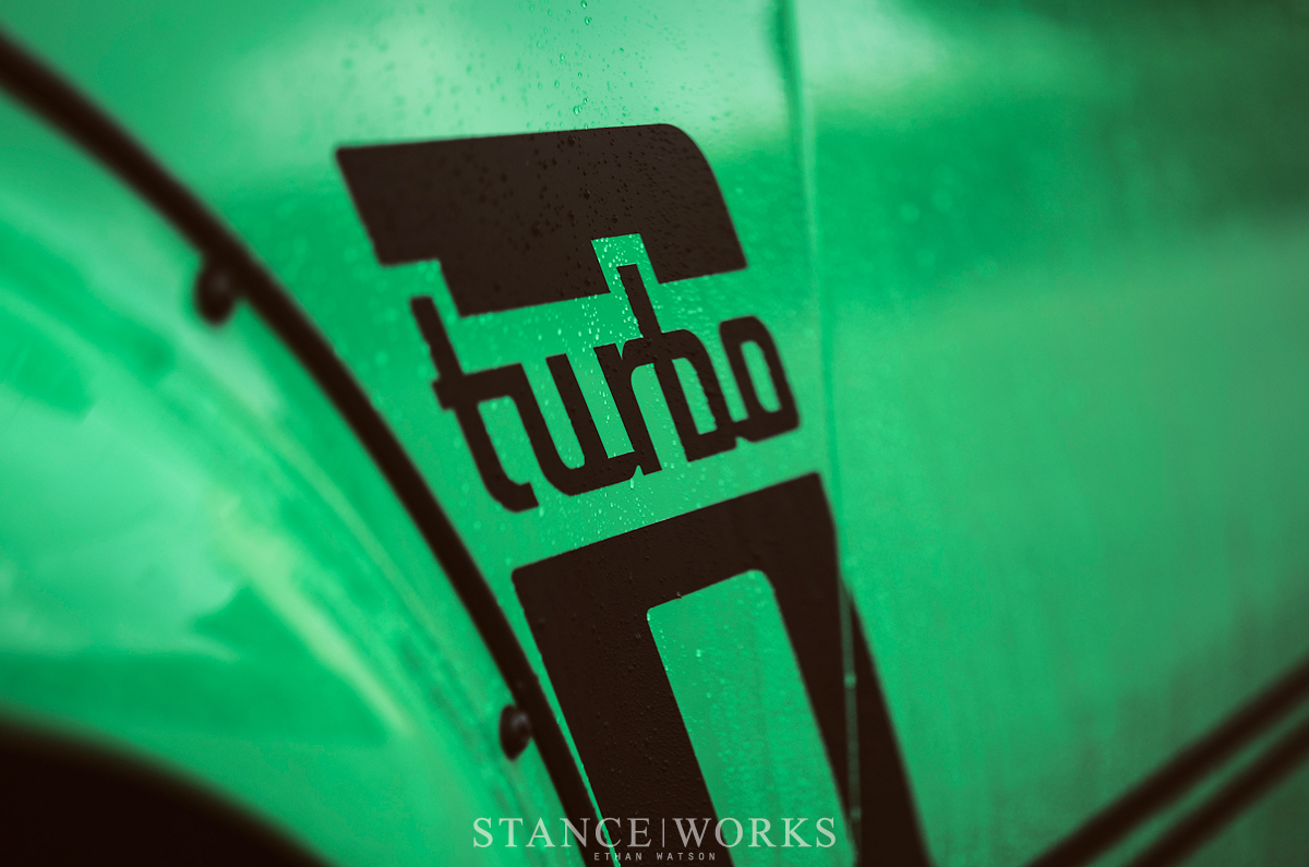

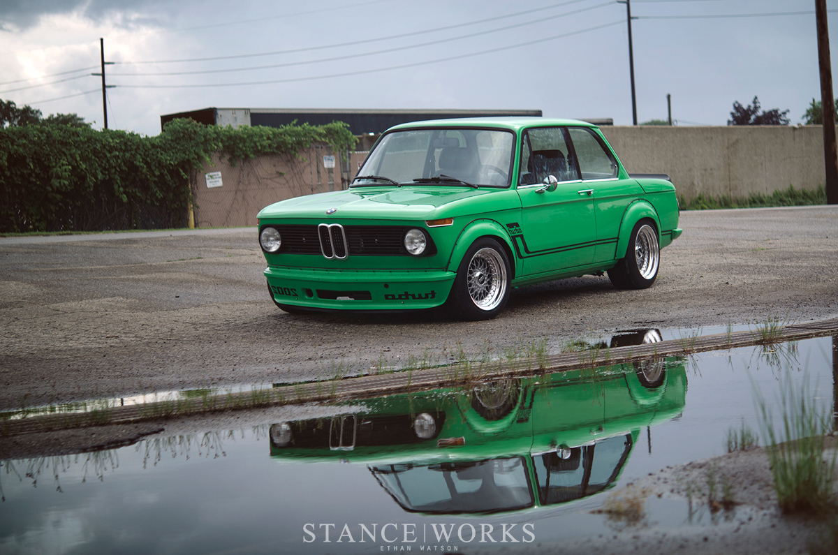

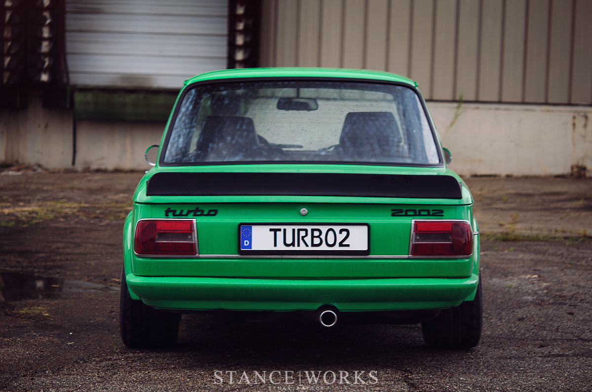

The essentials are all present: the hardware-attached classic “turbo” arches are perched atop the fenders, with the sides of the car accentuated by a mono-chromatic take on the Turbo’s classic striping. The front air dam hangs low, and the reversed “Turbo 2002” text is still in place to let the common man know what car is about to pass him from his rear-view mirror. Yet, more important than the essentials is the slew of details and mountain of effort Eric and his father have put into this car to make it their own.
It’s impossible to ignore, first and foremost, the electric color of choice. BMW originally only offered the 2002 Turbo in two colorways: Polaris Silver and Chamonix White; however, instead, Eric chose Porsche Signal Green, which seems to radiate from every panel – yet the quirky color fits in a way that harks to the technicolor brilliance and explosion of color during the ’60s and ’70s. The striking green ensnares the attention of any wandering eyes – at first I found myself wondering what kind of loud-mouth creation I was looking at – and before I knew it, I was in love with vibrant-yet-pastelish “deuce.”

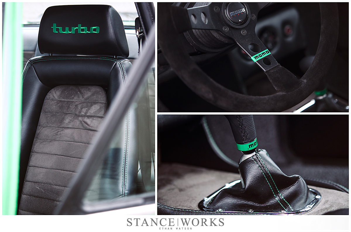

The energetic paint is hardly an afterthought. Inside, hints of matching pigment trace the interior that Eric had entirely redone. Embroidered in the headrests of the vintage Recaro Sports is the classic “turbo” badge from the tail of the car, stitched in a matching green. Tracing the edges of the leather is matching stitching, which follows the lines of the seat, and on to the leather-wrapped center console. The black-and-grey leather-and-suede theme of the seats matches the re-done door cards, creating a new and cohesive aesthetic throughout the inside of the cabin. Finishing details, such as an Signal Green Momo logo around the black suede steering wheel and shift knob, bring the interior and exterior together in a perfect modernization of the iconic ’02 Turbo.

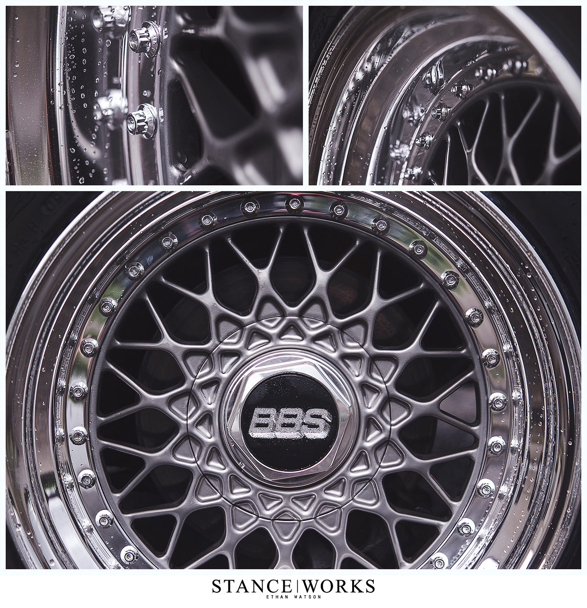

Hunkered under the arches is a rebuilt and refinished set of 15×8.5 and 15×9 BBS RSs, wrapped in 225/45/15 Hankook RS3 tires. Polished lips and centers that hint of Nagaro Silver fit perfectly and call to classic styling, keeping the vibrant nature of the surrounding panels in check. More important than the aesthetic, however, is how the sizable tires help complete the turbo package.

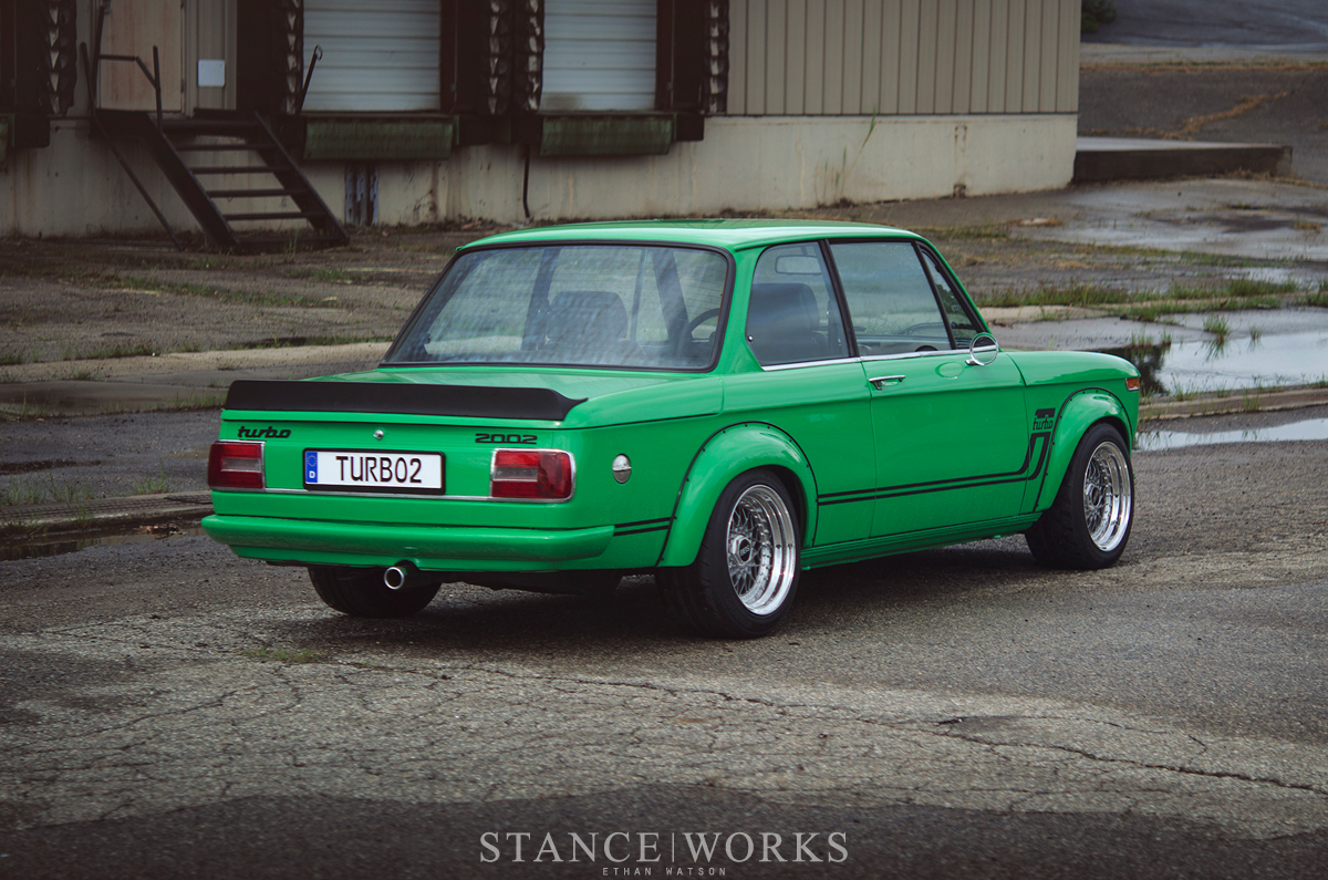

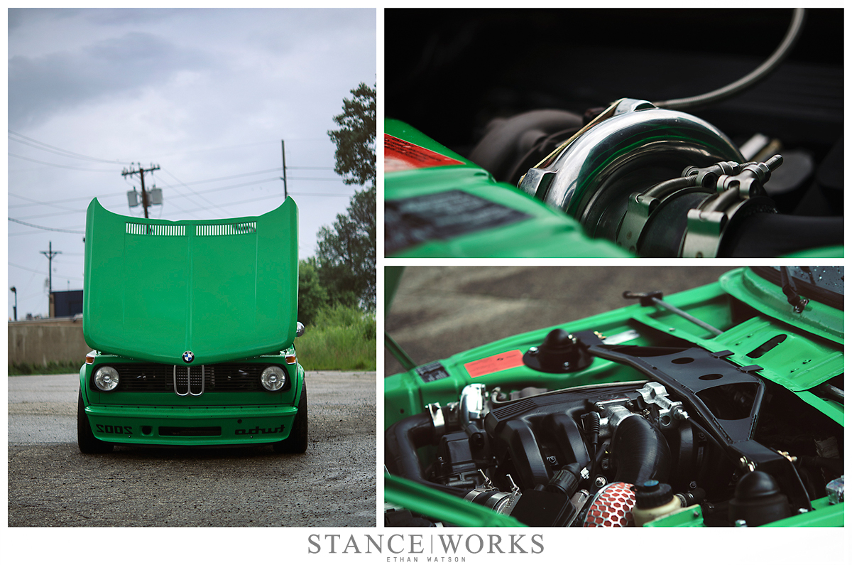

Embracing the idea of what made the 2002 Turbo so spectacular, Eric built his own turbocharged variant. Utilizing an M42 as the basis for the build, it stays near and dear to the 2.0L heart of the original Turbo. The slightly lower displacement of 1.8 liters is counteracted with the pairing of a Super60 turbocharger, which, in unison with the slew of other parts, yields a transplant that pumps out around 200 horsepower – faintly familiar from the days of the Turbo Concept. The little green 02’s power is reserved yet usable, running only a half bar of manifold pressure. The power is routed to the rear of the car through a 5-speed transmission, and to really get the wheels spinning, a 3.91:1 limited-slip rear end.
To make the most of the featherweight heart, the car received a complete suspension overhaul. Supporting the car is a set of tried and true Bilstein struts and H&R springs. Sway bars front and rear, as well as strut braces, stiffen up the chassis and handling, helping the Hankooks to bond a bit closer with the tarmac. Stopping power wasn’t forgotten either – up front, the factory discs were replaced with a Wilwood big brake kit, and out back, the factory drums were tossed in favor of a disc conversion. It’s as though no detail was forgotten or spared.
