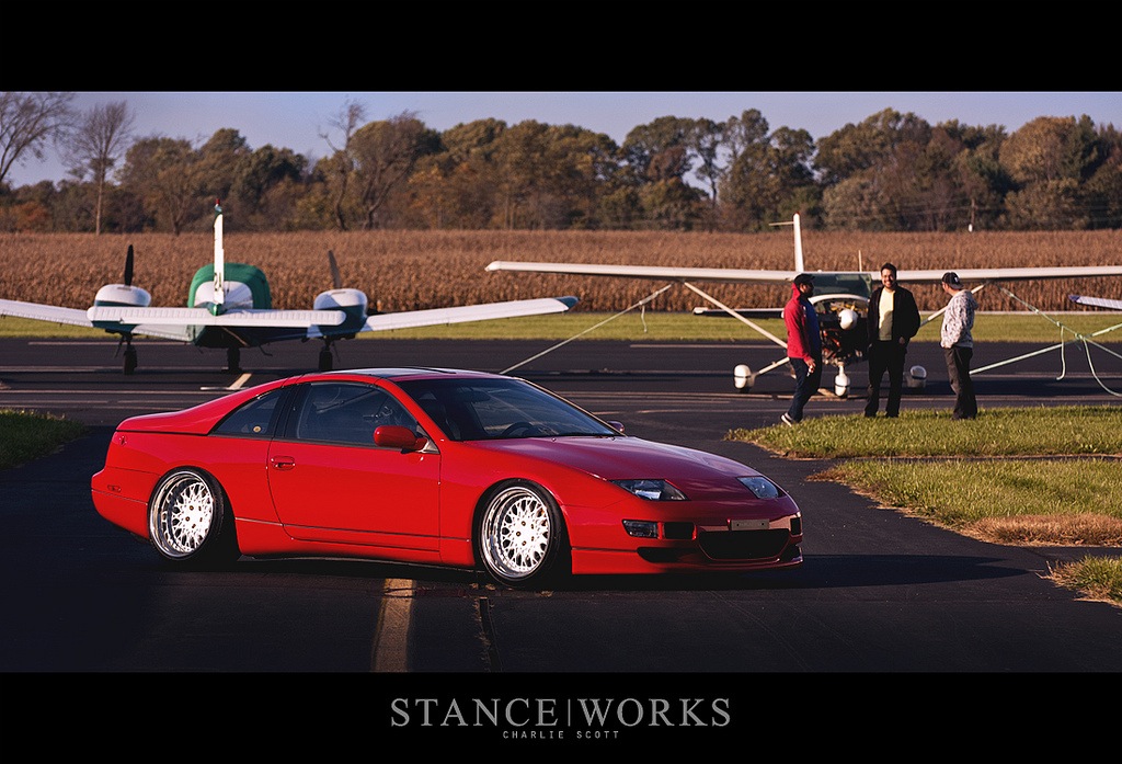

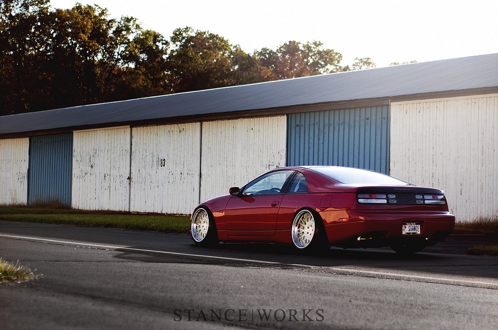

Vince is an architect with a knack for creating with the smallest details in mind. Like most of us, he prefers a challenge in his personal projects and he received that (and then some) with this 300zx. This is not just “any” 300zx as it’s been in his family since it rolled off the showroom floor in 1990. Vince has owned it for the past 8 years and has been building it ever since. He has a design philosophy of “accentuating the simplicity of something while still pushing any and all of the boundaries of what can be done to a car.” Frankly, I could sum up this article with that statement alone as it shows throughout the entire car, but we are just getting started.
So where to begin? Well, having a background of creating things from scratch has it’s advantages when building a car. Practically every piece on this platform has been replaced, with a 3 page modification list to prove it. The kicker is that Vince designed and fabricated a lot of the modifications himself. When I say he has been building the car for 8 years, it’s not because he is lazy or unmotivated. Each aspect of the car has been given a thorough examination of how it could be made better in same way, right down to the door sills. If you didn’t know any better you might ask, “but why does it look so stock?” Vince explains:

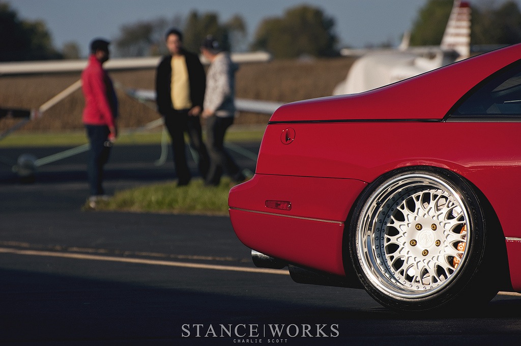

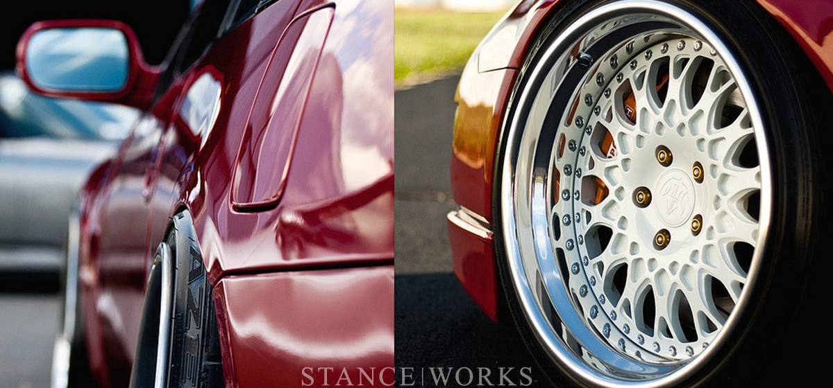

Suspension and wheel fitment has always been a guiding force for Vince, as he wants a simply designed car that screams low and aggressive, almost menacing stance. He has gone through 4 sets of coilovers and numerous wheel sets which brought the project lower and more aggressive each time. Fitting a set of 12.5″ rear wheels on a body and taking into account the original paint is quite a task, but in the end after hundreds upon hundreds of hours, it looks like it was made for the car.

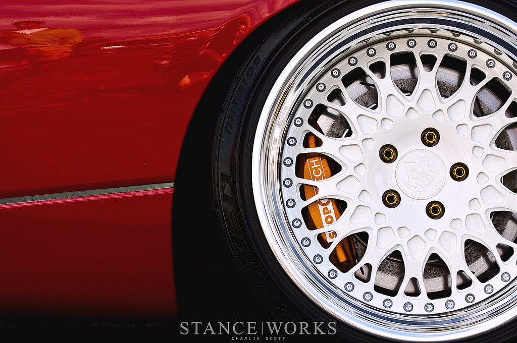

Vince wanted to set the car off with a unique set of wheels that hadn’t been done before. He contacted Stance|Works sponsor VIP Modular to design something that they hadn’t produced yet. What he ended up with was a svelte-lined mesh wheel, now known as the VX110. It would be the first set that VIP Modular would make. Pearlescent White centers and billet caps set off the mesh face beautifully against the mirror polished 4-inch front and 5.5-inch rear step lips. That would be enough for most, but Vince is a glutton for tasteful details. Thus, he also had the inner barrels mirror polished, the valve stems hidden, and ARP fasteners to hold the multi-piece wheels together. “Smitten” comes to mind, when thinking of the final product tucked gingerly against the pulled fenders.

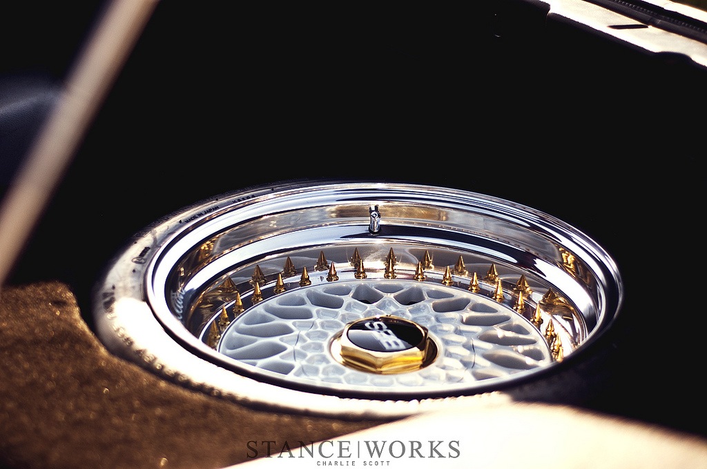

Vince builds BBS wheels as a side hobby, which draws me to conclude he never sleeps. With that said, if you are gonna have a side hobby why not show it off? The spare is a 16 x 4.5” BBS RS with the same Pearlescent white used for the VX110 centers. Gold bolts and polished lips round off the “wow” factor.
Such wide and beautifully carved wheels would be poorly complimented with the original stock brakes from 1990. Vince selected StopTech Sport ST-40 calipers with 355×35 2-piece AeroRotors for the front. Unfortunately, StopTech did not have a big-braking system for the rear of the Z32 so, much like everything else on this car, something had to be fabricated to give the wheel wells the necessary jewelry they deserved. Vince had a custom set of StopTech Sport ST-45 calipers made for the rear, utilizing the same 2-piece rotors. I won’t go into the details of what it took to make this happen, but I will say it took some strong determination from Vince in seeing it through.
