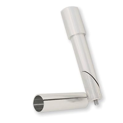

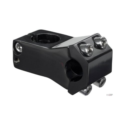

        The million dollar question is now; will this stem, which is the same size as my current stem:
        [ame="http://www.amazon.com/Delta-Threadless-Bicycle-Headset-Adapter/dp/B000FGYKY6/ref=sr_1_39?s=sporting-goods&ie=UTF8&qid=1313623634&sr=1-39"]Amazon.com: Delta Alloy Threadless Bicycle Headset Adapter: Sports & Outdoors[/ame]
        fit with this:
        [ame="http://www.amazon.com/Dimension-Stem-50mm-Threadless-Black/dp/B001CK0MYQ/ref=sr_1_2?ie=UTF8&qid=1313623845&sr=8-2"]Amazon.com: Dimension BMX Stem 1-1/8" x 50mm Threadless Black: Sports & Outdoors[/ame]
        Then I will have the lowest bars possible and have the option of running BMX jump bars, or smaller bullhorns in the future.

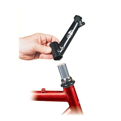

          Snatched the stem and fork off of a diamondback I had in storage and swapped it on this bike. Still not entirely too happy with the way it fits/looks, so Im going to keep looking. At this point I am buying a 1-1/8th" blank stem to fit in the original fork, and a 1-1/8th" BMX style headset to put on it, then attach the 22mm mnt bike low-rise bars I have until I pick out another set I like.
          1-1/8th" headgear
          1, or 1-1/8th" blank stem that fits my original fork

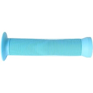

          BMX grips for my low-rise jump bars

                Okay, roughly put the bike together tonight. Its ride-able but I have to bring it down to a bike shop to have them repack the rear hub on my other wheel so I can put on the single speed cog. This wheel is a temp freewheel with the chain tightly on the preferred gear ratio. The front stem is in, and the temp headgear is on until my BMX headset gets here to bring the bars back. Pretty happy with how the chain/front crankset gets along so I'm not going to worry about replacing it for a while.
                [ame="http://www.amazon.com/gp/product/B000FGYKY6"]Amazon.com: Delta Alloy Threadless Bicycle Headset Adapter: Sports & Outdoors[/ame]
                is the link for the stem I used. Slightly went up in price but still a good deal.
