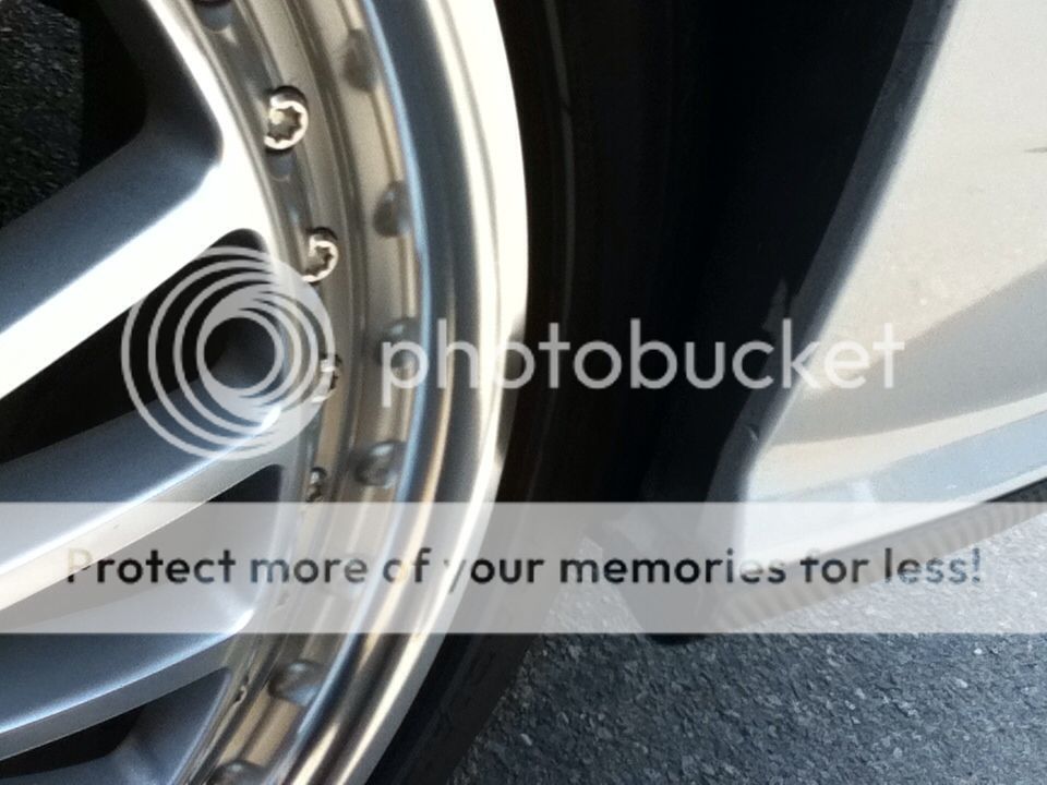

Hi guys,
I have a 92 Bmw 325i sitting on racelands, 18x8.5 wheels et30 w/ 225/40/18 tires in the front and I'm having an interesting issue and idk if anyone else has ever had this problem. The back edge of the nose panel where it meets the fender is rubbing the outer edge of my tires in the front, The whole problem started after I installed the oem bmw motorsport offset lcab bushings. rolled front fenders out a bit in hopes it would pull the nose panel with it, sorta work but not really.
I know some other bmw guys run some really wide tires with a lot of meat up front so I can't be the only one thats having this issue
A good alignment is also in order so that should help since it appears to be toed out from doing the suspension work
Anyways all is much appreciated
P.S. I know racelands damping and spring rates run on the soft side so I have a sneaking suspicion that they may be part of my problem
