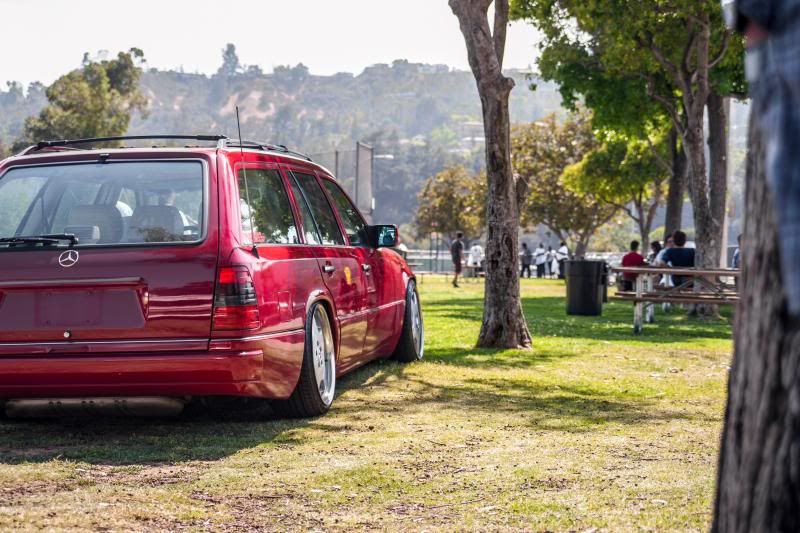

Here's how my wagon sits with e36 coil overs and SLS Delete/Cut Springs:
