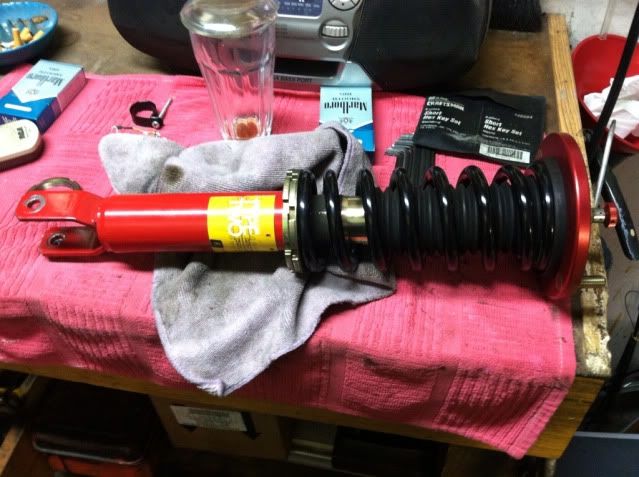

                          sorry crxmarc I didnt see your edit until just now. Here's a picture of my coilover with the ring removed already
