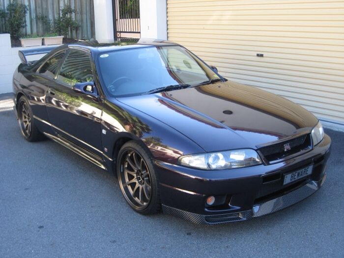

            This may or may not help you, but with Tyrestretch being down(which it has been a lot lately) this photo might help a little.
            This was my GTR on 19x10.5's with 265/30 Federals(which run a little wide), very small amount of stretch.....I know you've got 11.5's and you're wanting something meatier, but just as an example of a 265 on a 10.5 and an example of a 265 with a 30 profile seeing profiles have been discussed. So a 265/35 would be a little taller in the sidewall obviously.
            Maybe not the best photo to see, but at least it's something.

              Thanks alot! Your R33 GTR Looks amazing..
