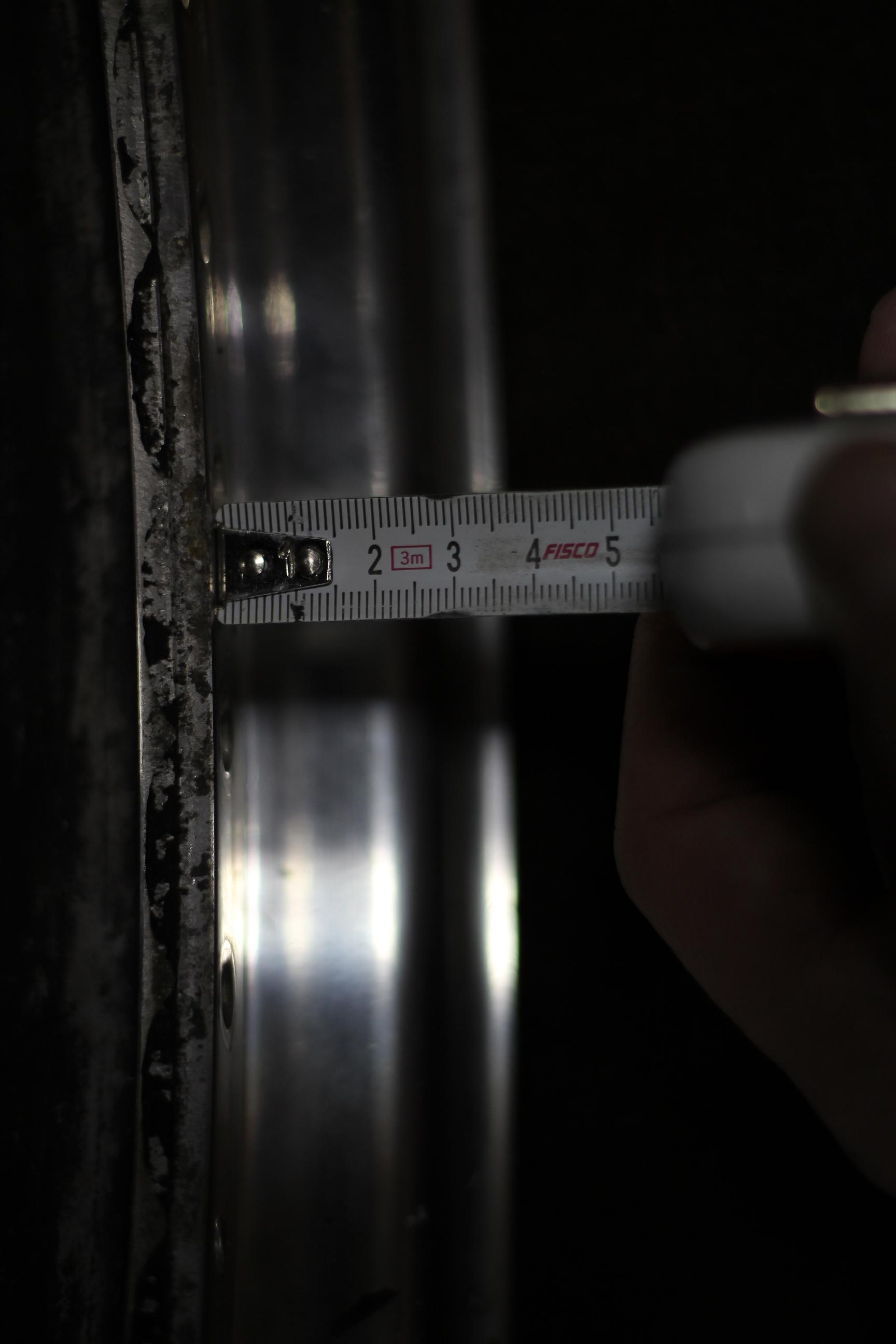

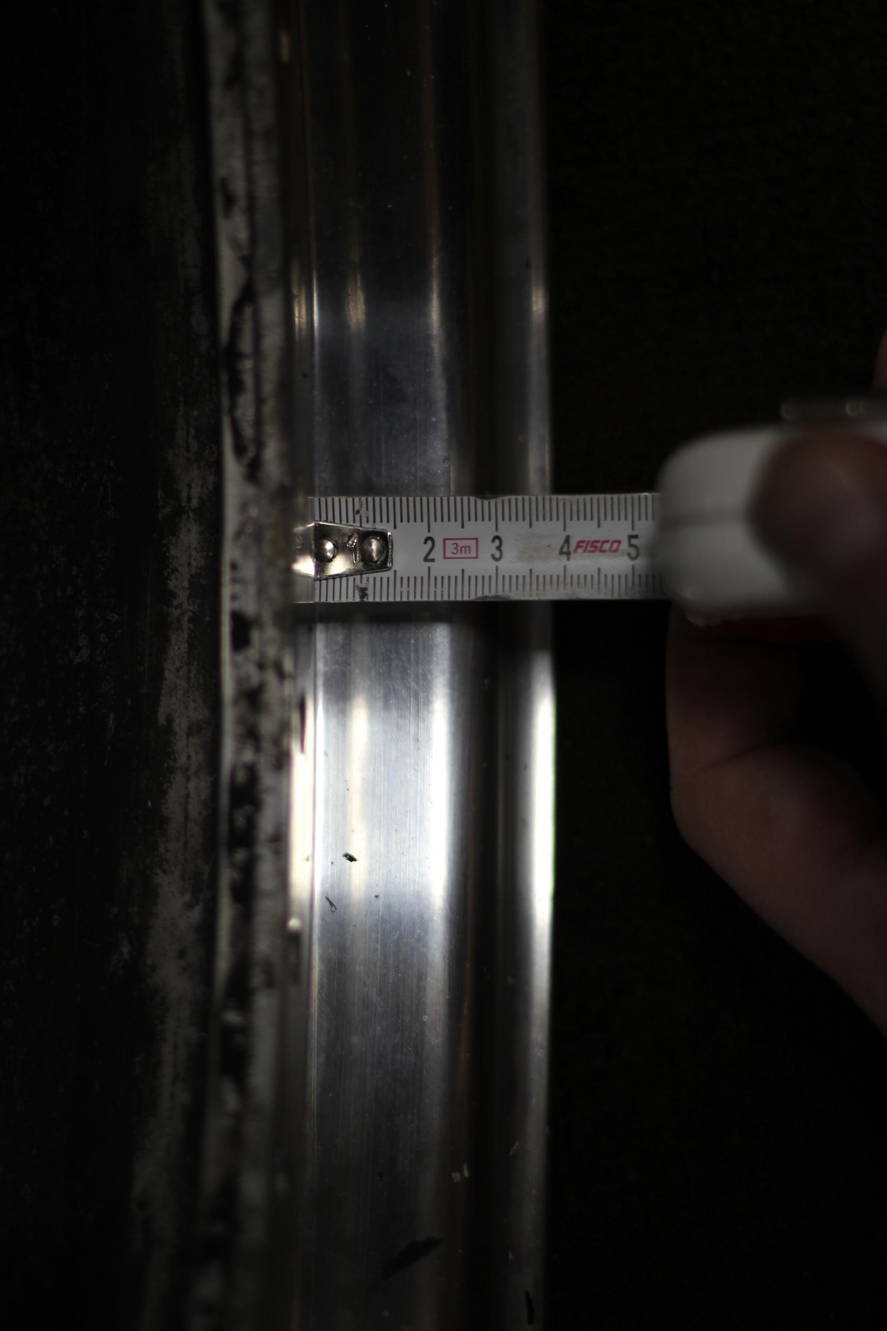

          i'll use this thread as i'm in the almost same situation...
          i have 8,5 AMG Aero I wheels, made by OZ, they're rear mounted (not sandwich), so can you tell me by these pictures are those lips 1,5 inch wide or not...

              @Zic, just checked wheels, they're sandwich mounted.

                I would say that they are 1´" drop lips, 0.5" centers and 6" barrels then.

                    they're ET30

                      That's a 5" barrel, 1" lip and the center are 1" thick (sandwich mounted result 7" )

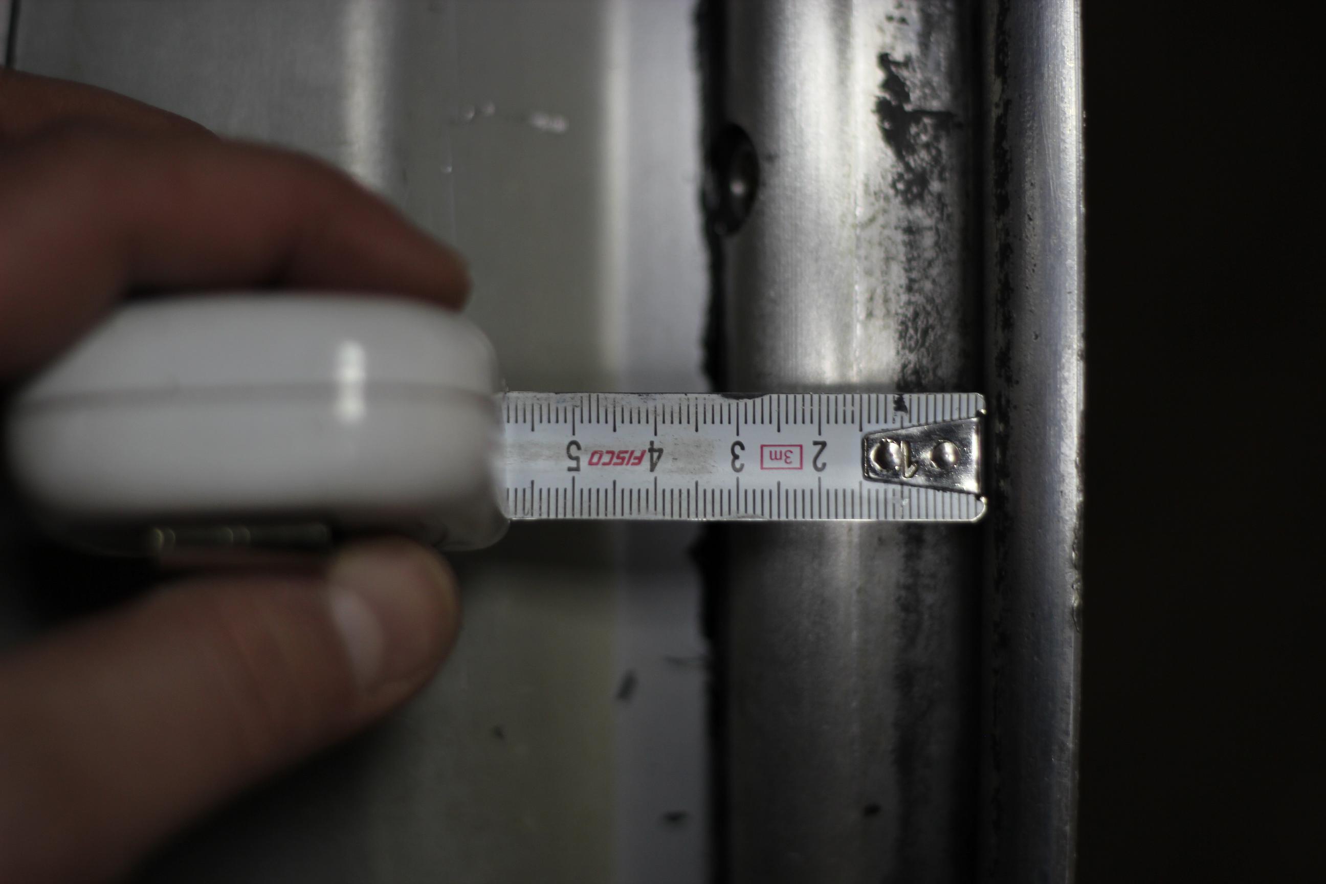

                        thanks for the link, but i'm still not quite sure, because don't have measuring tool in inches, only in centimeters and i can figure out the exact numbers...
                        but most probably its a 7,5inch barrel with 1,0inch lip, as they're with rear mounted faces (not sandwich).
                          1 inch= 2,54 cm
                          and subdivisions are
                          0 1/8 1/4 3/8 1/2 5/8 3/4 7/8 1
