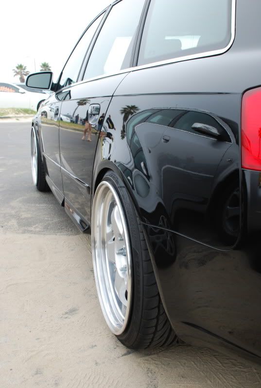

            Good luck with that...
            WOAH!! your calcs are off man, no disrespect tho.
            19x9.5 +38 to a 19x10 +38 would be 6mm more poke off the bat.
            add another 18mm to that (38-20) would give you 24mm more poke than your current setup.
            also, if you pull fenders you could definately fit it and possibly tuck it as well.
            here is a pic of 19x10 +25, and since its 19 your have to play a little safer on the offsets, but if you run 18's, your limitless
            www.stateofstance.com
            The unofficial Work Wheels whore in the making

              Well here is what my faces have been shaved to. they are flush with my hub
              • #37
                        no it's my fault, I calculated a 0 offset on a 9.5 as 4.25" rather than 4.75...
                        Either way 1" is alot, but again you could probably pull the fender a bit to get it to work, but it would take some effort and a pretty serious stretch as well, maybe a 215/35 on a 10...
                        I also feel like my car is too high in the rear. When I first mounted the wheels when I ran a 235 on the 9.5 it was rubbing at my original drop and I didn't want to deal with it on a daily so I had to raise it up quite a bit. I did get some 225's on there this year, and it did help the clearance issue, but I still don't feel I'm as low as I should be. The offset/dish situation is trickey on an a4, personally I'd prefer a bit less dish to be able to slam it pretty hard...
