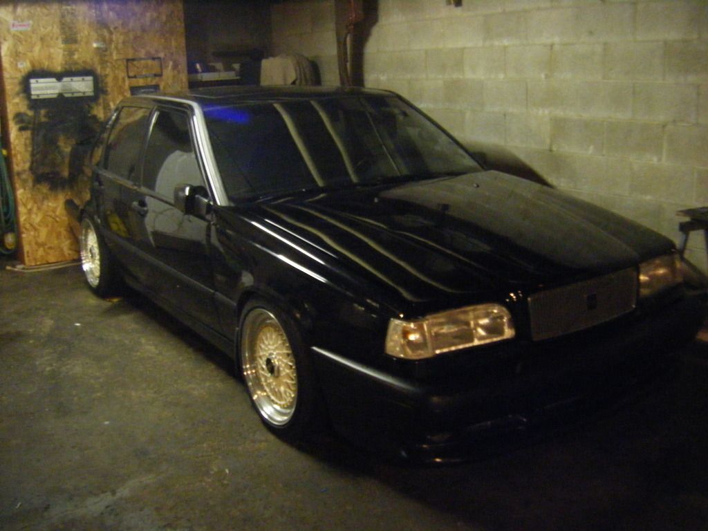

Thanks for the replies. Well, I now have my answer to which came first, the blow out or the snapped bolts, it was indeed the snapped bolts. Driving home yesterday after I got the wheels back on the car just this last Thursday and the sound right before the tire blew out last time came back. Pulled over quickly to find the tire on the same wheel super low and 6 snapped bolts, right in the same spot (well, 3 in the same group as before and 3 more over), but generally in the same area.
I'm taking the wheels apart and am going to use OEM hardware and get rid of the BFI bolts. I will also check for any irregularities in the face, barrel, or lip.
What I don't understand is that I drove on these for close to three months with no issue. Then one day 7 bolts snap and I blow a tire. Replace the bolts and get the wheel back on the car and then 4 days later it happens again.
I had a setting on my drill that I was using and it was torquing them to about 13ft lbs. I did that so it would be consistent. I've read that everyone recommends 15-18. Maybe that just wasn't tight enough. I only have a 1/2" torque wrench and it's a complete PITA to use, I need to pick up a 3/8" one and do it all by hand.
The fact that the wheels were on the car without issue for 3 months kind of makes me believe that the problem isn't in anything being straight or not. Probably with more inconsistencies with torquing. At least I hope so.
So if anyone has some OEM hardware, please let me know!
That's my hope. I hear about people snapping BFI hardware quite frequently. I should have taken my friend's advice from the get-go and kept my OEM hardware.
Car was looking so nice this past weekend too with the smaller adapters in the rear and larger tires.
