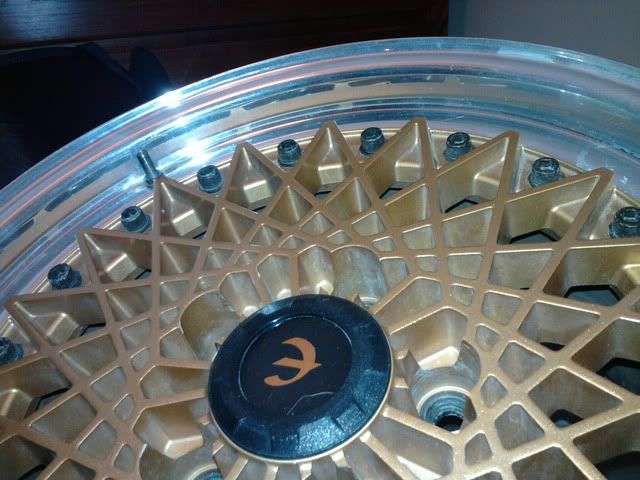

    So I just bought a set of C4 wheels. Need a little work til they are on, but had a few questions. What have you guys used to bore out the centers to fit the slightly larger BMW center bore? When bored out does the chamfer fit onto BMW spacers correctly or do you have to machine that as well?
    Last question, what kinda camber are some of you running to fit 9.5" widths on the front of an E36?
    Pics will come in a couple weeks when everything is finished.
    Taken with cell phone. Little spoiler of what's to come.
