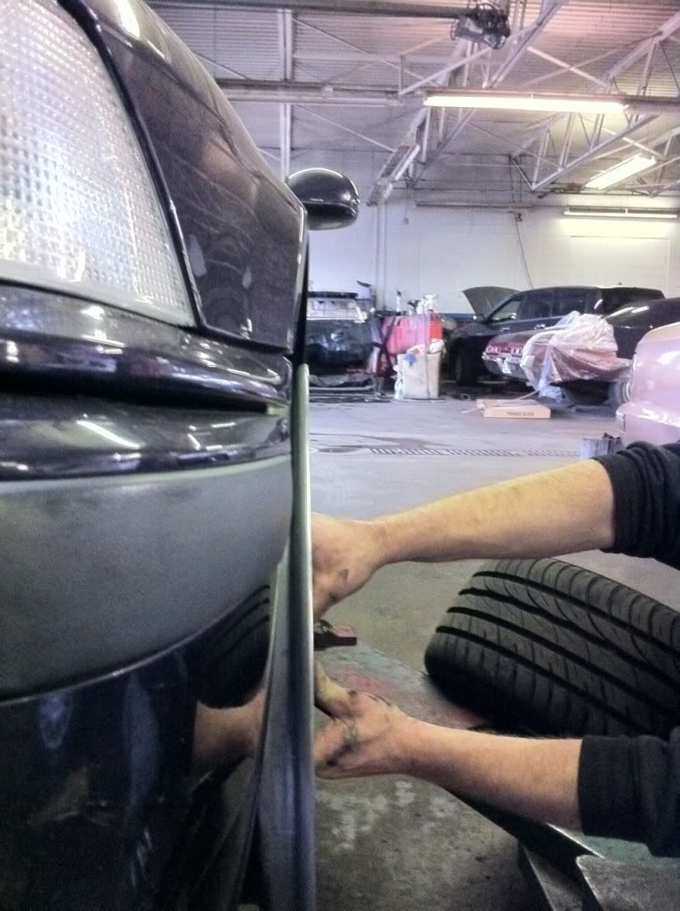

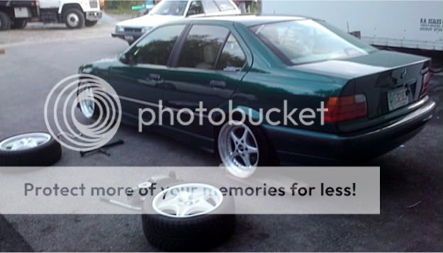

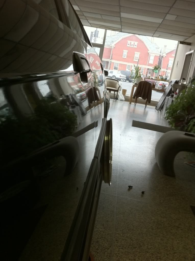

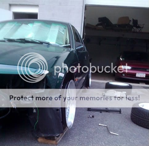

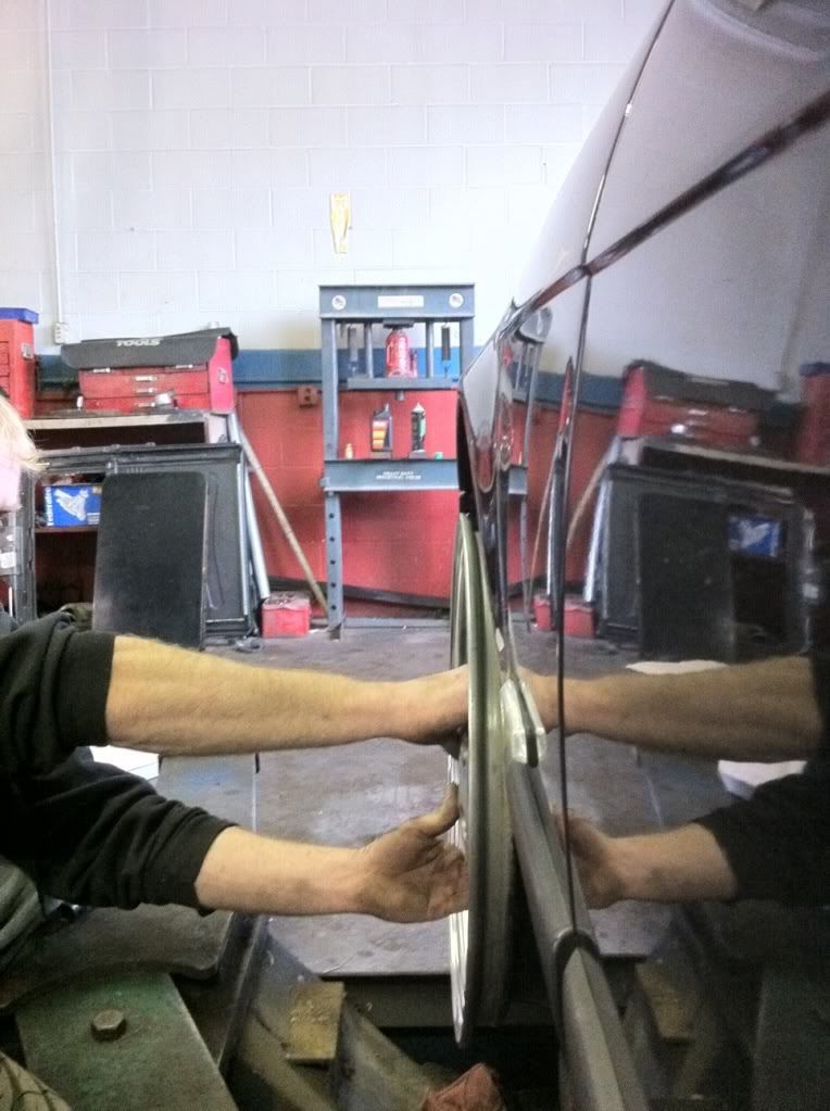

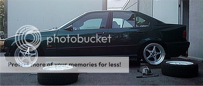

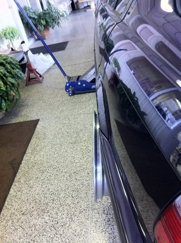

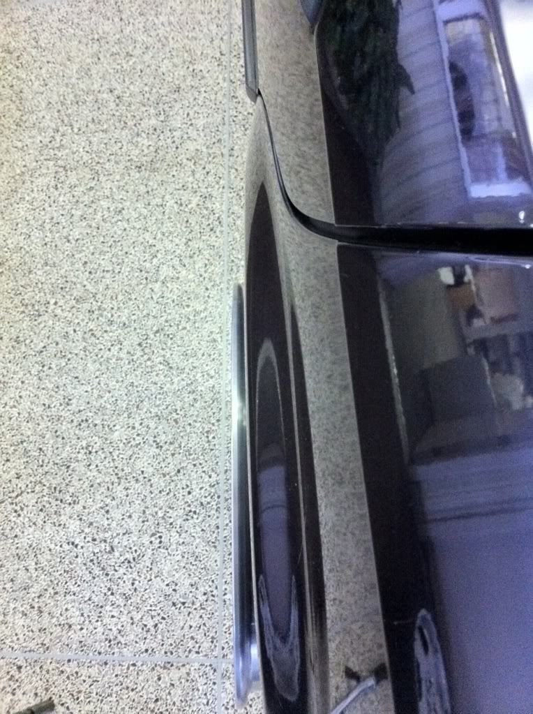

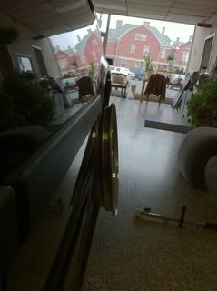

            • #21
              first pic is the current ride height and camber w/ stocks on.
              fronts are only spaced at a 25mm in the pics w the mitos on, but its going with 30mm.

              • #22
                fronts looks like they are gonna sink in a bit. (not to be negative, just pointing it out) And the rear are sexy, i think i would go 245/35. or 265/30.

                  • #24
                    Thanks for the pics bro. Like I said, fronts are only spaced about 24-25 in those pics. I'll be spacing them another 5mm at least for them. Should have some poke for sure.

                          • #28
                            I would do 10mm spacer in front for poke cause with 5mm you will be flush/slightly sagging. Because your car is not sitting on the rims. You should have layed two 2x4 under each rim and set the car down, for proper fitting inspection. As for tires, I will be running these tyres on my new wheels 215/35R18 on 9.5in and 235/35R18 on the 10.5. So for you, 205/35R18 on the 8in and 235/35R18(for crazy stretch) or 245/35R18(for not so crazy but still a nice stretch rim) on the 10.5
