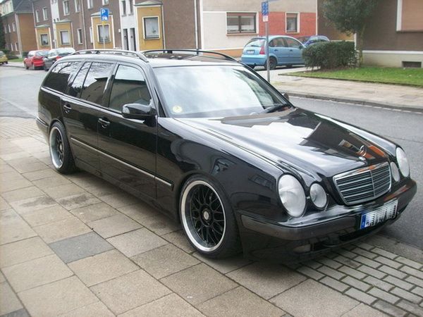

    check my post for fitment, go with the lowest et he has, these cars accept really wide wheels without clearance issues

      take the wheels with lowest ET/offset and you'll still need some spacers (maybe)...

        I've looked your thread wagonist many times for reference, but wondered are there much different on sedans vs wagons.

          wagon and sedan are the same fender arches, that 11.5 that luke is selling would be too big for a w210, perfect on a R129 tho.

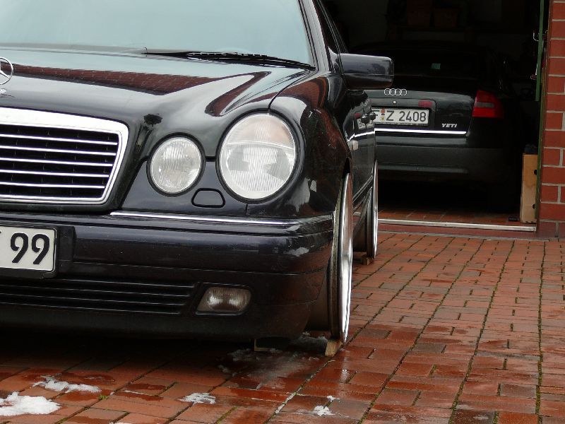

          for another reference this is ET40 and ET40 10Jx19 11jx19

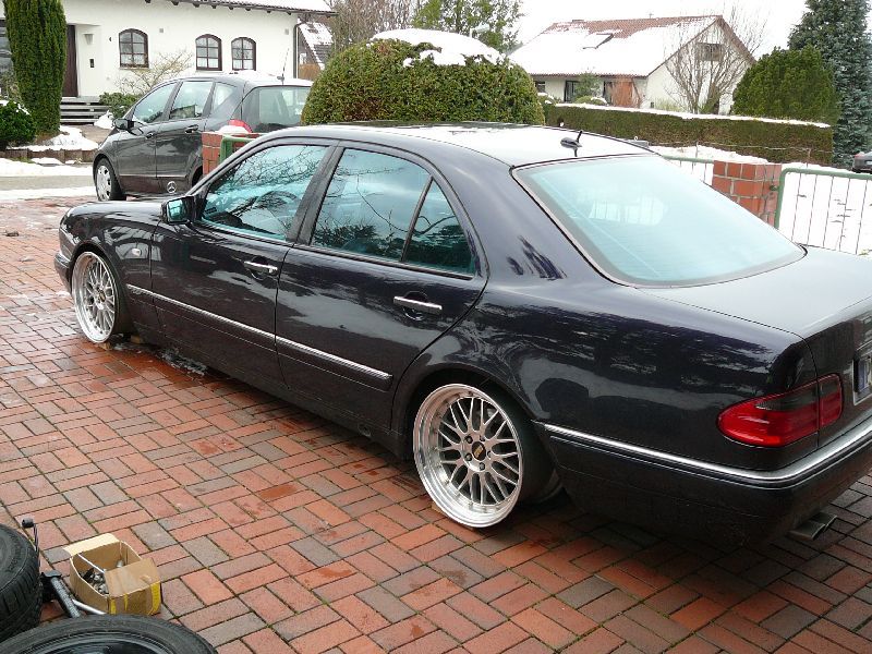

            another reference, 9.5x18 ET25 11x18 et 35
              another reference, 9,5 x18 offset 25; 11x18 ET35. 225/40 and 265/35
              so as you can see, 11j18 is possible with a maximum et of approx. +35mm, anything lower would require fender pulling..
