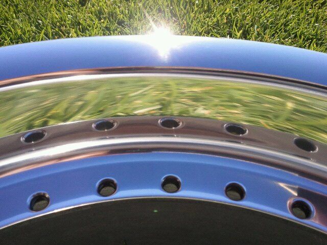

Of course it helps, I'm about to do my second set of RC, and I think I'm going to follow your steps, one more picture of the set I'm mounting now (I'll restore it after making up the second set):

Thanks for the compliment!Originally posted by kazarn View PostAmazing result!!!!! where did you get the grits?? and did you make all the polishing process by hand?? didn't you use an electric drill or something???
I purchased all of the sandpaper at the local auto parts store. I use 120 grit on a rubber sanding block to smooth out the curb rash. Then use the 120 grit by hand (fingers) to knock down the machining grooves. This process took me about 3 hours per wheel. Then I use 220,400 grits dry. I start using water at 600 and continue through 3000. After 1500 I use Mothers aluminum polish between grits to ensure that I have removed all of the previous grit scratches. If I missed any...I go back over the wheel with the previous grit. Trying to remove a 1200 grit scratch with a 2000 grit paper is damn near impossible. I do it all by hand...no power tools.
I hope this helps
Leave a comment:
Amazing result!!!!! where did you get the grits?? and did you make all the polishing process by hand?? didn't you use an electric drill or something???Originally posted by TeeTime4One View PostI wanted to give a little background on my wheels and the adventure I have gone through since buying them back in June of this year. I had looked for a set of style 5's for over a year when these popped up on the Denver craigslist for $450.00. I knew what potential these wheels had if I could get my hands on them...but, had no idea of the labor that would go into them in order to achieve said potential. I was offered guidelines/instructions on polishing my wheels from a friend in California who had polished a set of his own. I followed his advice to the letter and found that he was spot-on in every aspect. I was also told, "welcome to Hell!" lol That was an understatement.
I have completely polished 3 of the 4 wheels as I type this. The 4th wheel is being finished today. I have grits 1000-3000 left. I have done these all by hand without the use of any power tools. The results are stunning! Here are step-by-step pics of the process. Enjoy

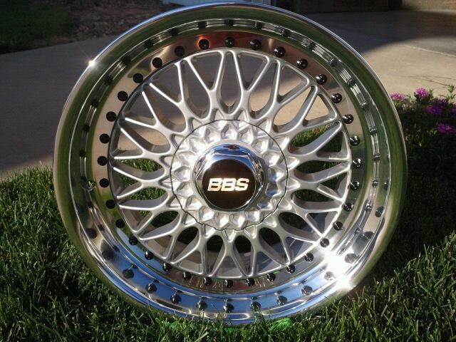

Polishing RC909's

Before and after
