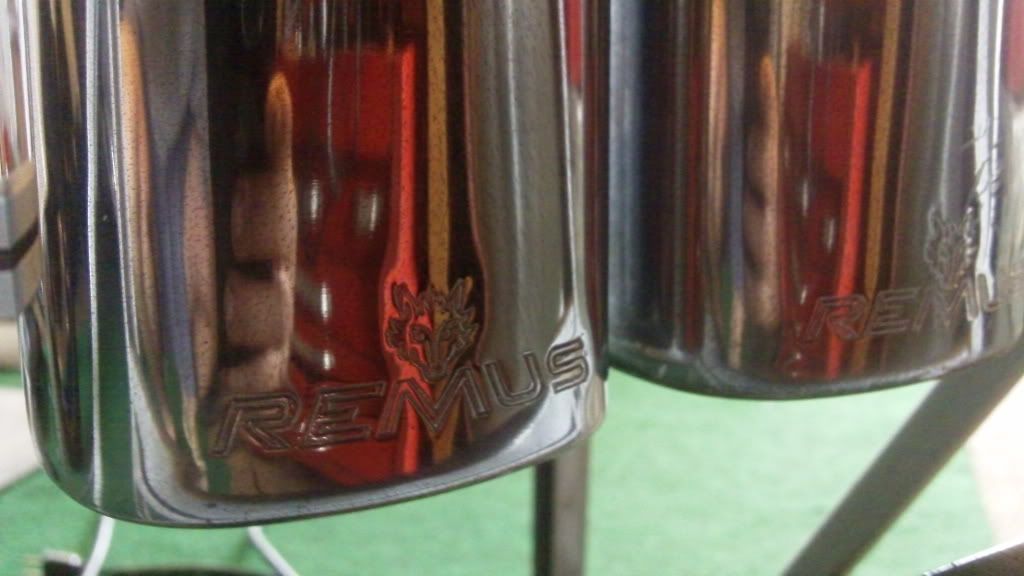

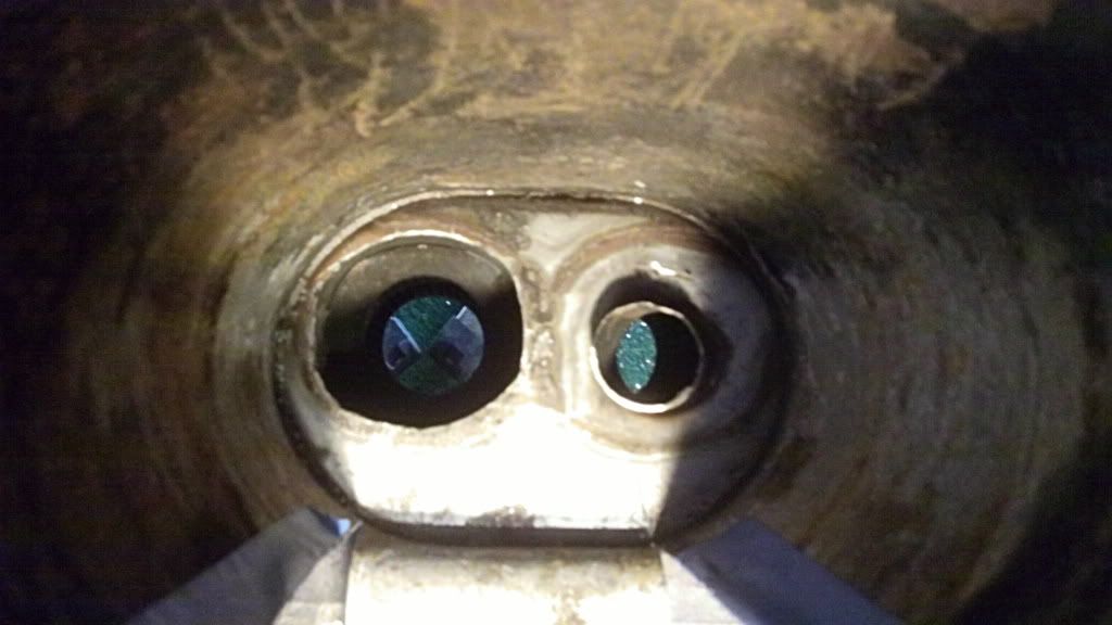

It's a 10 year old Remus for a E300 that I had on my 190D for 400,000 miles. Single 1 3/4" in wasn't going to work for the V12. Gutted and designed a 4 chamber, dual 2 1/2" in, and opened up the ass end a bit. 1 side done, other side almost done, then off to the welding shop. The stainless is still in good shape.
Sound clips at 11
