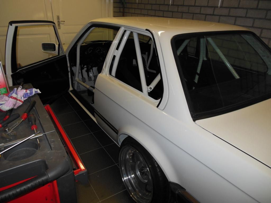

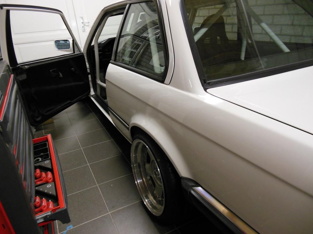

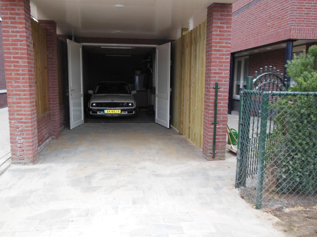

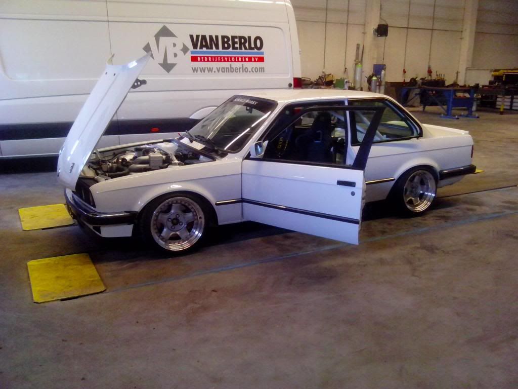

                    My e30 standing in my new garage:

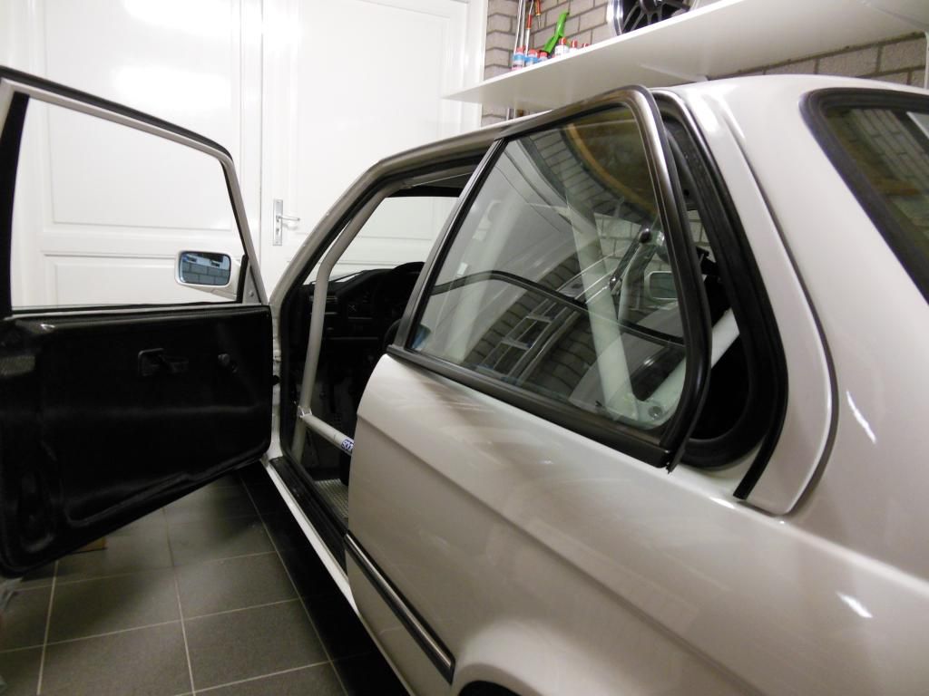

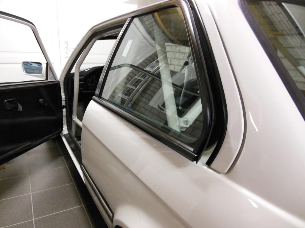

                    I was looking a long time for other rear Windows that van be open. After 2 years searching I have the rightWindows!
                    Old window going out
                    New window:
                    First position:
                    Second position

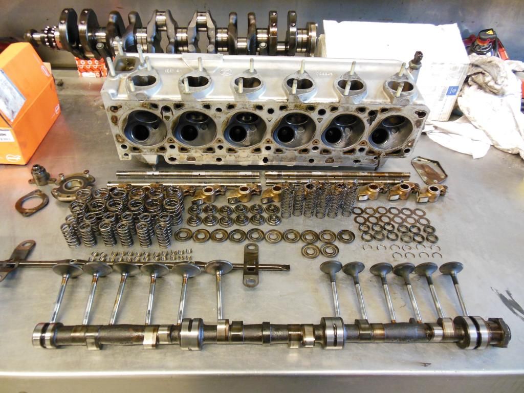

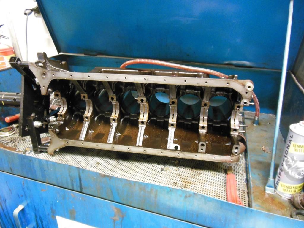

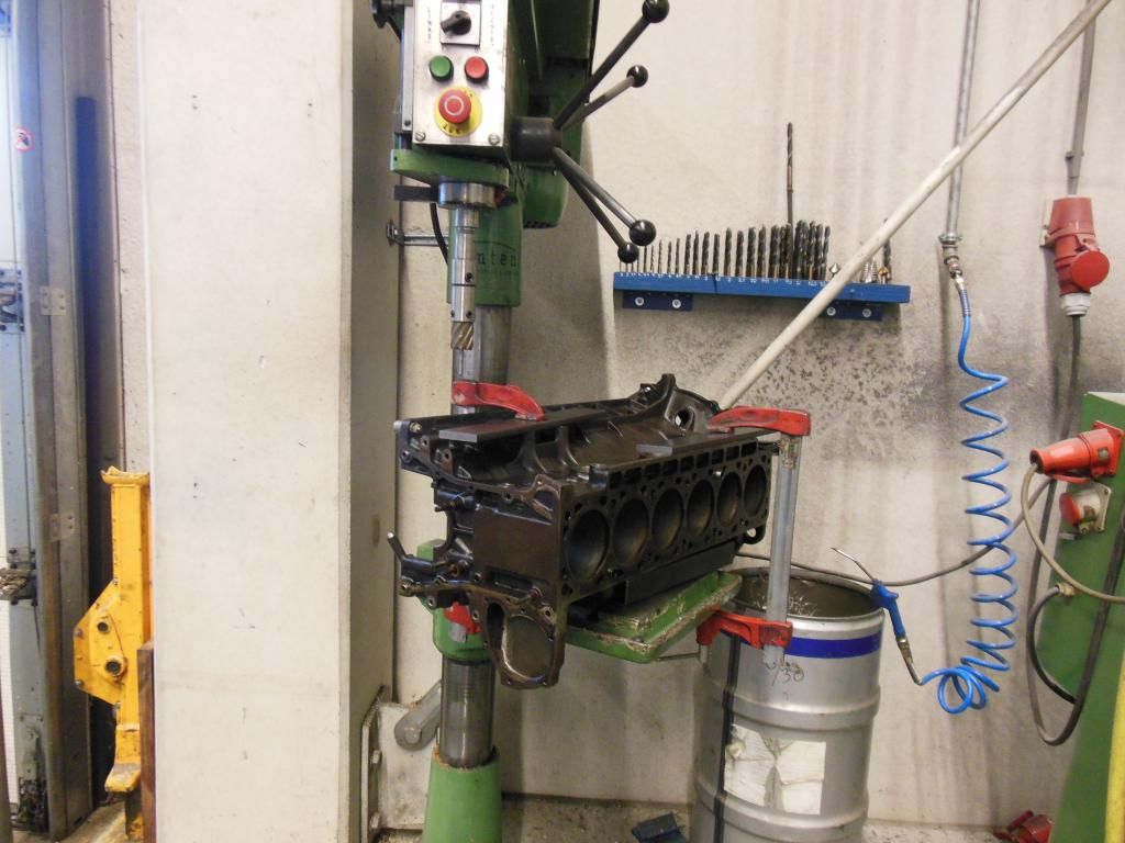

                    And I start building my new engine:
                    M30b35 engine:
                    One day later:
                    Making clean:

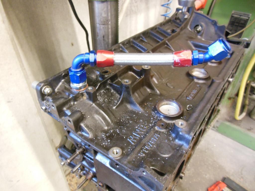

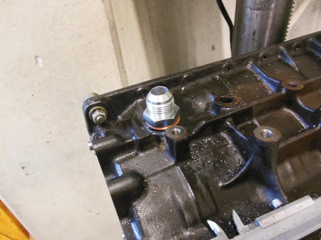

                    Making a An12 oil back line:

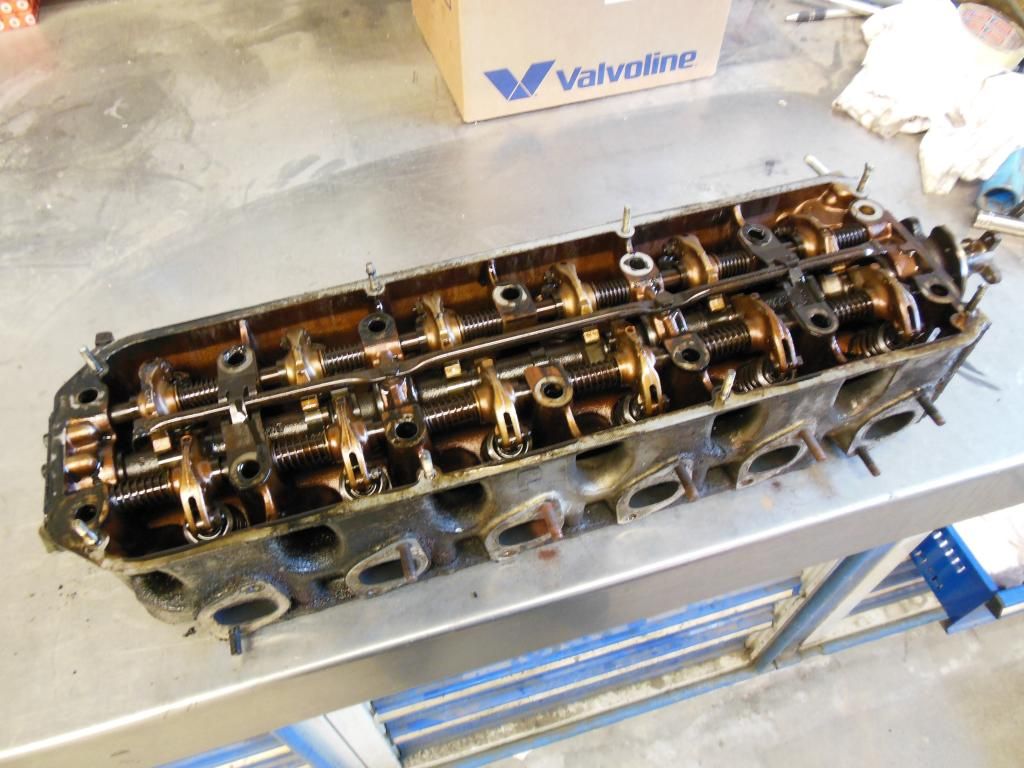

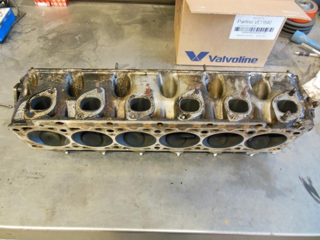

                    Cilinderhead:

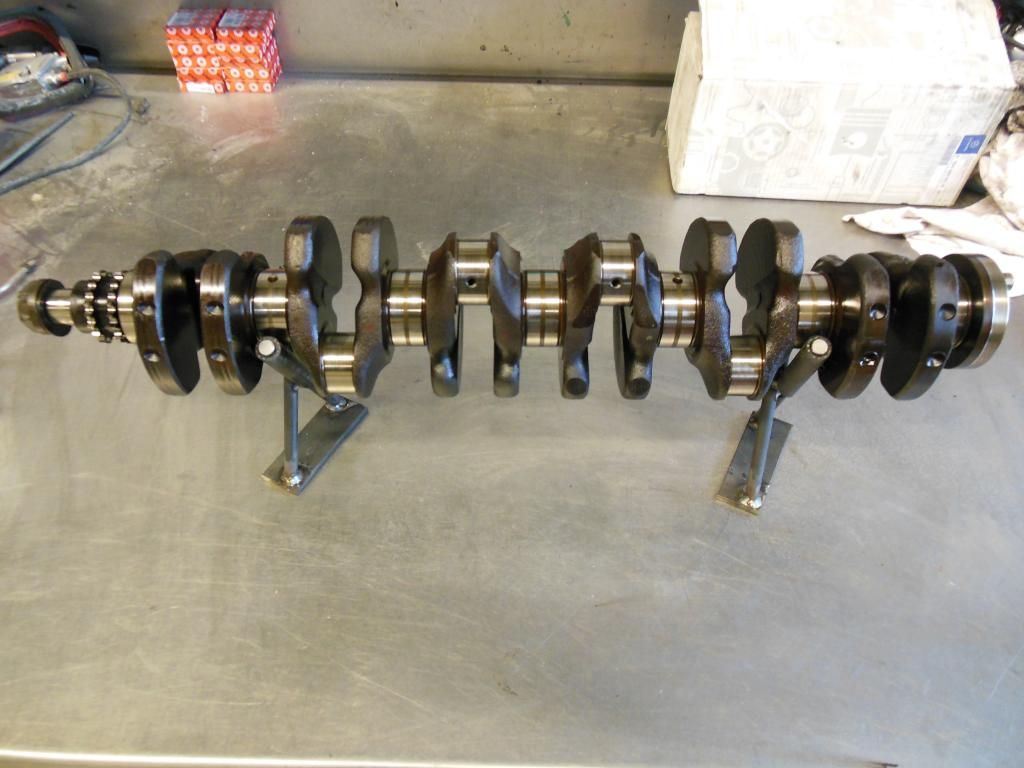

                    Crankshaft:

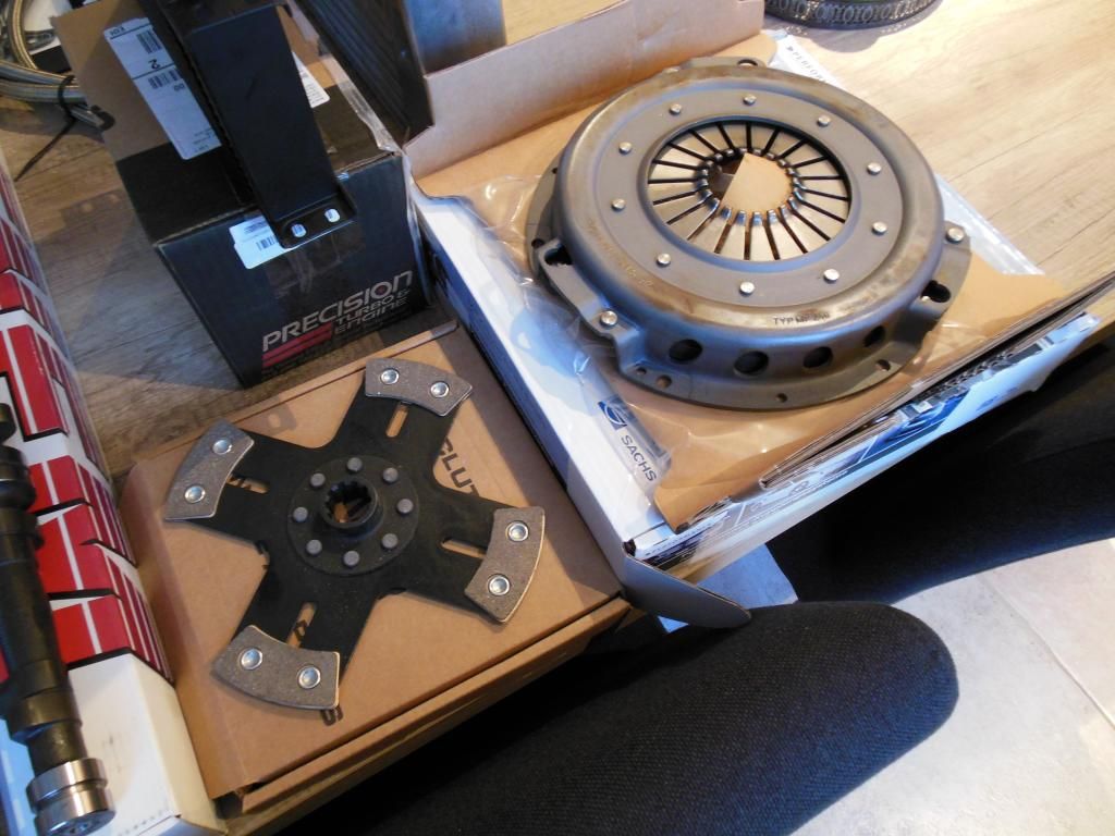

                    Sachs 765 versterkte drukgroep incl sinterplaat samen bestand tegen dik 800nm koppel:

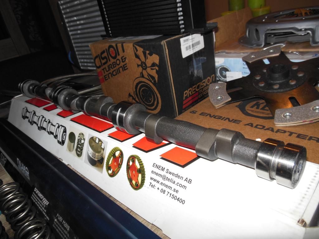

                    z55 284graden nokkenas:

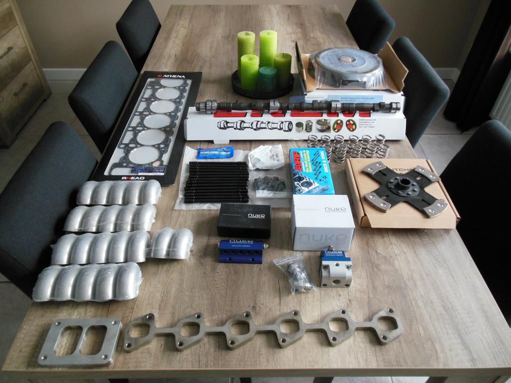

                    All parts:
                    -PPF 50mm bov
                    -46mm Precision wastegate
                    -6x 630cc injectors
                    -Nuke injectorrail
                    -Nuke fuelpressure regulator
                    -Nuke vacuumstation
                    -Holset hx55 turbo
                    -PPF Z55 284 degrees cam
                    -ARP Studs
                    -Athena o-ring headgasket
                    -PPF stage 1 springs
                    -Setrab oilcooler
                    -XS power 3inch intercooler
                    -RVS 304 exhaust material
                    -Sachs 765 Pressureplate
                    -Kep sinterplate

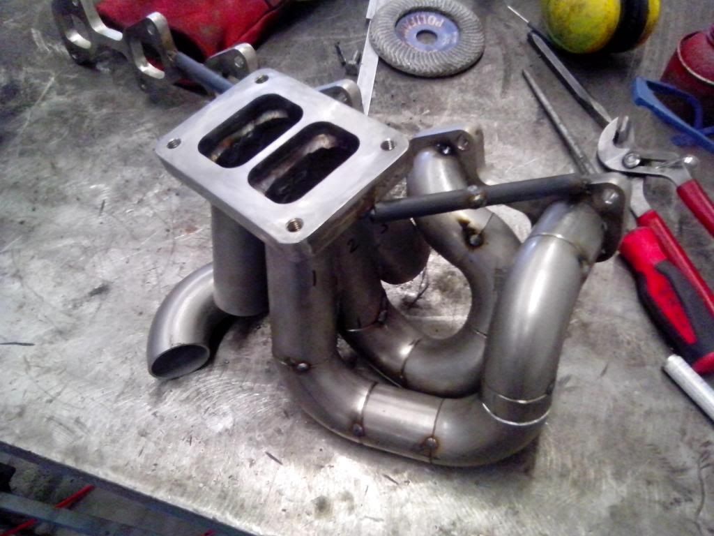

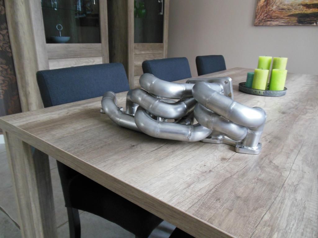

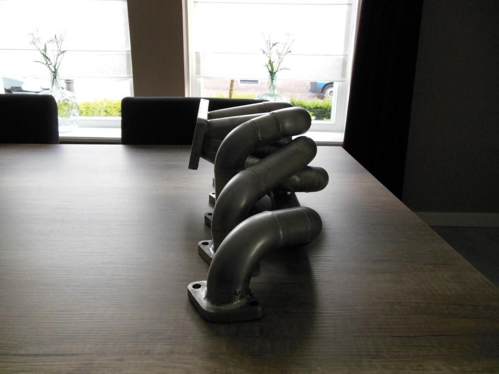

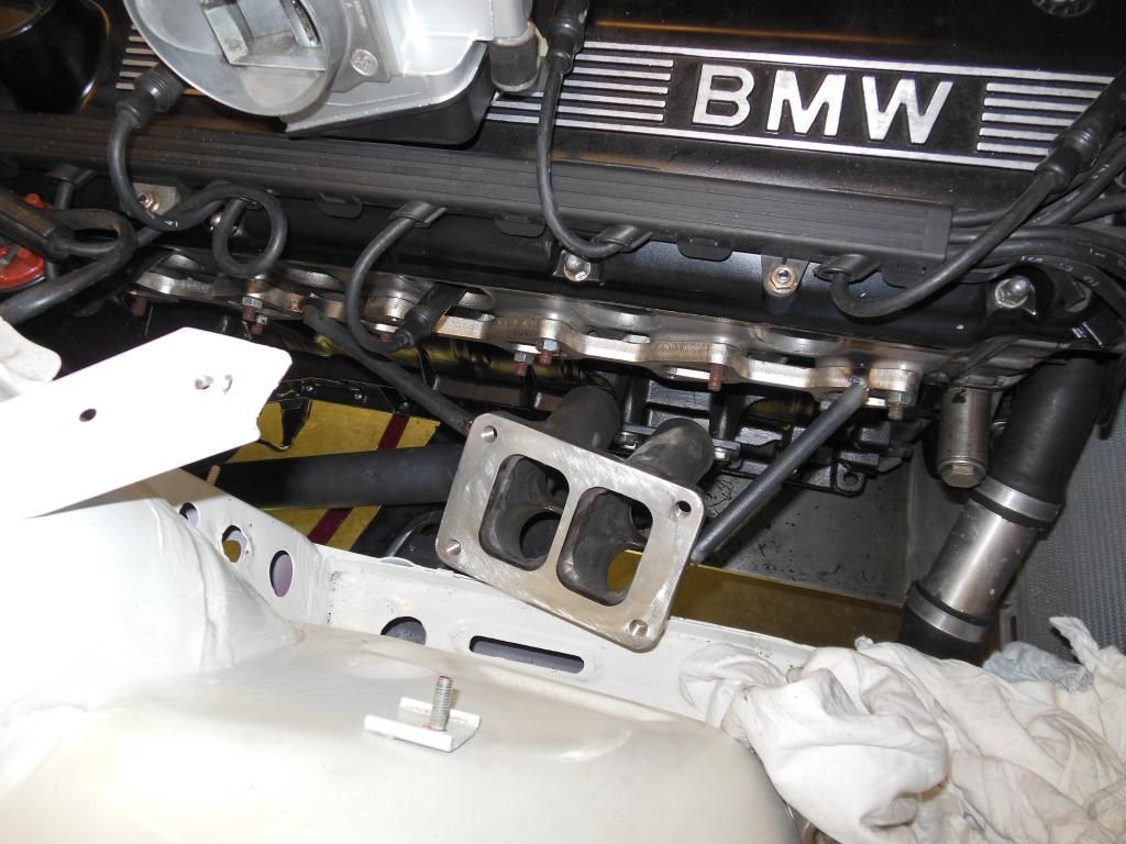

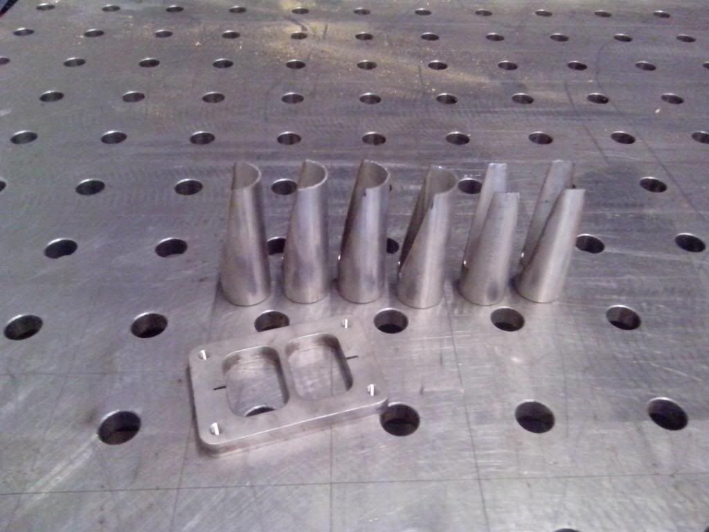

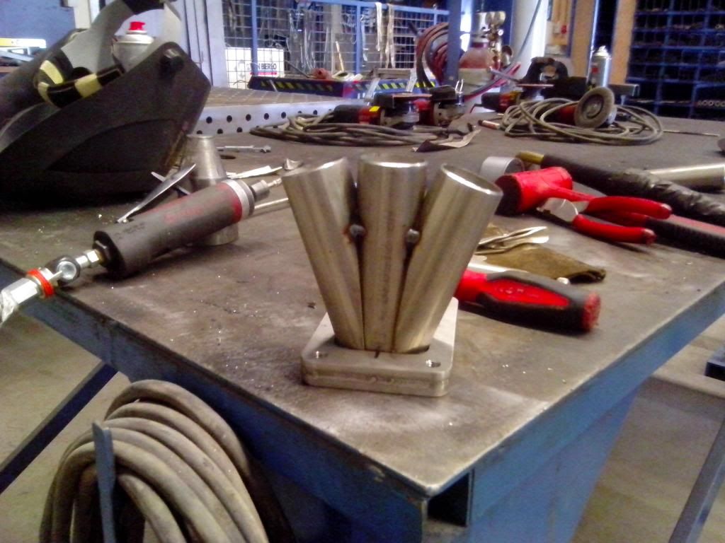

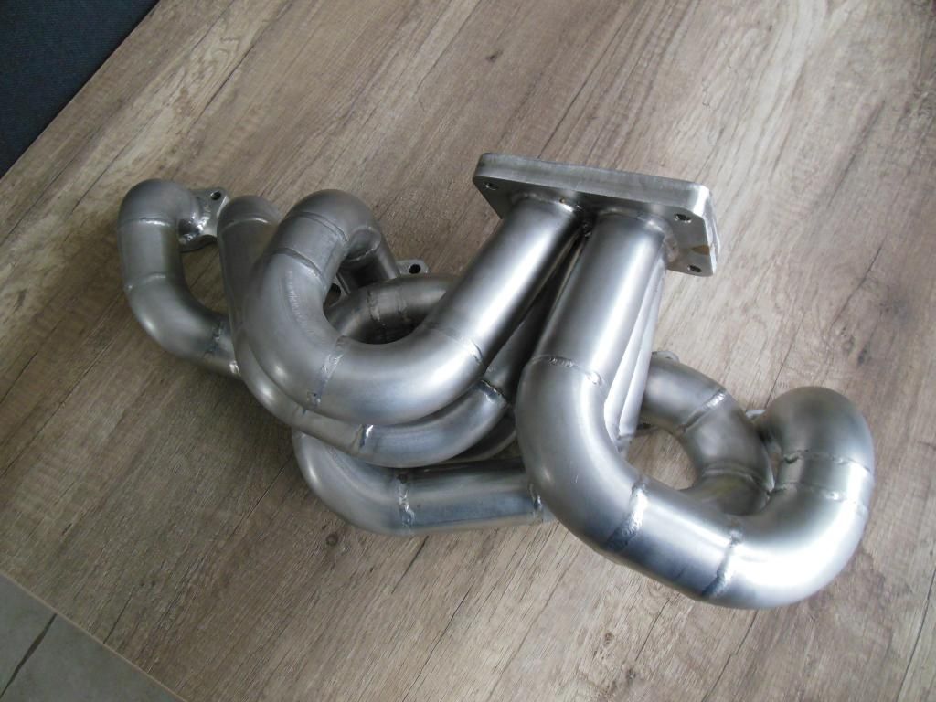

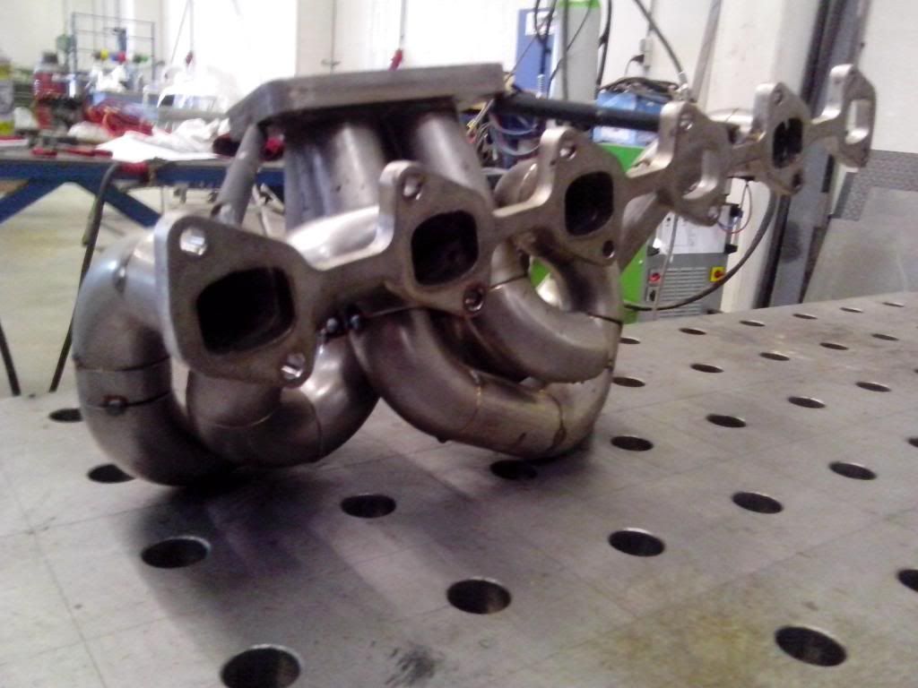

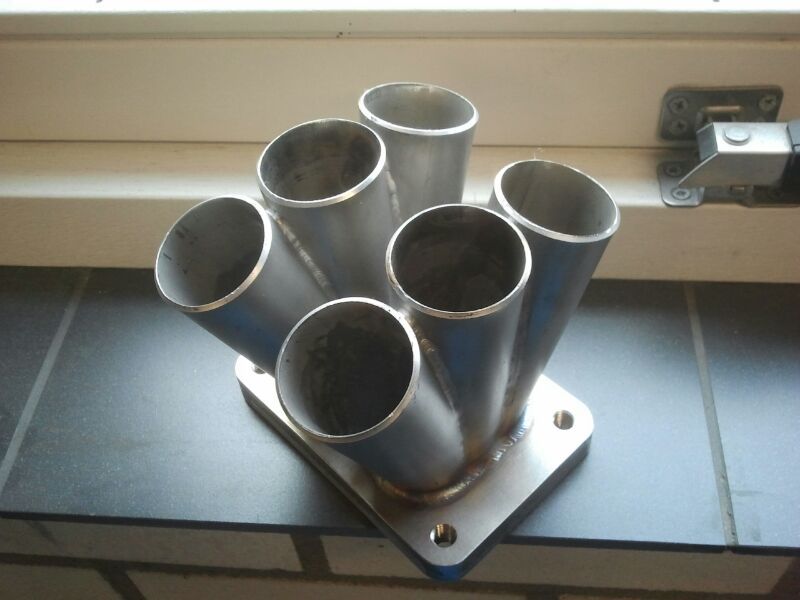

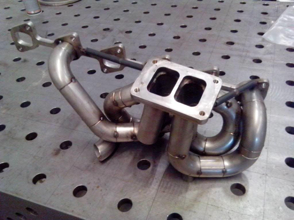

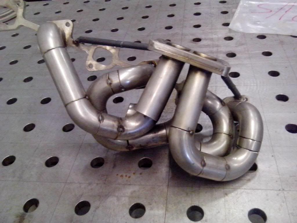

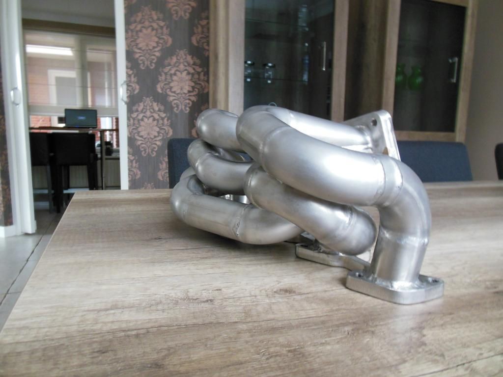

                    • Making my frist turbo manifold:

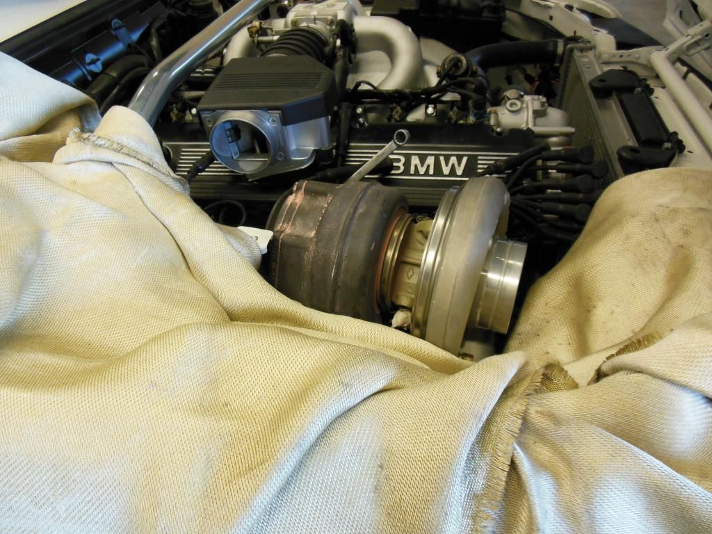

                      Searching a good turbo position:
                      After a long time welding:
                      onder aanzicht:
                      zijkant
                      bovenkant

                        • looks good, man. and great job on the manifold.

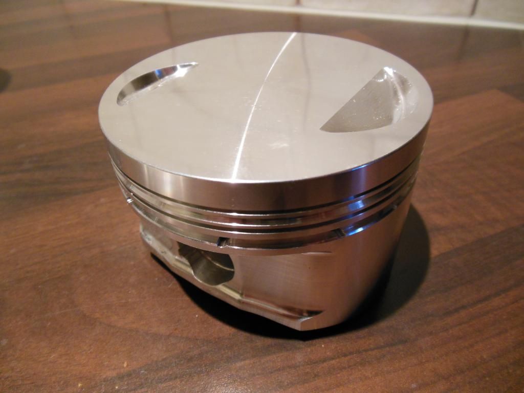

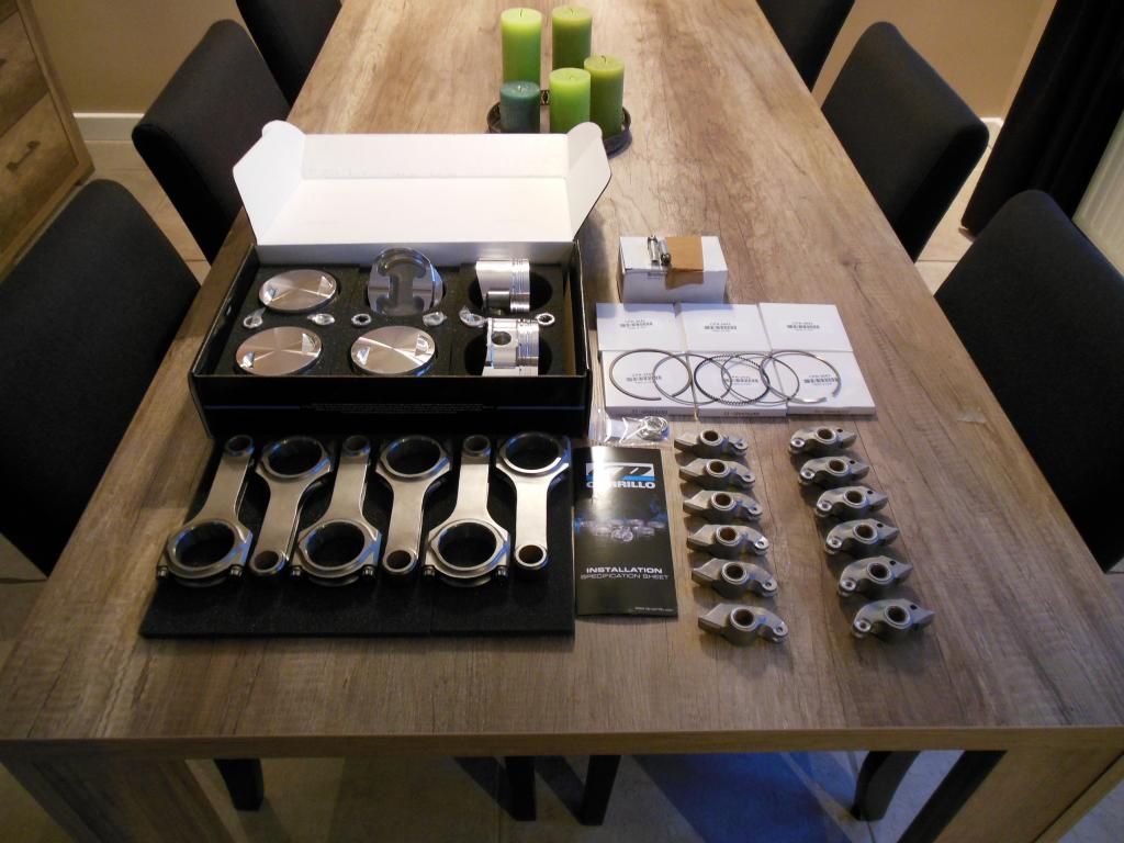

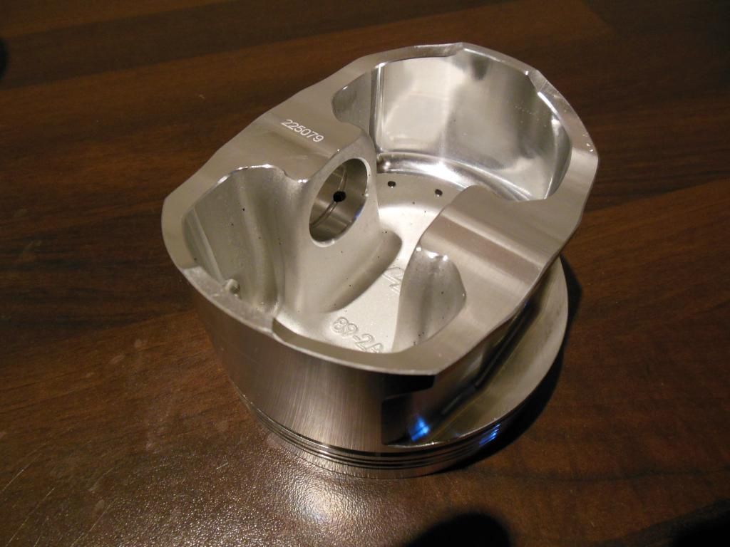

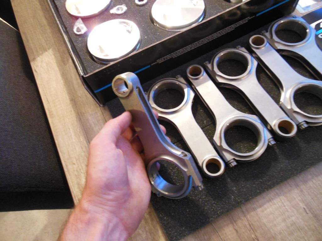

                              • New parts. Custom CP pistons 8.5:1 cr, 92.5mm boring. PPF H-Beam rods and heavy duty rocker arms
