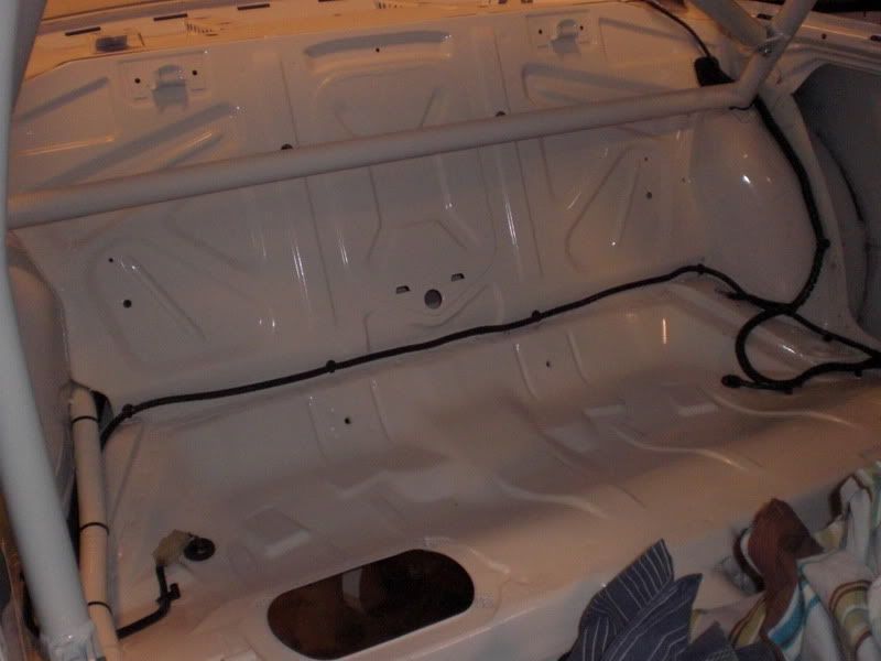

                      Here a few pictures during the building:

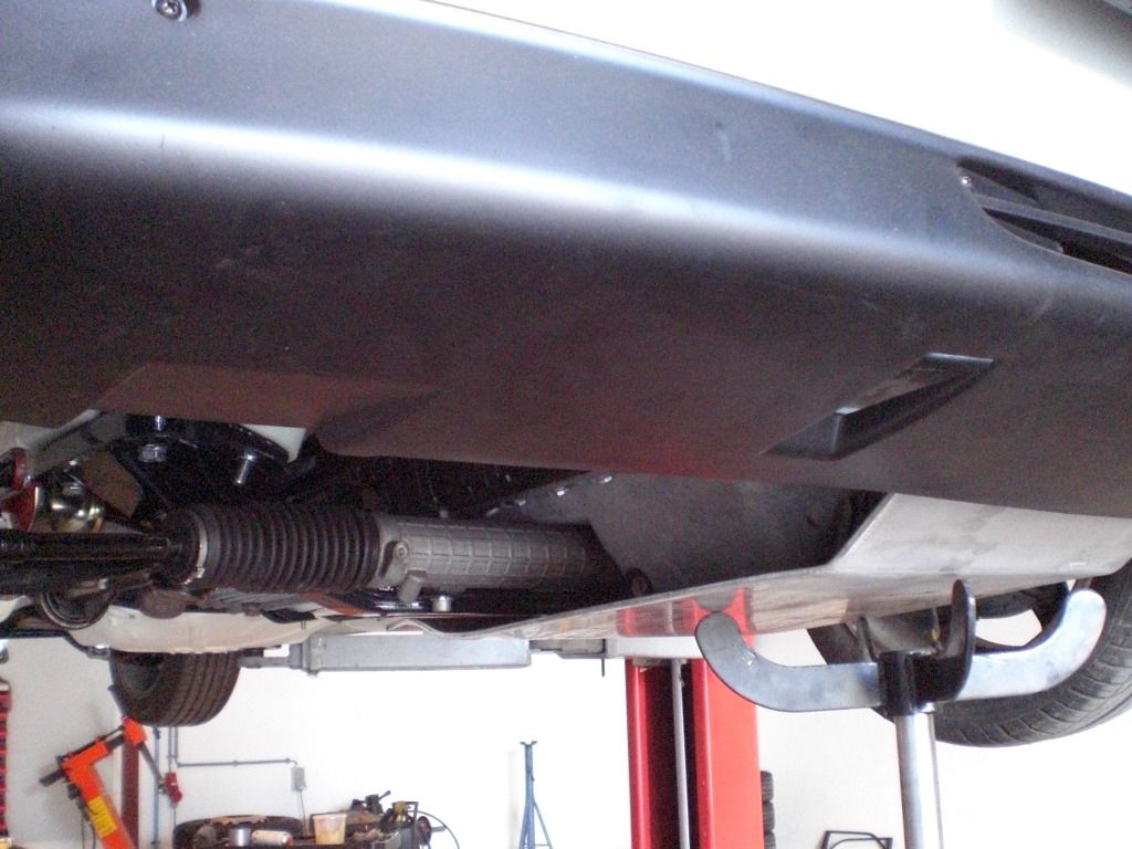

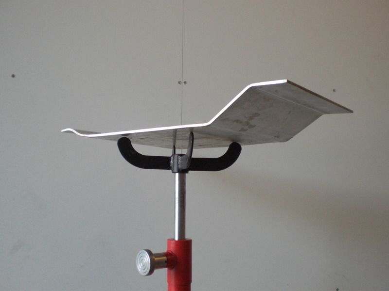

                      Homemade aluminium bottom plate:

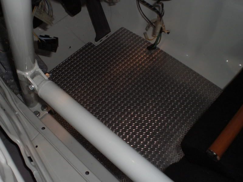

                      Homemade aluminium floorplates:

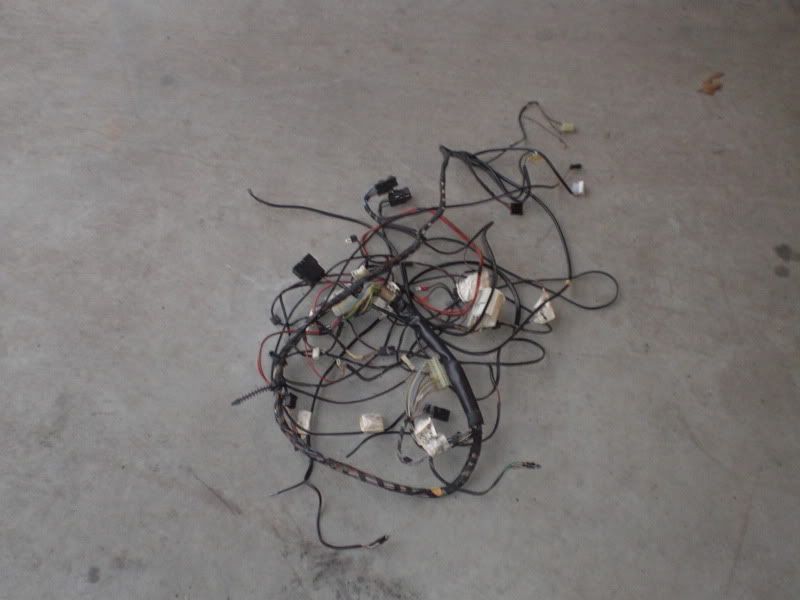

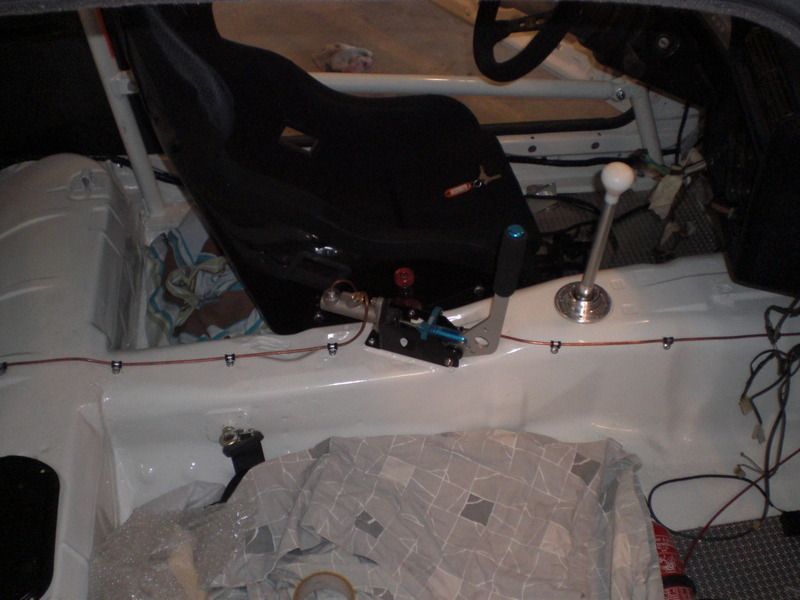

                      The wiring hoses and lines must be perfect
                      needless shit away

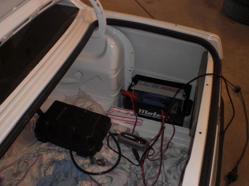

                      battery in the trunk:
                      battery + to the front

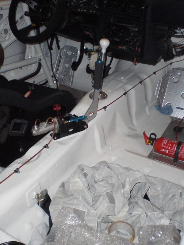

                      homemade brakelines:

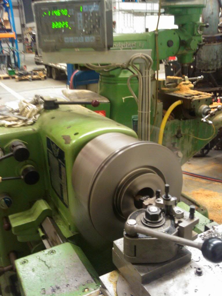

                      Homemade brakes:

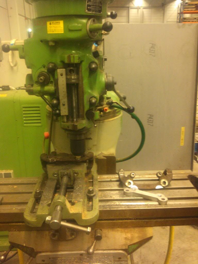

                      adjusting the Alfa 146 brake discs
                      Making homemade caliper spacers, and also adjusting the e36 328i Calipers
                      Cleaning the calipers, and after sandblasting completely overhauled
                      Here everything complete and new with EBC Yellowstuff, And then, we have 284mm brakes!!

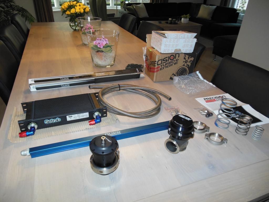

                        Nice, New porno parts for my turbo project are arrived
                        -Precision 46mm externe wastegate
                        -PPF 50mm blow of valve
                        -Nuke fuelrail
                        -Setrab oilcooler
                        Wastegate & BOV
                        spent enough this month, next month more
