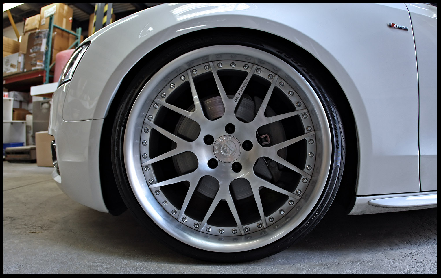

      Spacers will be made this week, along with a custom stud conversion kit. (damn you VW/Audi and your bolts)

                      Thanks. I do have another reason to add spacers. To make a nice big lip in the rear, the back spacing is lacking a bit and the spokes are very close to the brake caliper, which is a stock one, so that tells me if I upgrade the rear caliper to anything more substantial (RS5 setup), I will have a clearence issue. A 6~8mm spacer will solve that.
