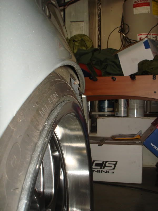

              So you don't recommend shaving then, is that what I'm gathering? I suppose I could rent a roller again. The tire sidewall rubs over bumps with the 10mm spacer. I already lifted the rear 1/8" to try and fix that but it still rubbed. I'll try and find a picture I took with the 10mm spacer. Wheel specs are 19x9.5" et 35. Another reason why I want the 10mm over the 5mm, so I can say I'm running M3 offsets at et25.
                No pictures with the 10mm but here are a few I took when I test fitted a 12.5mm spacer and it was that 1/8" lower. I would love to run that spacer but it rubbed like insanity! As you can tell.

                        Your setup does not look to be too crazy wide, its important to find where the tire is rubbing on the fender before you continue. chances are it will be near the 1 o'clock postion going back towards the bumper.
                        more fender rolling will not help much, you'll just curl out the lip and make it look ugly,
                        You can shave the inner lip very carefully and that should solve your problem, bigger bumpstops and slightly narrower tires are also an option.

                          Rolling them was definitely a btch. The sealant was a major pain and took me half a day to remove and I know I still have some bits in there. I'll look into the bump stops and dialing in more camber, but I just got an alignment a few months ago Where should I look for bigger bump stops? I'd rather not have to listen to the squeal of tires rubbing or eat up the side walls of my T1Rs. If nothing works I suppose I can just go with the 5mm spacers, at least I won't be rolling on Shevy wheels.
