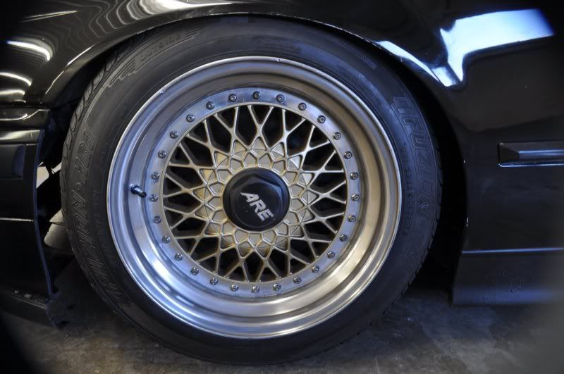

    Wheels are 16x9.5 two piece ARE's with 205/55/16 stretched. I forgot to measure for offsets before I put it all together. I used a 5/16" spacer so that the wheel didn't rub the coilover body and installed an extended stud kit to keep things safe. Coils are racelands, lip is from an mkIII jetta

                How low do you have the coils turned down?.. cause I am gettin racelands in about a months time ( fingers crossed ). I want that low haha

                    The rears are as low as they can go, take the adjusters out and you'll get another half inch.
                    Front is only about halfway down. The wheels are so wide that i had to strategically set it up so that the coil perch sits at the exact right spot not to rub the wheel as I didn't want any larger of a spacer. Other wheels will allow you to get even lower in the front, although this is completely impractical already.
