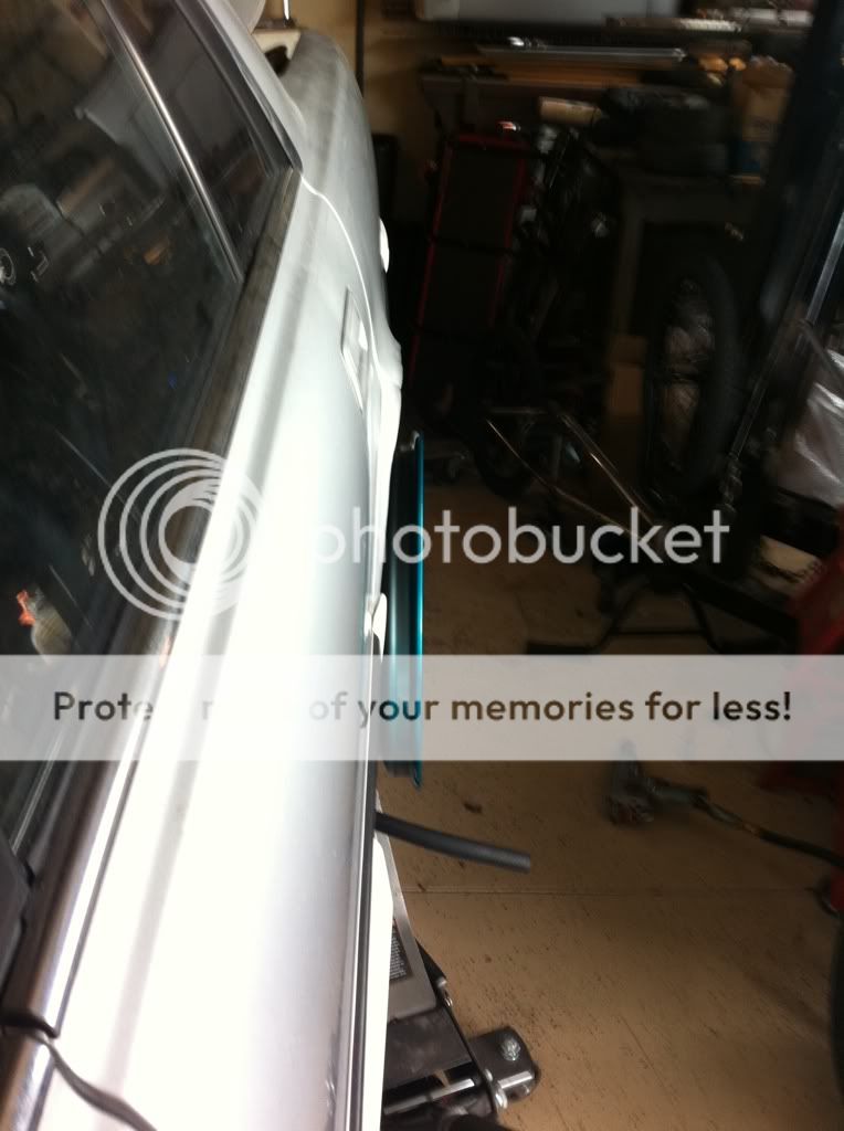

                  • got some more shit done this weekend... picked up my wheels from Cape Customs, 2 candy teal and 2 candy raspberry =)
                    then Kris got me side tracked and we wanted to see what the aero would look like mocked up
                    then we got working on the pedal assemblies... since these cars never came 5 speed i had to get creative... i used a clutch master from a 1990 celica gts, a pedal assembly from a mk3 supra... had to drill out the holes in the clutch pedal so it would clock the pedal so the top hole would line up with an existing hole in the car
                    then for the gas pedal i needed a throttle cable from a mk4 supra... so where the fuck would i find one of those in the upull around here lol... so i called up toyota and and gave them that part number and the cross referenced it for me and its the same one as an sc400.... perfect cuz there was one at the upull.... scored that and the pedal assembly just incase... it fit perfect on the stock cressi pedal except for the mounting bracket for the pedal... i needed the one off the sc400 so im glad a grabbed it... got it all bolted up and bam! 5 speed x8 cressida!
