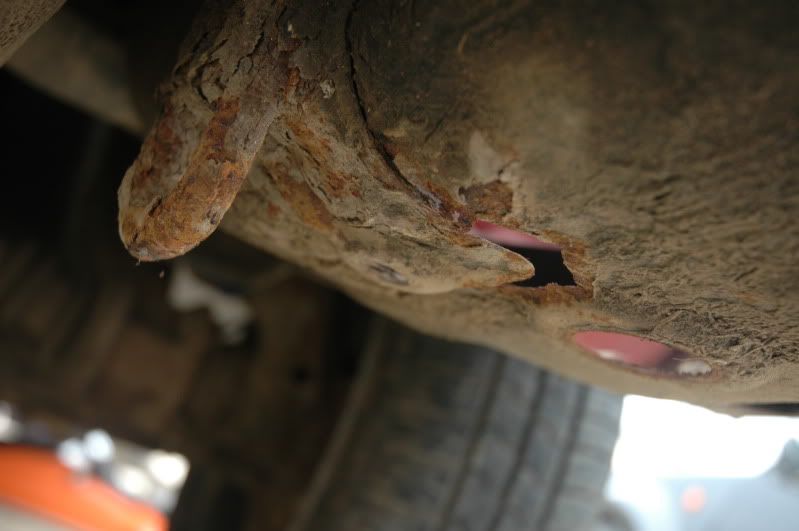

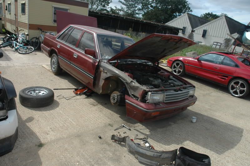

I also dove under the car to check the rust situation, the underneath is spotless apart from one spot around the rear towing eye thats left a hole so ill have to weld that and the bottom area of the drivers wing so im going to have to cut that off and re weld another piece on.

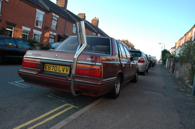

Anyway i was to busy with that and my breaks on the daily van deciding not to work i didnt get many pictures.
I got this one though quickly.
She'll get done.

After getting it out last weekend i walked around and dived underneath her to asess what to do for MOT.
One of the main things was the electrical issue but i draw the line at electrics as i am FRIGGING usless at it so ill drop it off to a mate for that.

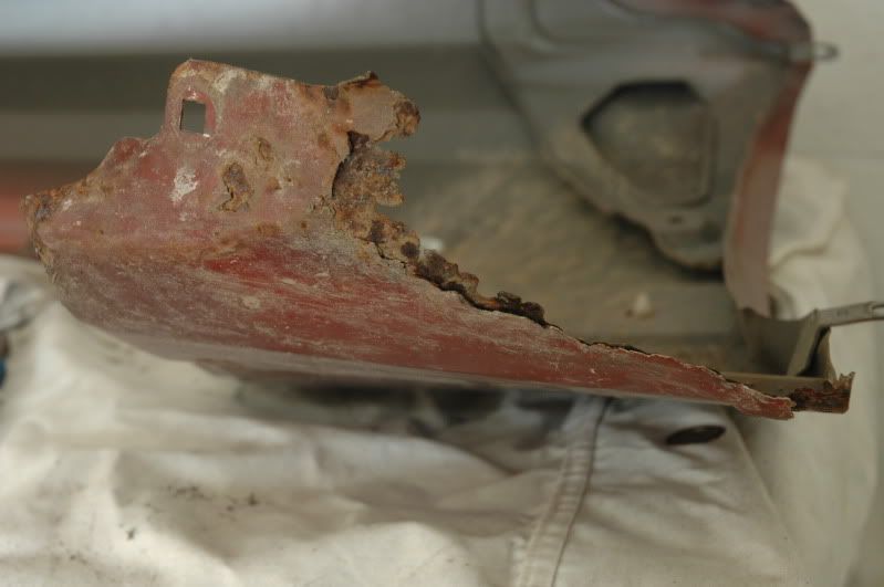

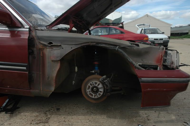

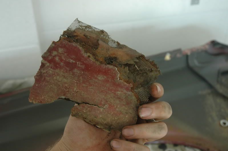

The other issue was some areas of rot which i found on the bottom of the drivers wing...
Nasty, but when i got it off it was a whole wing, where did that corner go...
Ah..oh dear.

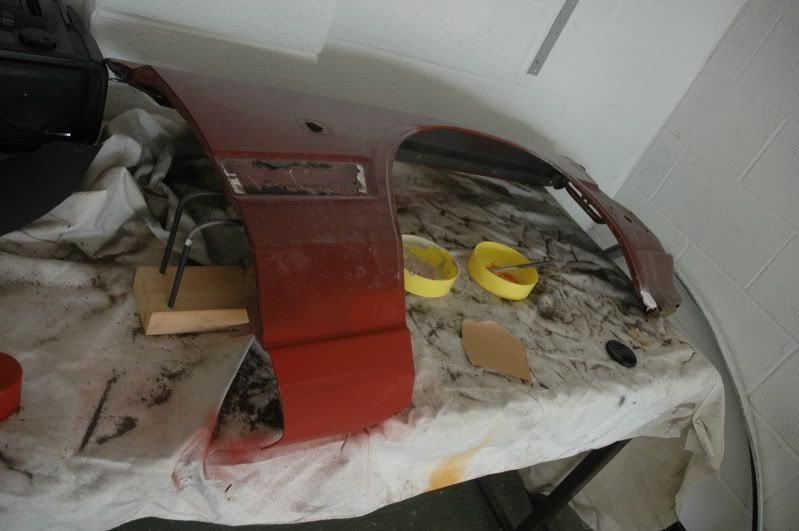

It would have been easier to get the new wing but because these are so hard to come by and being so old, new panels are hard to get hold of, esspecially since the norwich nissan dealership dont even seem to know they made one..

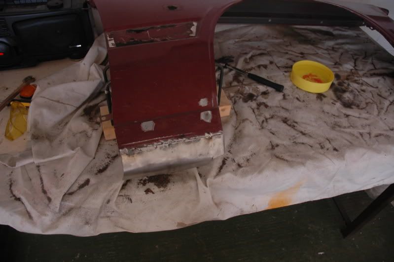

So i got some mild steel and set to work shaping it, after it was shaped i put the wing on the car and tacked it together so it was the same shape and angle as the original.
Then i did the usual, grind down, fill, smooth, fill again, smooth again, prime etc, just need to get the paint now but its easier to do the whole wing.
Not to bad.
The metal work underneathe the wing was quite clean though i found, so im going to give it a lick of underseal and leave it as is.

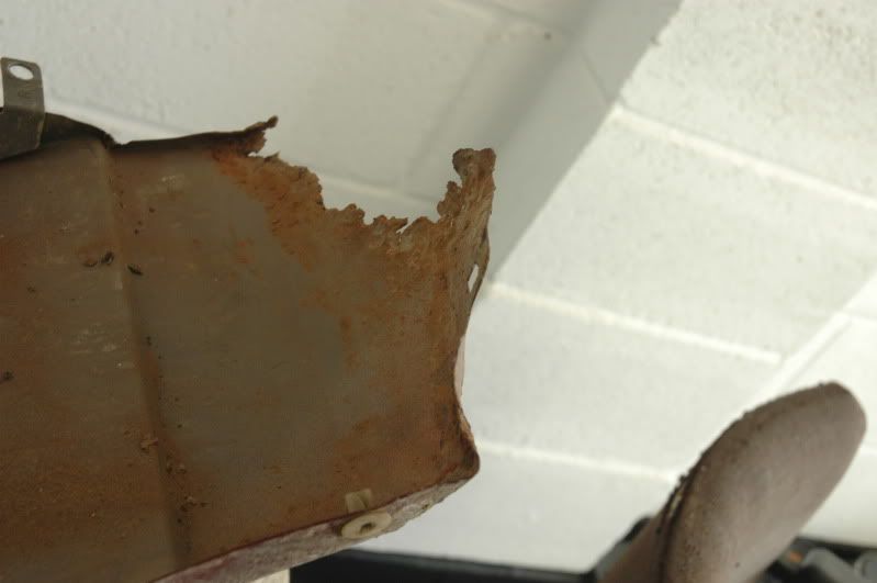

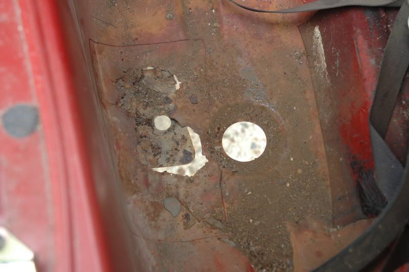

In the mean time i started to deal with the other rot hole i found in the boot.
So ive cut it all out and am now ready to weld it in next weekend.

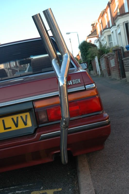

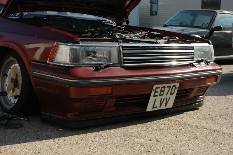

Before mod live though i installed HID's, my awesome boso exhaust and a new front splitter, my tyres were MENT to be in time for mod live but they never arrived so no new wheels for the show!

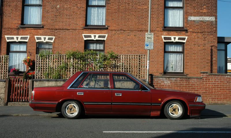

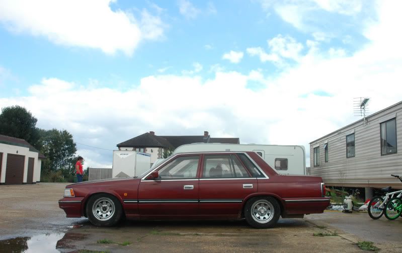

Well thats how she sat at mod live, i took some pictures a few minutes ago to show how shes sitting at the moment.

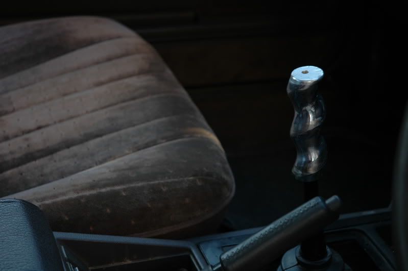

Everyone loves the dildo gearknobs nowadays so i went with a classic, this came off a 1920's john deere tractor and i machined it to fit!

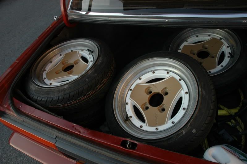

The wheels, painted a wrapped in new rubber just 2 hours ago, ready to go on when i have a spare few minutes!

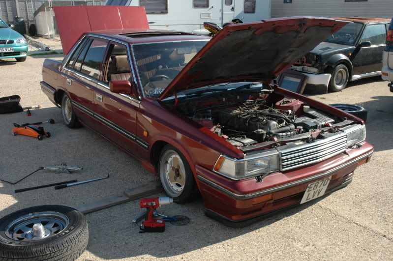

So, i put the advans on today and aside from them sinking it down about 30mm the wheels are MUCH smaller then expected!
So the rears were fine with how the suspension was dialed in, but the fronts had to come up 20mm, but sods law was i forgot my c spanners so out came the hammer and flatedge.
I got the car home from my unit which was a good 20miles with clearence on the lowest point being about 15 - 20mm excluding the splitter and suprisingly it didnt catch anything, so it MAY be suitable.
