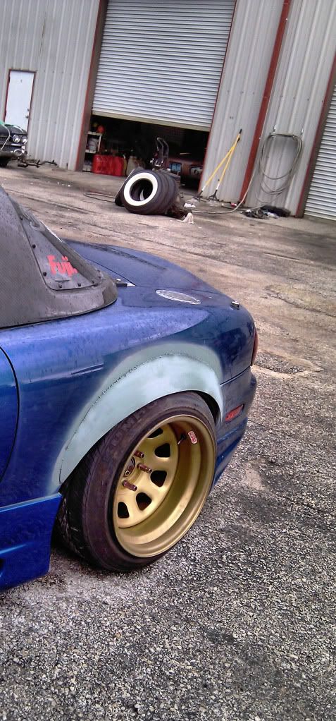

thanks man. i really want to do something similar to the flairs, but made out of steal, molded in super smooth.
miata re-fit, paint, and god knows what else...
I believe this is what your trying to achieve... custom welded metal fender flares made to look almost factory.
I have seen the build thread on this car, and while you wouldn't guess much fender work has been done.. quite a bit of metal has been added to give the flare that much extension.. methinks you are about to embark on a similar journey to obtain the fitment you seek.

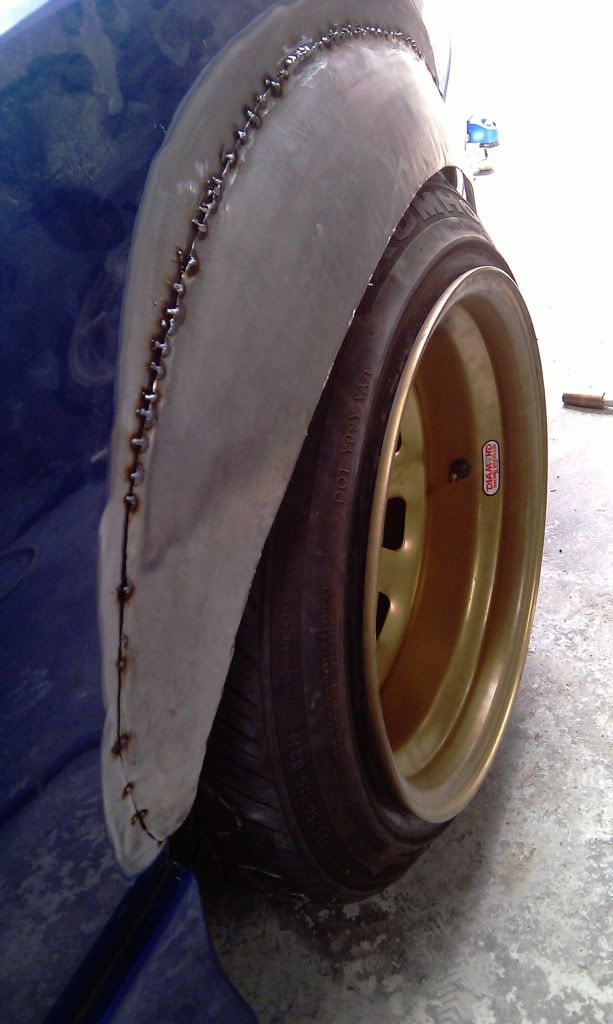

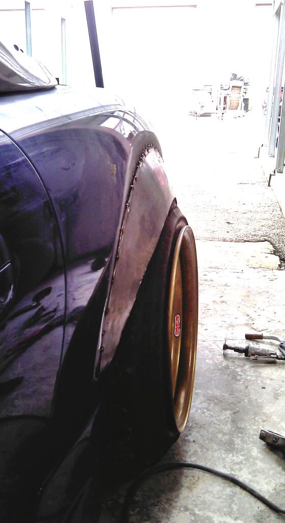

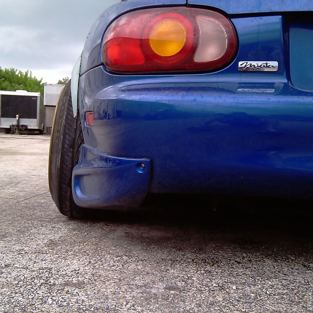

note: the bottom of the flair where it meets the bumpr will get trimmed and fit with a stud on the back side of the flair to pull it in tight. also there will be a 1/8th inch rod welded on the outside of the flair so it has a nice round edge.
