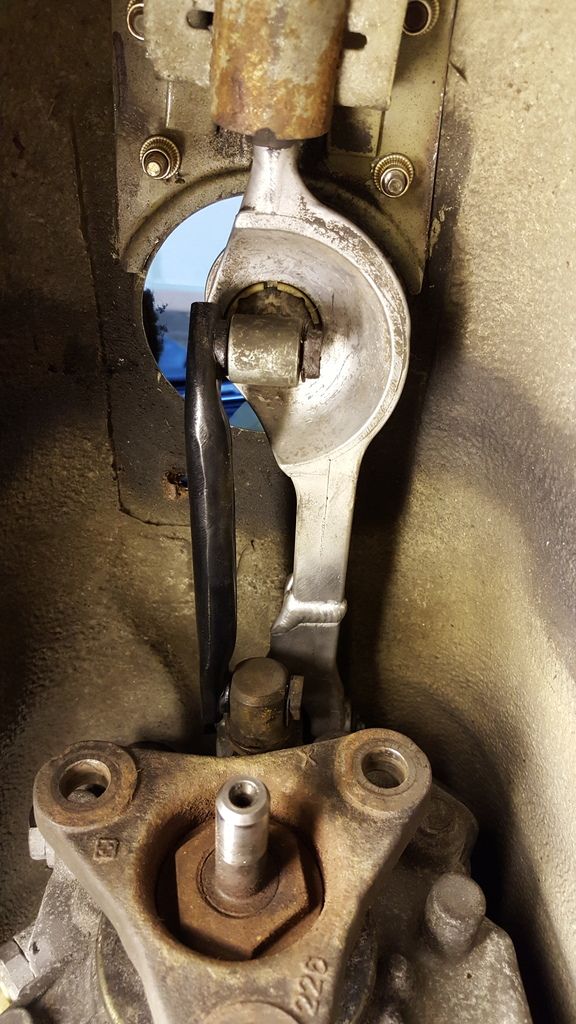

                            The next custom parts I had to modify is he shifter assembly. The factory E39 shifter is much to long, so the best solution is the cut down and weld the pieces shorter. Below is the chopped and welded shift carrier.
                            The shifter selector rod also cut down, sleeved and welded. Its a short lil guy
                            Assembled on the car, the shifter is nice and centered in the shifter hole.
