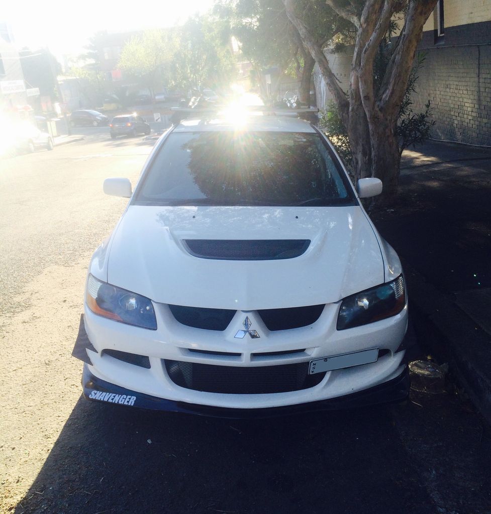

    and I got a set of IX headlights and did a didgy fix of the front lip with a little paint and a sticker, until I get a new one at least, I am still hesitant of dropping much coin on something that will no doubt get hammered.

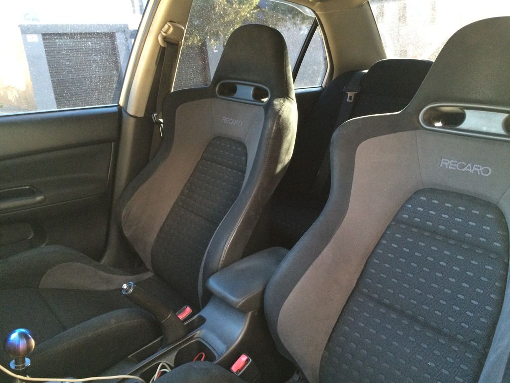

      Few pictures of the interior colour change. So happy I went through with this, makes the interior feel so much better. Wasn't a fan of the blue on the doors and seats at all. Now it's all black.

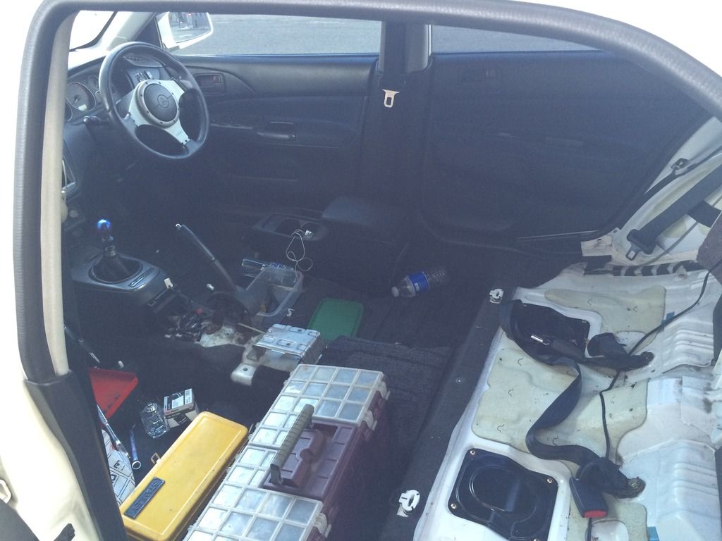

      Pulling everything out and cleaning up all the shit left behind by the previous owner..

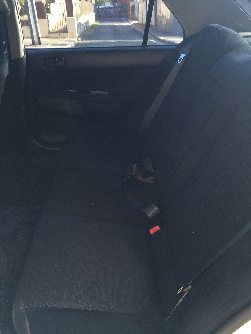

      Masking and applying the fabric dye, took my time here to make sure it was neat, made the final product look factory.
      All done and back in the car, if anybody wants any tips on doing this there's a few tricks I used to get it to turn out the way I wanted. Feel free to ask.

                  Hey, i'm in the same situation with the seats on my subaru. I **** the blue. What type of dye did you use to change it to black? And did you apply it in light coats or heavy coats? Also i really like this Evo. I woulda bought one instead of my subie if i woulda found one in decent condition hahaha
                    Thanks mate, the blue on my seats was a little faded and now they look nearly new again, same with the rest of the interior. I used dupli-colour dye in an aerosol can. Just over two cans for good coverage and I did the front seats, rear seats and all four door trims. Couple of tips, get some baby wipes or dryer sheets and wipe them down once they are dry, this will dampen the material slightly and soften it up as well as take some of the smell out of them. Other than that it's probably one of my favourite mods so far, if I didn't tell you it had been done you wouldn't even notice and you definitely wouldn't think it came out of an aerosol can.
