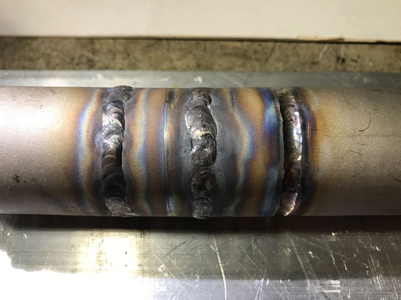

So I promised weld pics, and there are some, but they aren't fantastically exciting. Mostly dialing in my process for the best results using the 321 stainless.
This is my first 3 test runs on this material, the middle is #1 with minor cleaning and too much heat. Left side is run #2 with more cleaning and a little less heat. Right is #3 where I've run a fusion root pass, which turned out pretty damn good since I cleaned everything thoroughly and really watched my heat input. Below you can see on the right run where I ran a second pass with filler to finish it off. None of the welds have to be wonderful stainless rainbows since this manifold will be getting titanium heat wrapped anyways, the important part is that they're solid and strong. That's why I'm using 321 alloy to begin with
I'm happy to see that I'm headed in the right direction with all of my adjustments. One more small set of changes and I'm confident that I'll be set up for success. Recently my free time has been a little fleeting.....

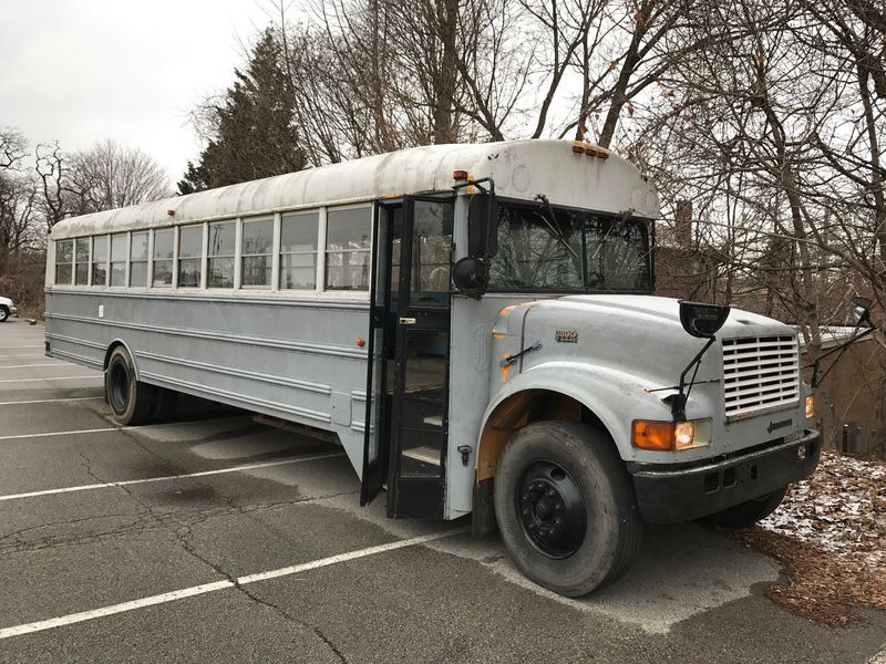

Long story very short, my big news is that my wife and I are moving back to San Francisco, we'll be there in mid-late March. Bummer that the truck will go into storage until we buy a house, but NEVER FEAR! I'm remaining optimistic on that front, and super fucking excited to be going back. I'm currently converting the bus into a full tiny house, I may throw a few pics of that up just for shits along the way. Until next time folks.....
