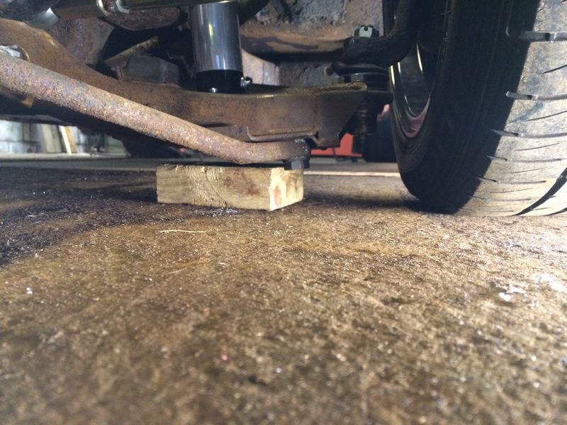

            Small update, I went back to pissing with the torsions some more. Trying to attain that stiffer and lower setting I know is lurking about, I think I'm pretty close. Bolt heads on the bottom of the LCAs are about an inch off the ground, I'll most likely build new stabilizer arms for the short term but I've also just started designing custom drop spindles with more correct drift geometry. That'll also include tubular upper and lower arms. Chunk of 2x4 thrown in there for reference. New spacers are on the front now, I'll need to roll the lips more and getting 205/55 soon

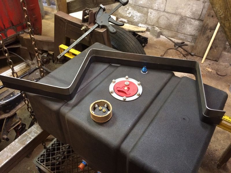

            Fuel cell location. Will sit a few inches lower than that actually. Anybody have some insight on why you aren't allowed to run a rear sump fuel cell in D1 competition? I read that on a tech site somewhere I think. Guess I won't be trying out for the big leagues in this

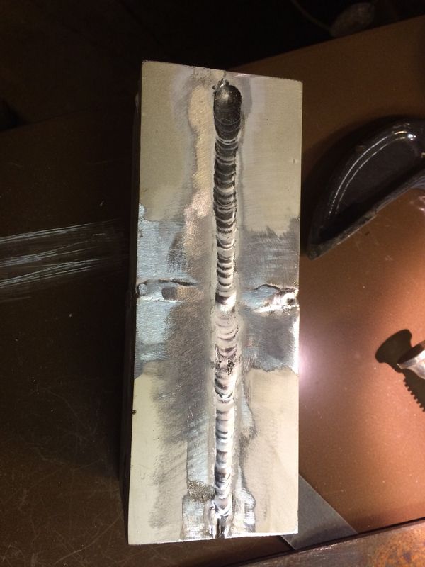

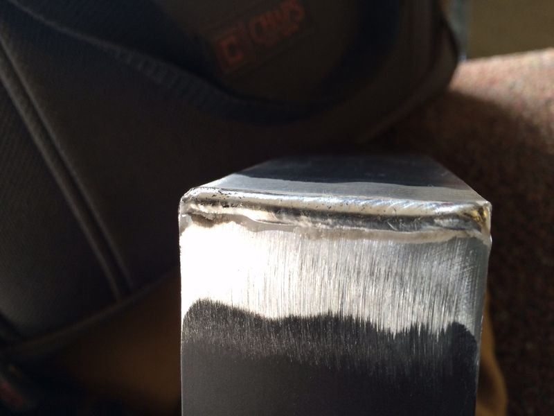

            Been getting a little time on the new TIG machines at the shop in my union hall, stainless and aluminum. Whipped out a bunch of good welds on the first go. First one is fusion welded without filler, second is with filler. I'll be trying out titanium as soon as I can afford it.
            Alumi-love

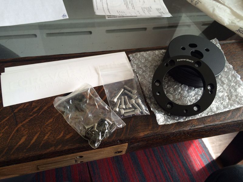

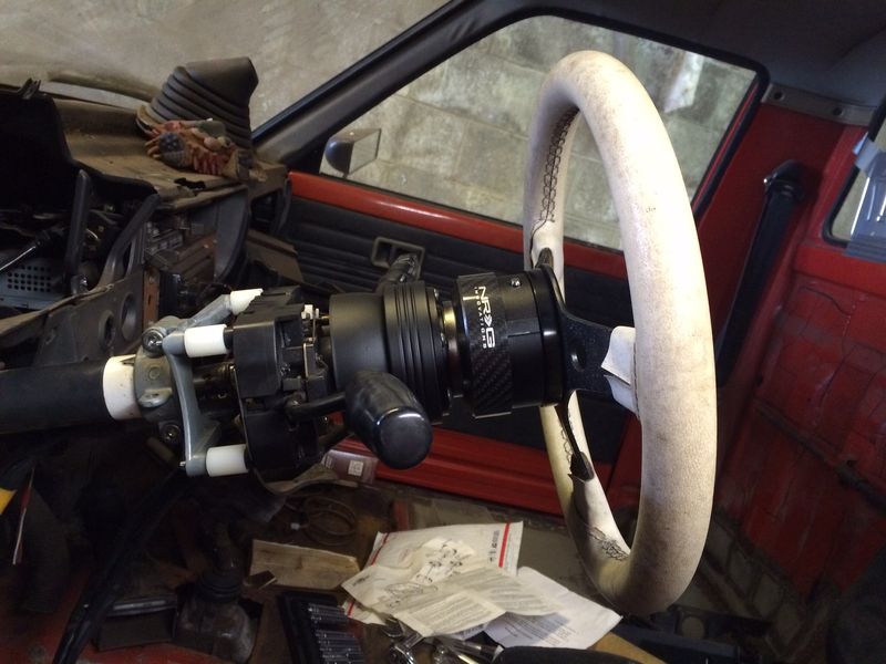

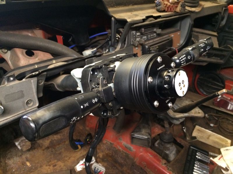

              But I did some shit. Got my adapters in the mail to mount up my steering wheel and quick release. I was just going to make the adapter plates myself, but ended up finding a guy in California that does it, so saved me the time

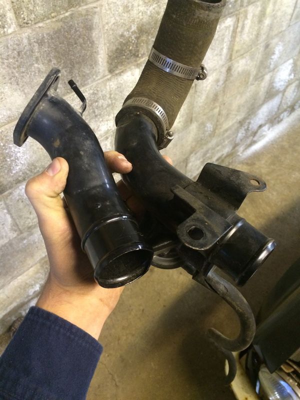

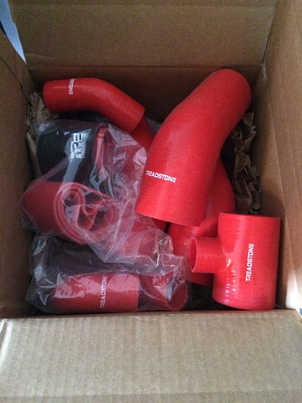

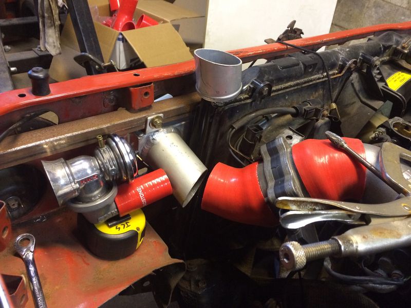

                Got my silly-cone couplers in the mail finally, so got out the razor blade and started fitting things into place. Had to cut the intercooler outlet down and I'll be fitting that back up with a kink in the end to meet up with the coupler. Will also have to add a 1" stub pipe to run my BOV before the air meter, you can see roughly were it'll be in the last pic. I so badly need a TIG welder in my shop
                The compressor outlet from the evo turbo is not oriented correctly, but I found that the old intercooler pipe from the eclipse is made of the same exact kind of pipe so I'll combine the two to make what I need

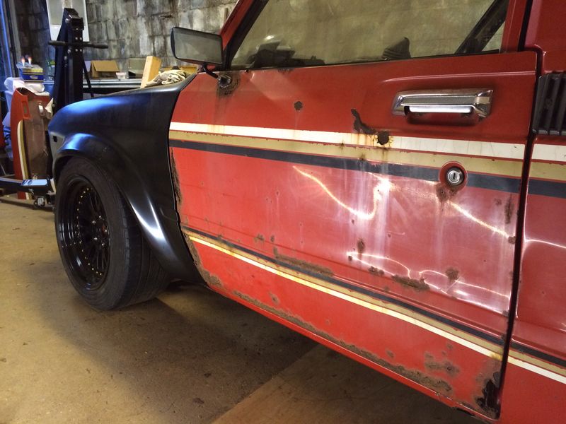

                I crawled under the bed of the truck to check out where I was going to attach new bed mounts to and realized there's no way in hell I can keep the existing bed floor, the rust is insurmountable. Worse than Swiss cheese. So I've decided to make a new one raised up 3" instead of making a false floor to cover the shitty one that's there.

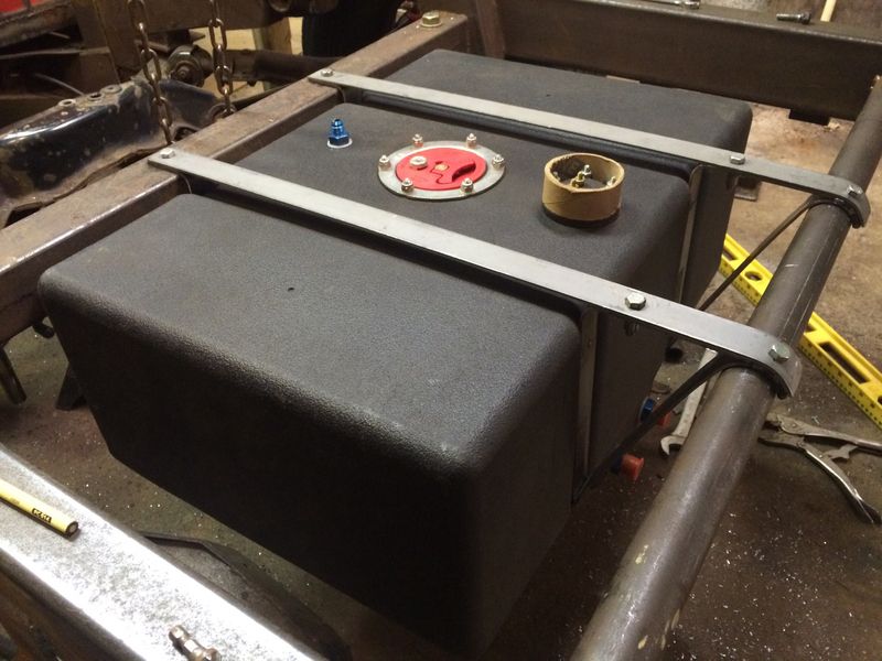

                  Mounted up the fuel cell finally

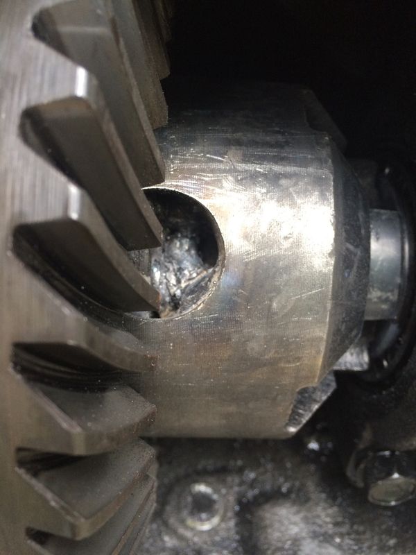

                  Welded up the diff

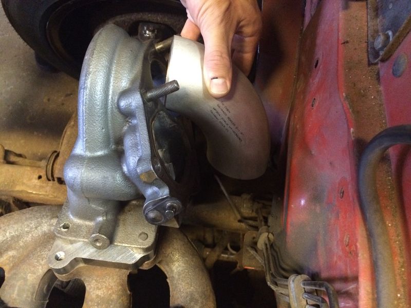

                  Decided that clearance for any O2 housing was going to suck to fabricate for, angle way to sharp coming straight off the turbo

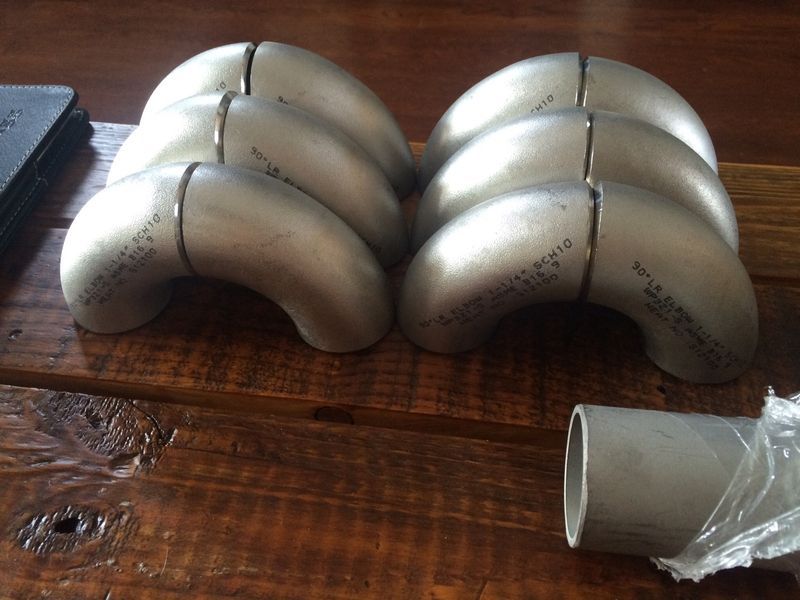

                  So I said piss on it, I'm building a new turbo manifold too. This way I'll pretty much be able to orient and locate wherever I please. 321 stainless weld els and straight pipe, also head and turbo flanges not shown

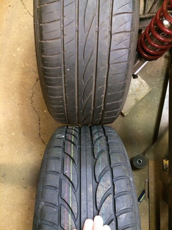

                  New pair of tires all mounted up for the front, 205/55/16 Achilles ATR sports. I'll be getting more of these in the future I think, I've been reading a ton of good things about them for drifting

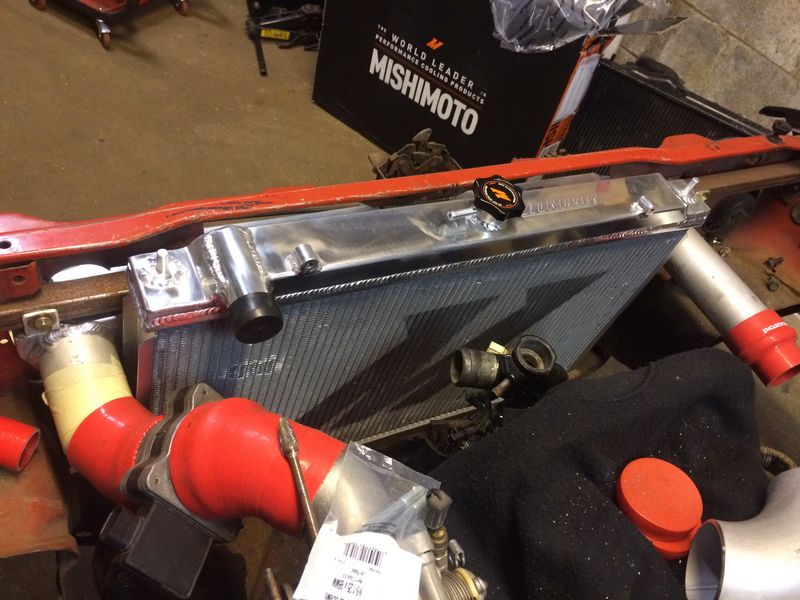

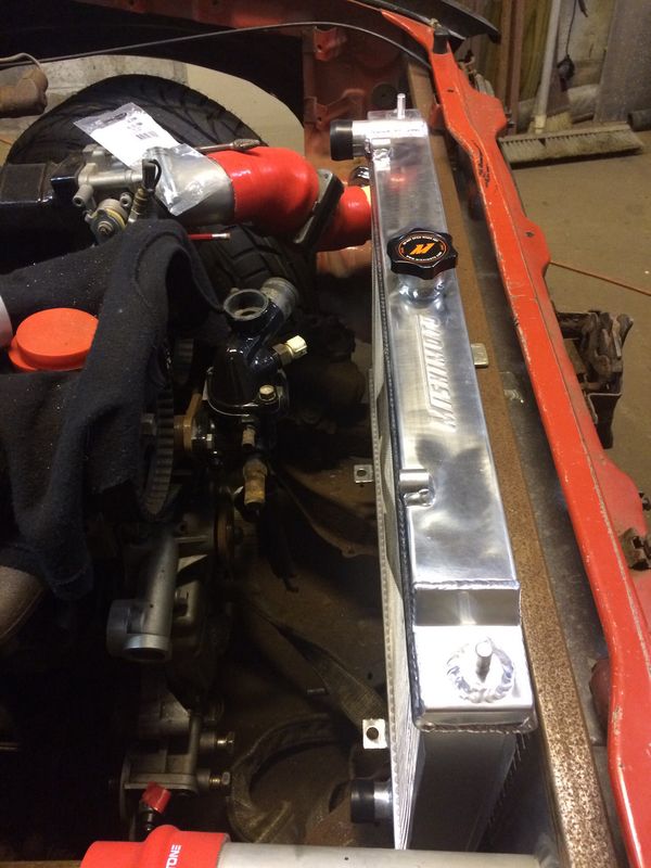

                  Grabbed up a mishimoto X-line rad from an s14 w/ sr20, thanks to the summer sale at enjukuracing. I'll have to re-fab the lower locating points but the inlet/outlet position of this one is perfect for this motor swap, and it's almost identical in size to the stock eclipse rad so it fits right where it's supposed to. I'll be running one 14" mishimoto slim fan as well

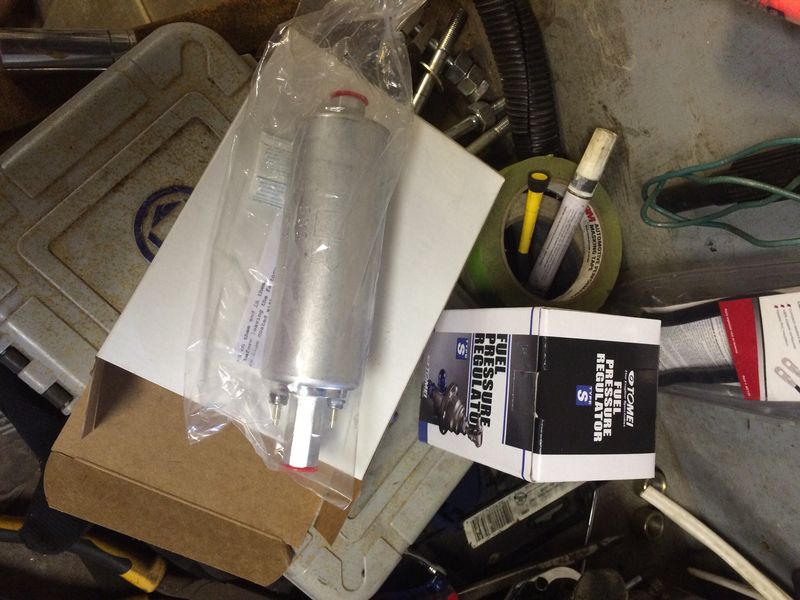

                  FPR and walbro 255 are waiting to go in, still need to order my AN lines and fittings

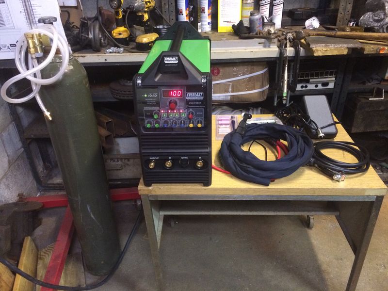

                  Finally bought a TIG welder
                  I'm getting all tooled up with stupid amounts of new gear and supplies for a fully stocked set up, but took a little time to set it up initially just to dial in for some aluminum. First pic is of fine tuning settings, second pic looks like I'm ready to wrap up that intercooler

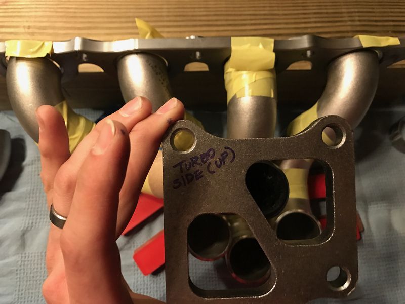

                            Decided to get off my ass and build something today, so started the turbo mani fab. Pretty much finished getting things routed/planned, next step will be cutting the few parts of straight pipe and knocking one of the elbows in half to replace the paper towel roll and plumbing elbow Lolz. Then I can do the fit-up for the oddball merge collector.
