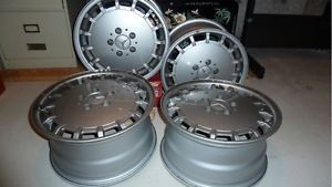

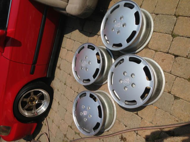

      So dropped some cash tonight and picked up two sets of wheels.
      Both are 16x8
      Going to have to sell one of them so i need help choosing whats best, could somebody do a shop maybe??

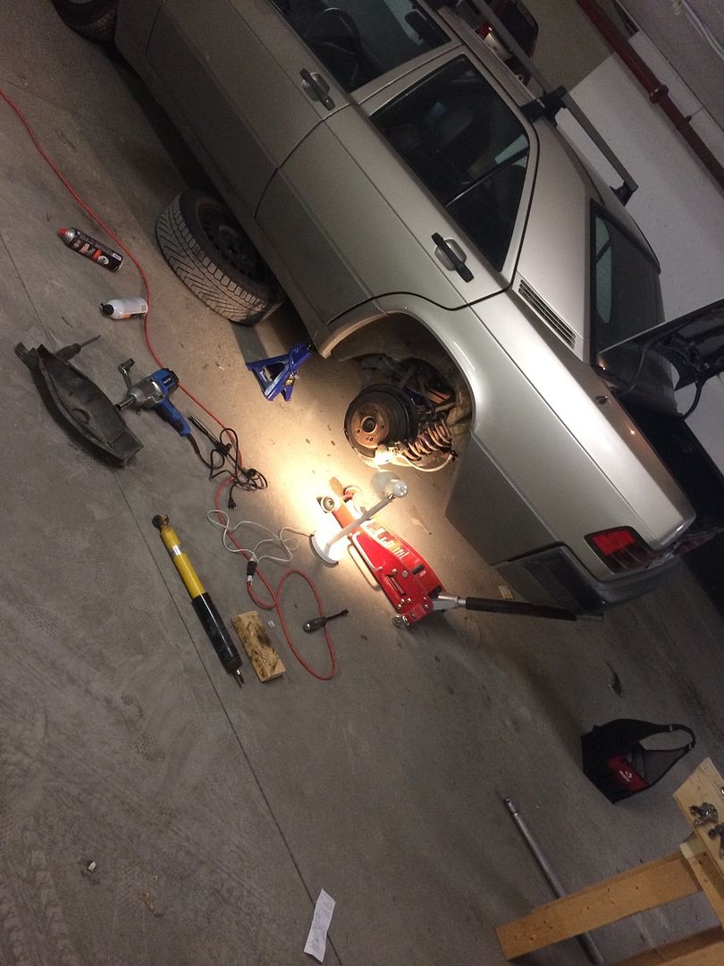

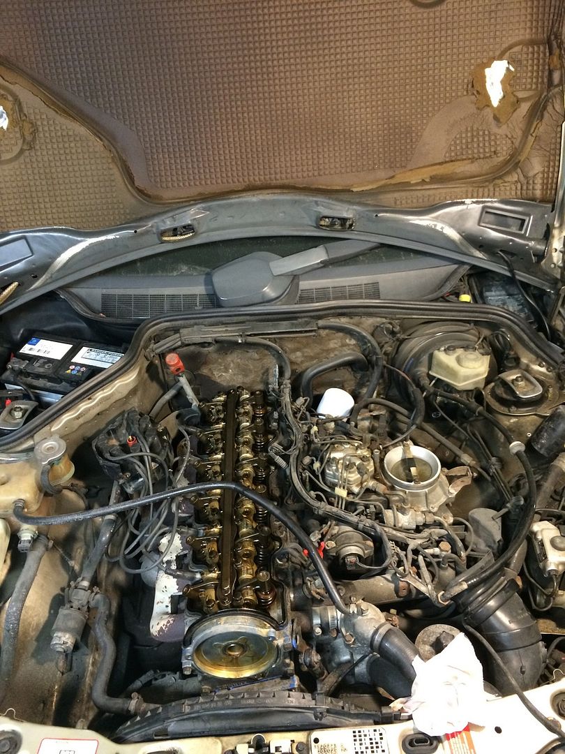

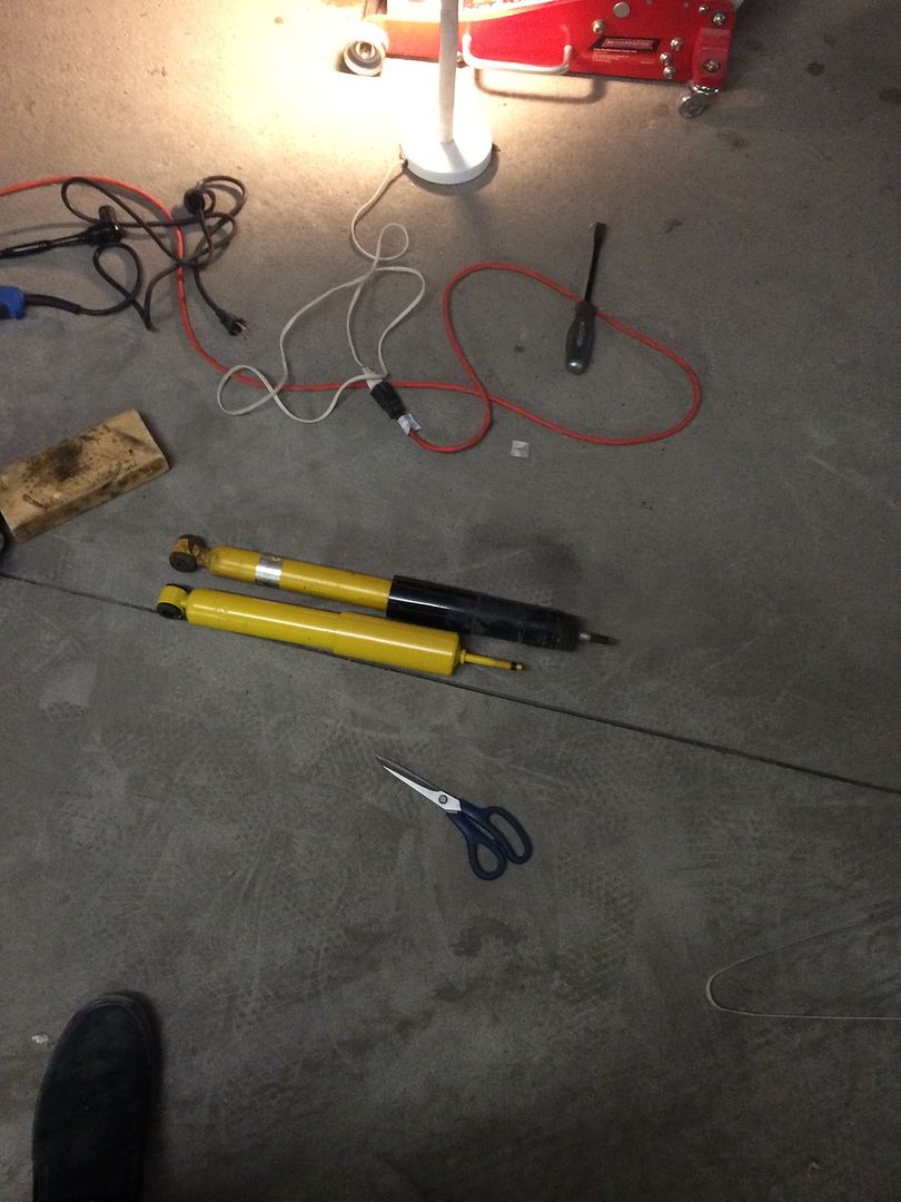

                      So this weekend I did the upper timing cover seal
                      Then attempted to lower the rear with 95 ford ranger shocks and see if I can solve the clunking
                      Well that didn't work because I need shorter springs than the vogtlands to get the shorter shock in there

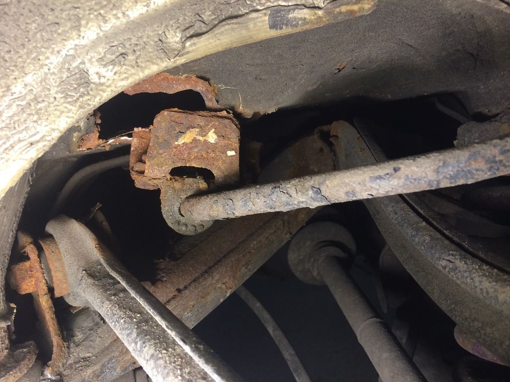

                      Then I found what the rear end clunk and rattle was
                      Yeah rusted and broken sway bar mount, so fuccckkkkkkk I need to get that welded up now
                      So now I'm here waiting for the next move
                      Any ideas to Lower the rear to even it out with the front, cut a coil or two? Or use a diff spring and shock combo ?

                        Hey so I'm looking to chop the rear springs. Take em out and cut them or leave them in and go to town with a angle grinder?
                        Never argue with an idiot. He'll drag you down to his level, then beat you with experience.
                        • #27
                          Def get them out first. Unless you want to die ofcourse.
                          Seriously. The pre-load on these Benz's springs are deadly
                          If you want to remove them without spring compressor, read the following:
                          =Rears you can get them out by disconnecting the swaybar links and the inner joint of the LCA's.
                          [ame="http://www.youtube.com/watch?v=IAE2kWaHL7U"]https://www.youtube.com/watch?v=IAE2kWaHL7U[/ame]
                          =Fronts are a bit more difficult. But still doable.
                          Disconnect sway bar
                          Remove the complete strut
                          Push down the FLCA and carefully try to blip out the spring with a crow/pry bar.
                          It may seem impossible, because of the pre load, but if you push down the LCA as far down as possible you should end up with just half or less than one inch of pre load. That should not kill you.
