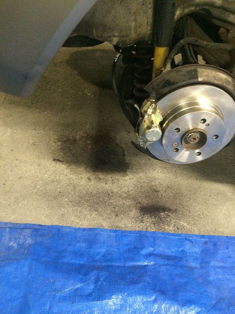

                              Did some maintenance today, mainly brakes
                              new ate front and rear calipers
                              new flexi brake hoses all way round
                              pads and disks all way round
