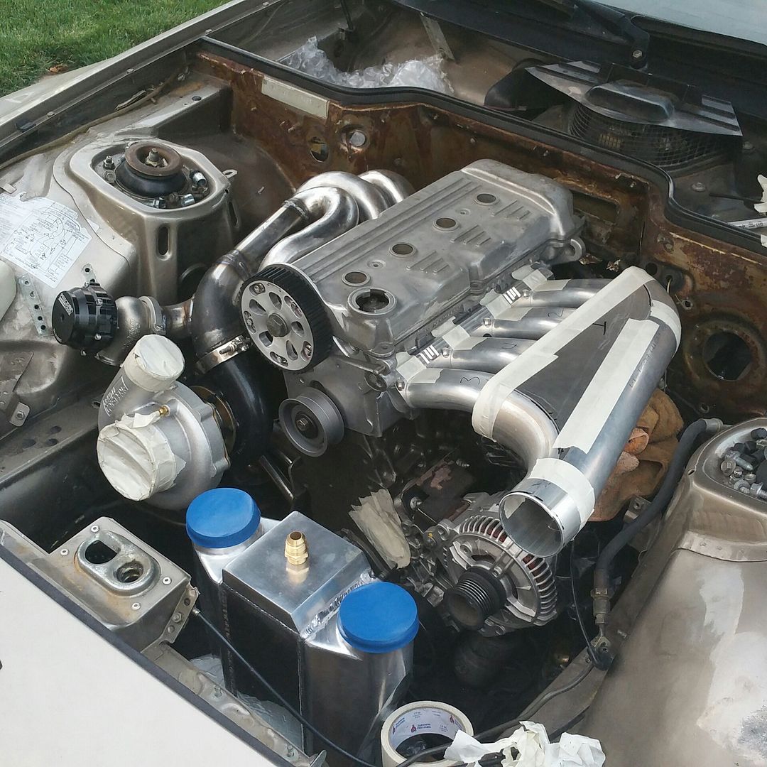

    Thanks guys! This has been a fun build so far.
    Originally posted by Whiskerz View Post

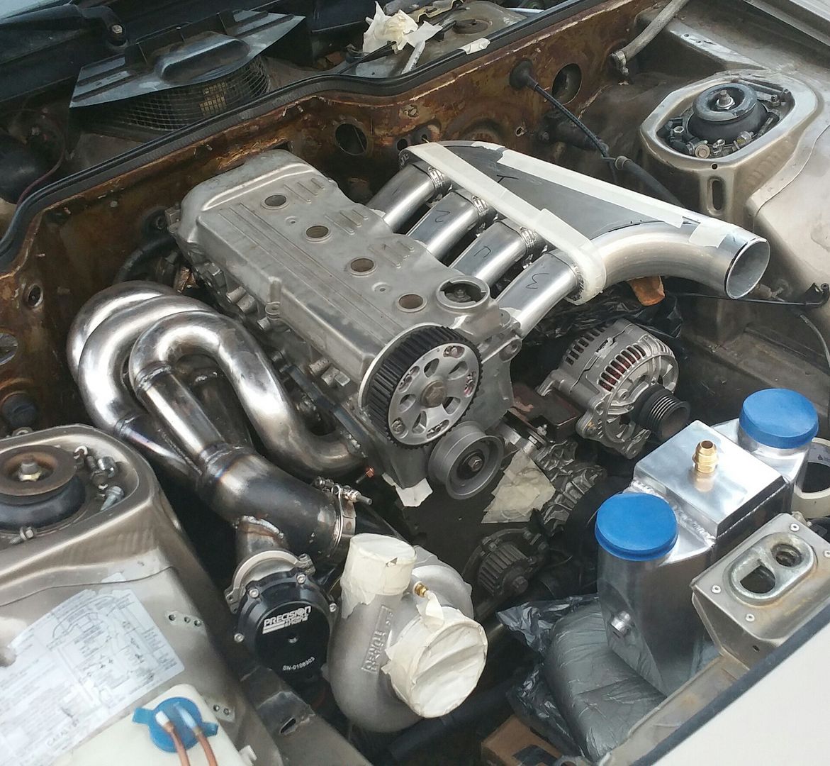

    Solid engine mounts are gonna make this vibrate like a bi-atch when it's running haha .
    They have poly bushings on the frame rail side of both mounts. They aren't solid, but I do have to agree with you about it vibrating a lot. I am expecting it. haha

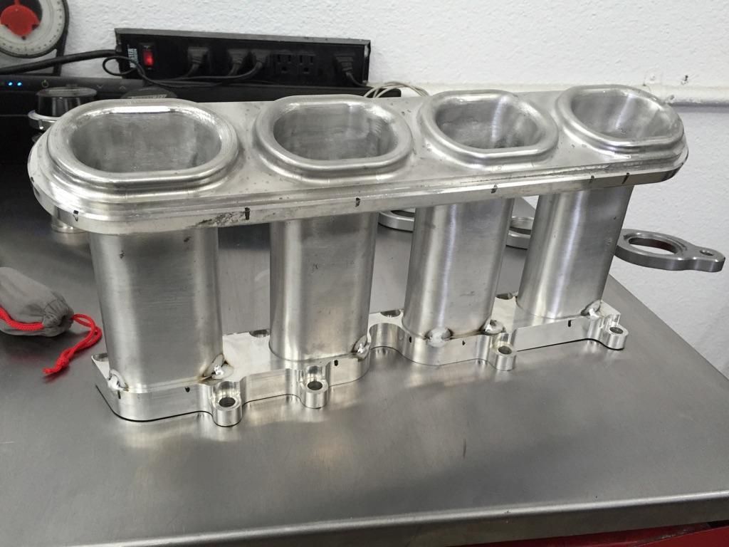

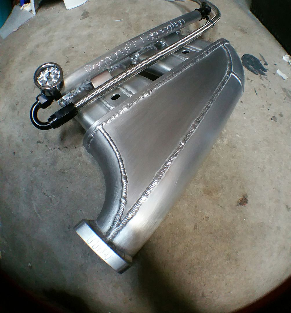

          Had a chance to make a little intake manifold progress.
          Ignore the numbers on the runners. Their original positions changed.

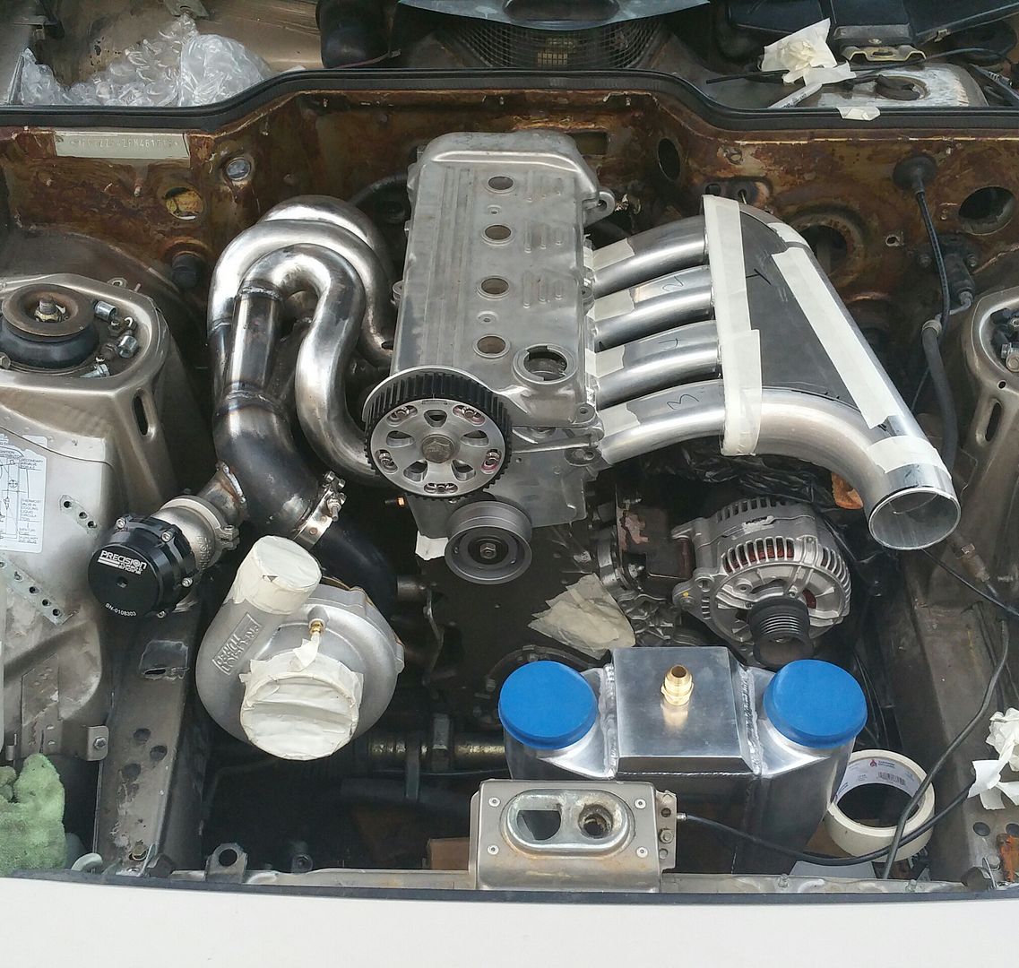

          • #20
            Cool build ! bling factor 10x for the intake and the exhaust.
            I would also fabricate some support bracketry for both manifolds.

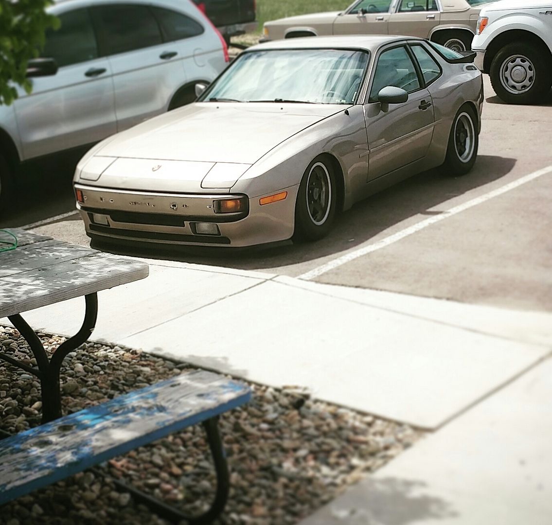

                Thanks for the compliments! I have plenty to learn in world of fabrication. I always like a good challenge. Body work is my next passion. I can't wait to get to the paint prep and spraying portion of the build. I was just about to get started on it when the pan busted.
                I definitely plan to brace the exhaust, haven't really thought about the intake. I will make it happen too. Thanks for bringing it up.
                I have been missing the thing a lot lately. Looking through picture of it right before the incident made me want to post these.

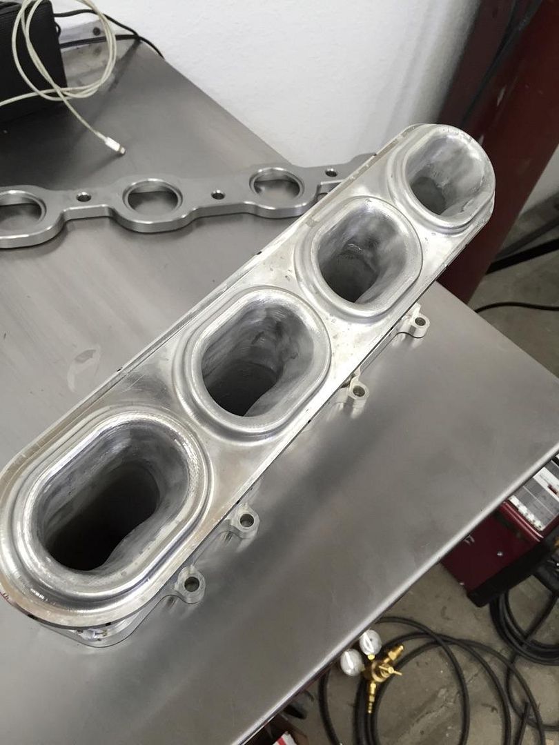

                    Manifold progress
                    Smoothing the transition from the plenum bottom into the ports.

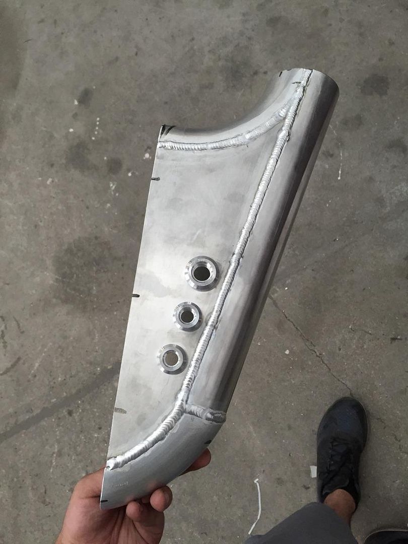

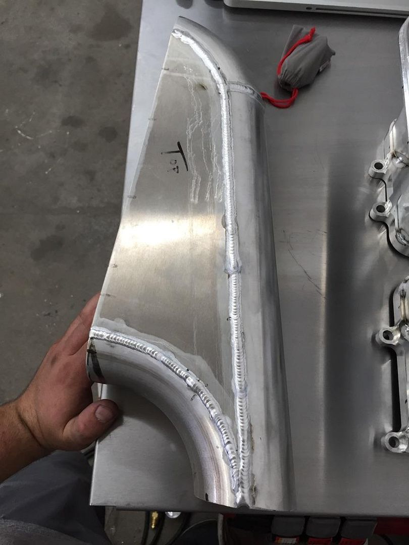

                          I have been busy with work, but did get this back from the welder last night. I did a quick clean up and bolted the rail to it. I can start collecting the rest of the parts for the fuel system and intercooler/piping.
                          I am building an addition on my garage. It will be getting cold here on CO sooner than later. This will give me a place to dig deeper into the build through the winter. I am going to move forward with a full custom restoration. Finishing the motor and components come first.

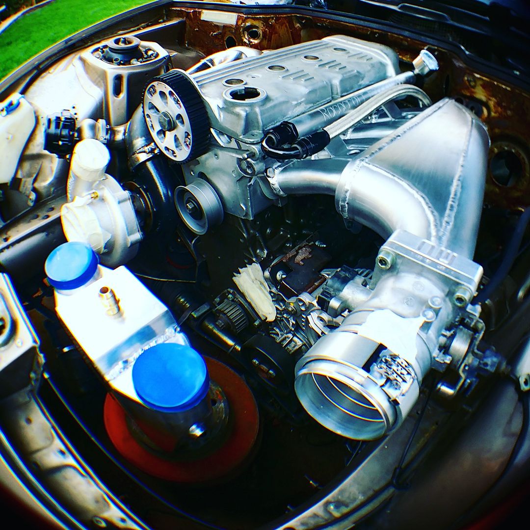

                              A picture from today. Yard work claim most of my day.
