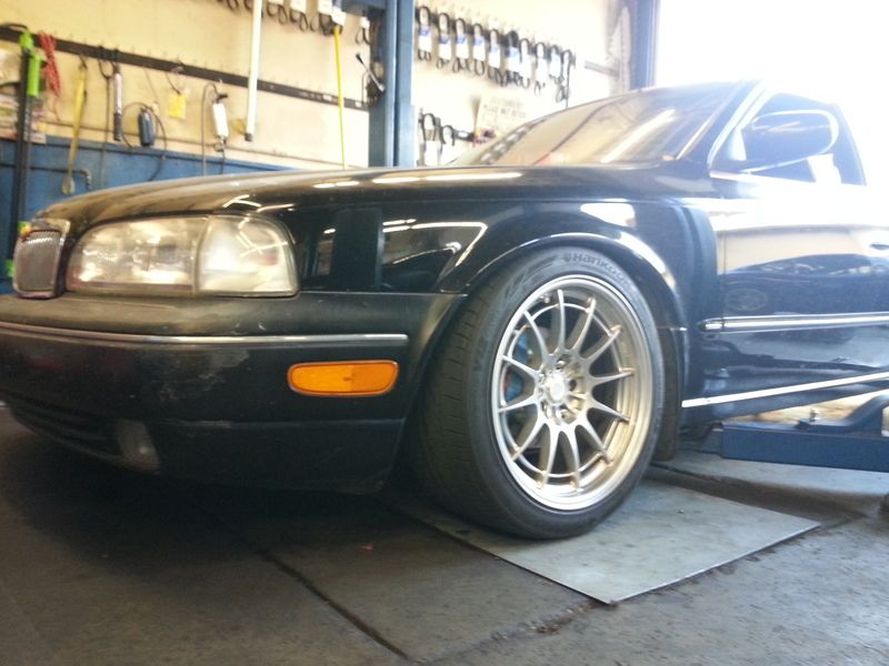

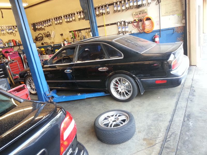

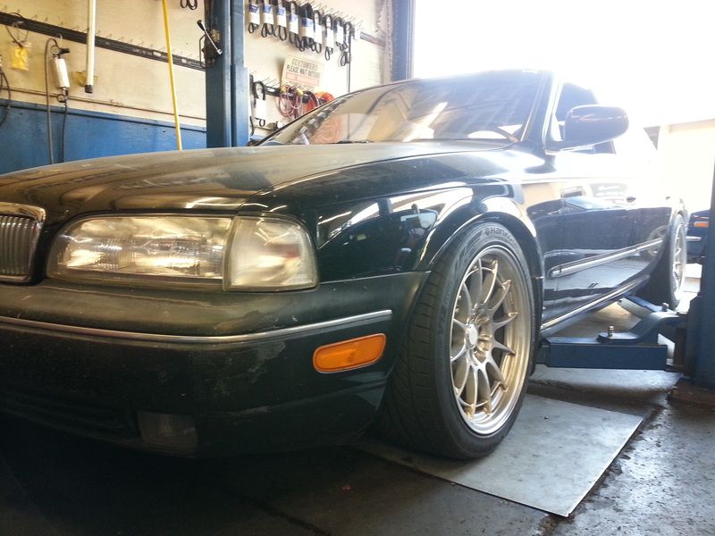

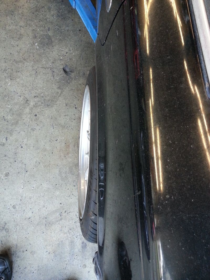

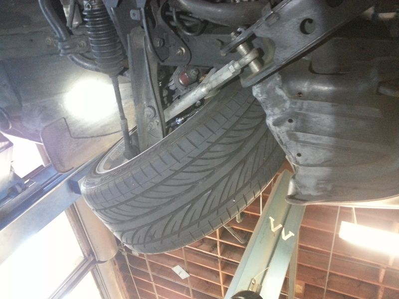

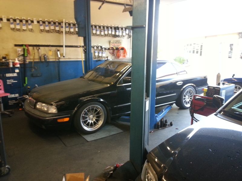

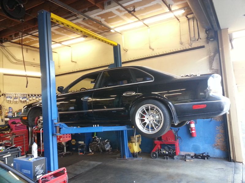

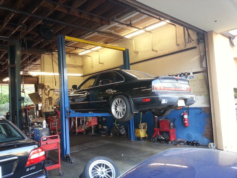

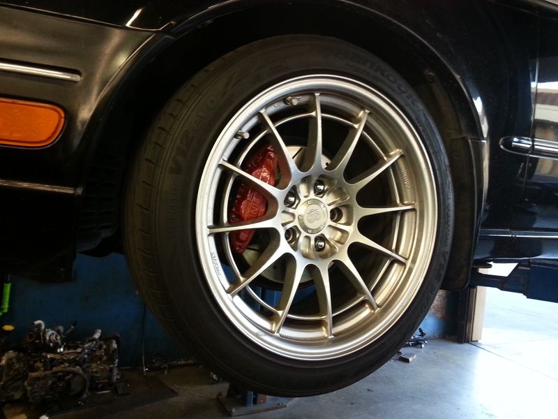

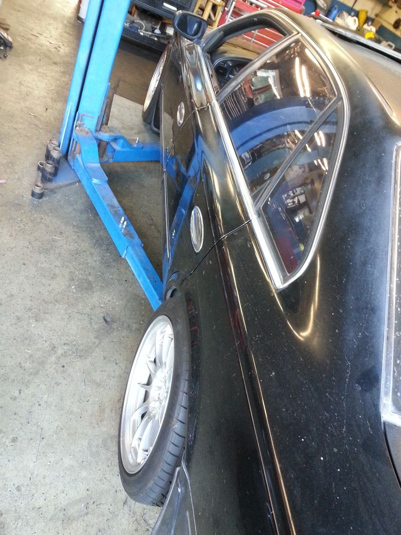

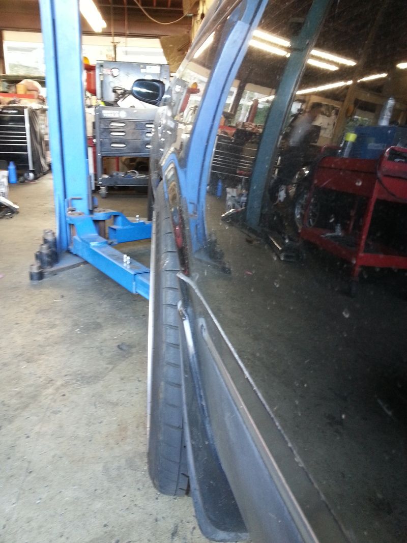

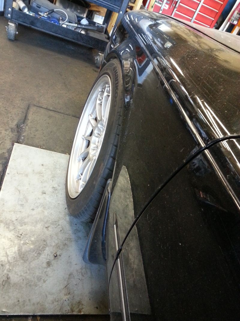

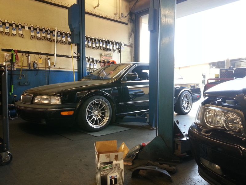

So my friend was so kind as to allow me to test fit his wheels.
18x9.5 +27 Enkei
they fit perfectly in front, but poked out nearly an inch in the rear.
too small for 275mm race tires.
I will most likely go staggard to cut down on the cost. or go full retard and get 18x11 all around with fender flares. Does anyone know of a flare that fits well on the q45?

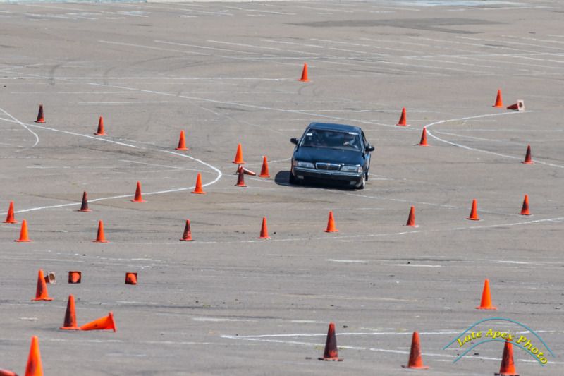

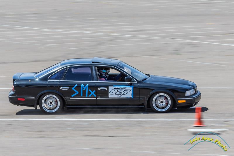

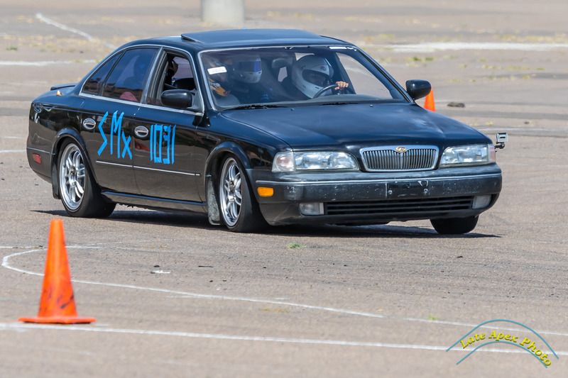

A video of this car in action at autocross last weekend. I'll upload more media soon.
Some notes I took when driving.
Race notes.
Front rotors overheating, two solutions, install rear hawk HP plus pads, build brake cooling ducts, test... Then try early brake master cylinder with more aggressive rear bias.
Center console arm rest gets in the way when steering, removed and had more control.
xcessive seat bracket/bucket improved handling and confidence many times over. No more sliding and holding on to steering wheel to anchor myself.
Hawk HP+ pads bite hard and cause early lockup, do not over-heat early. Higher braking confidence however, need to iron out proportioning and rear effectiveness.
Power steering heatsink worked well. 8 laps back to back (co-driven), only raised level slightly. No longer boiling over and causing loss of power assist/air in lines. Could improve effectiveness with small cooler fan.
Stock limited slip is overheating and lost most effectiveness after a few corner exits. Need to find a solution. Not vital at this moment. Will revisit.

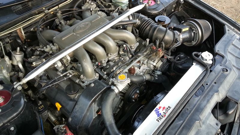

Engine Cooling system works flawless. (Upgraded radiator, and electric 2,500cfm flex-a-lite fan
Relocated fan control probe to lower radiator. Doesn't stay running aimlessly there. Temperature stayed steady and performed perfect in these conditions. Fan cooled motor efficiently and turned off quickly. Dual driver/75-80° ambient temp.
Slight under steer from front. Current -2, Rec go -3 or -4 total degrees. Retest with new tires. Rear camber is good. -1.5
old z32 suspension causing unwanted drift/sway bounce, dampening/valving is too soft for q45.
Felt need for oil temp/pressure, and voltage gauge. Possible AFR gauge.Last edited by subtledriver; 05-04-2015, 08:22 PM.

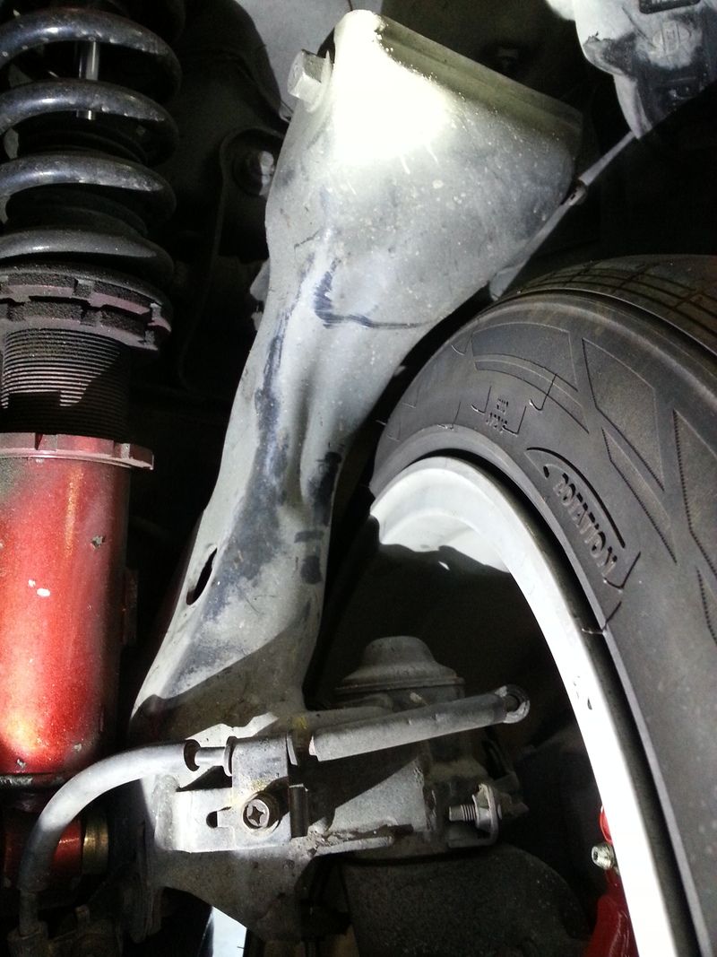

here are some pictures of my setup;;;;;
I decided to mount it in the fender liner in front of the passenger tire. so it wouldnt cause more heat soak in the engine bay.
took an extra qt of full synthetic atf over stock and turned the wheel baclk and forth a few times while adding fluid to the reservoir. then turned on the car and added fluid while turning the wheel lock-to-lock to get all the air out. was bled in a minute or so. if you are having trouble bleeding, you have air leaks in the suction hose or the return hose.
