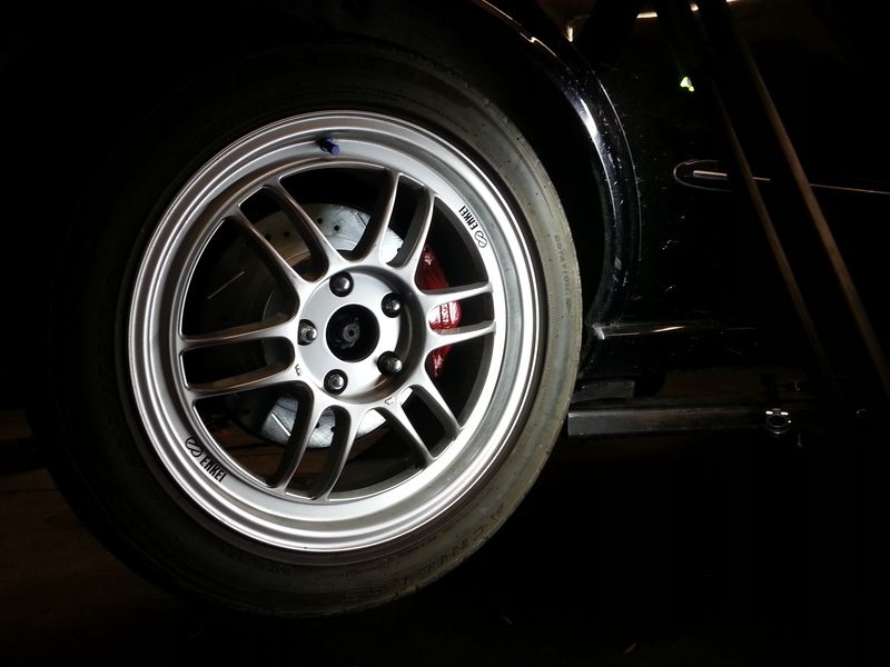

        Test fitting wheels
        So my friend was so kind as to allow me to test fit his wheels.
        18x9.5 +27 Enkei
        they fit perfectly in front, but poked out nearly an inch in the rear.
        too small for 275mm race tires.
        I will most likely go staggard to cut down on the cost. or go full retard and get 18x11 all around with fender flares. Does anyone know of a flare that fits well on the q45?

            I told you I'd buy your rpf1's. And it looks like you could do a real aggressive roll and pull for the rear. And as for flares I bet you can get a set for a s30 to fit with a little manipulation

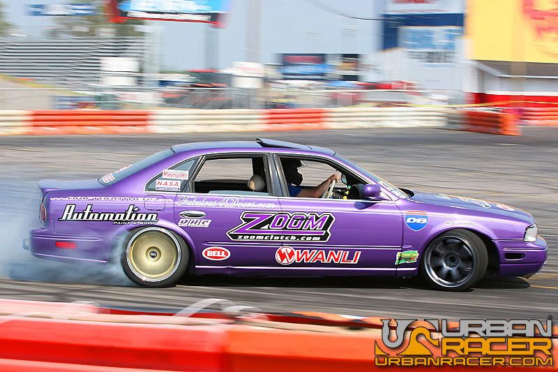

                        Purple looks pretty cool too!
                        This shade of blue is nice too, but I like being the only blue Q in San Diego lol
                        Can't drift when you're a broke college student
                        • #27
                          Thanks for the input buddy! I like that idea, but I also like a sleek shiny black to start things off. lets see what other ideas come out of the woodworks.

                            Hey Zero Kool... What is your instagram?
                            Do you know anything about that Purple Q45?

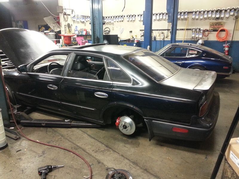

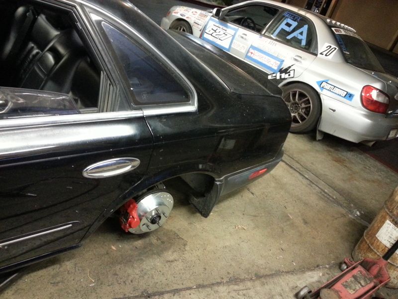

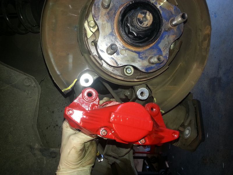

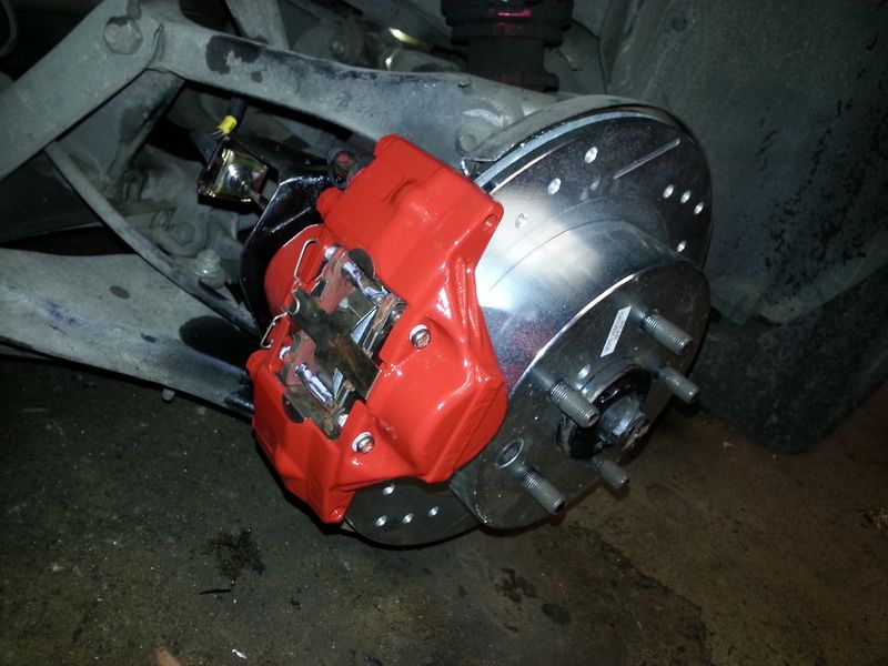

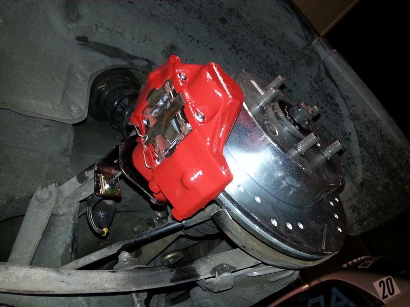

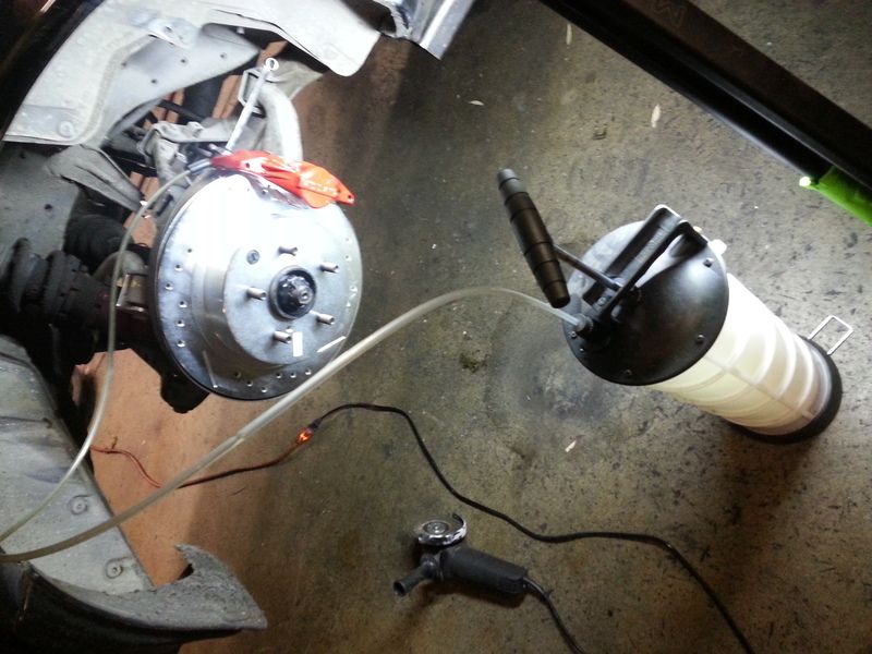

                              Lets upgrade the rear brakes to Z32/r32 calipers/rotors with hawk hp plus pads.
                              Z32 stainless rear brake hoses were used... needed to bend the mount on the caliper to get clearance.
                              stock setup = Good enough, but not much aftermarket support.
                              time for aluminum twin piston calipers and vented rotors...

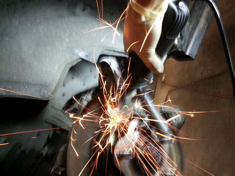

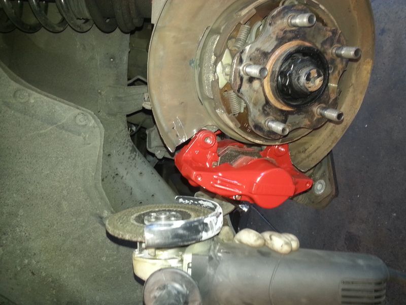

                              Backing plate too big, need to trim a little for clearance.
                              Rear hose bracket has clearance issues, so I simply bent it out of the way.
                              Store your photos and videos online with secure storage from Photobucket. Available on iOS, Android and desktop. Securely backup your memories and sign up today!
                              Now it is happy.
                              Next I am going to build custom front air ducting for the front brakes, planning to weld on a 2.5" pipe to the backing plate and run a hose to force cooling air over the rotors.
                              Then Install the CoolShims.
