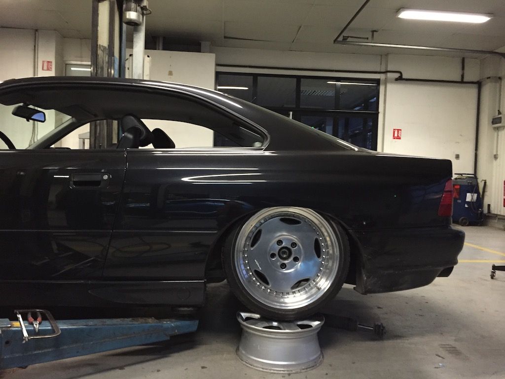

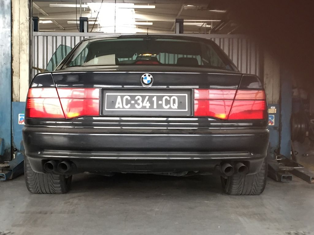

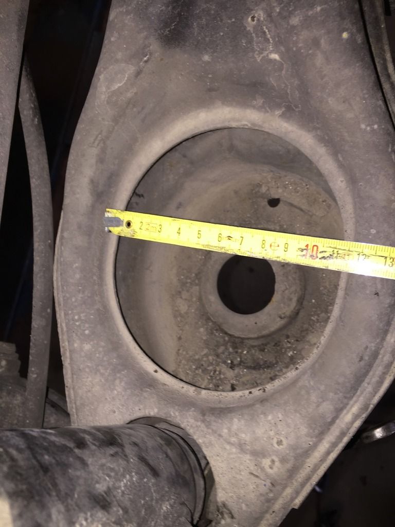

    car is on the lift to take some measurements for Bag Riders to define what we'll be the best for the 8-series
    I measured the different diameters, length and clearance I would need for the front and the rear
    So here is what I needed to know
    I also calculated the spring/wheel travel ratio for the rear which is 1.86 on this car.
    Then remove springs to fully compress the shocks and check the low I could get
    some camber
    To get that low I had to remove the rear shocks since they are 2" too long for what I want. I'll decide later what to do about that
    Checking clearance

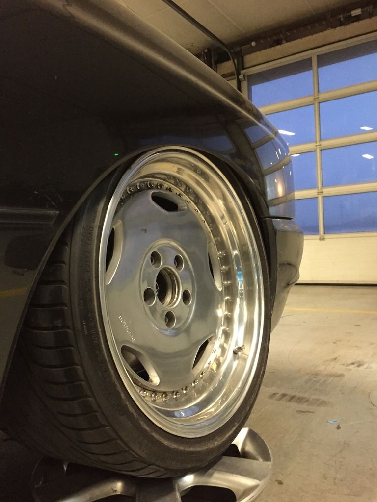

    On the outside the rear wheels are fine but inner clearance is very tight with 285/30 tyres
