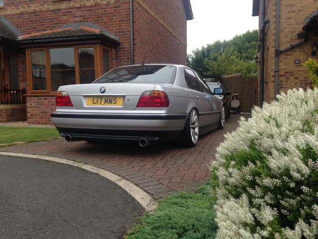

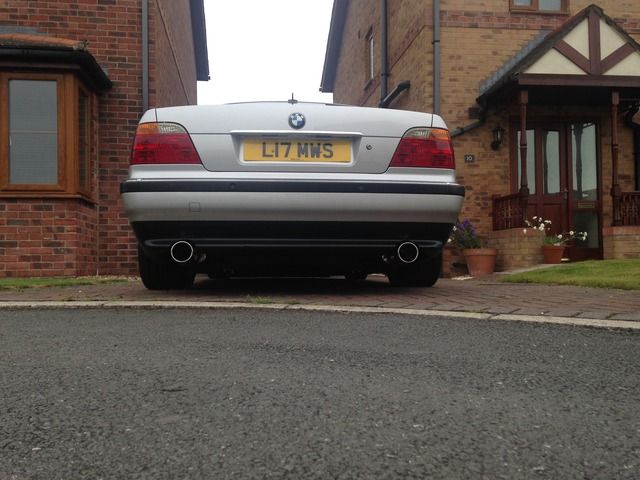

    So, I cut the rear silencers off.
    Loved the way it sounded but as I'm off to work at 5.30am on shift, it needed to be quieter.
    I now have dual 4" inwardly rolled tailpipes and a pair of stainless silencers to knock it down a touch. The bumper was trimmed also so they don't sit too low under the car.
    I've also brought the rear down another 10mm.
    I need a wheel alignment now but nobody local can touch low cars ��

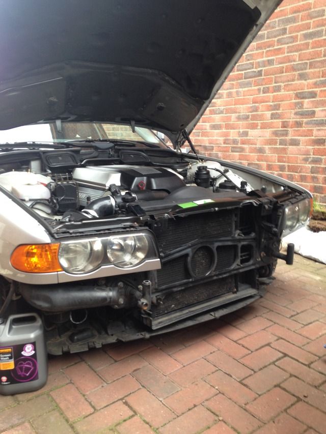

    I have also had a bit of a nightmare trying to source an AUX cooling fan, so I bought a used E39 fan and transferred the motor out into the E38 cowling. bumper has been off a few times now as I originally ordered a few non genuine fans which all turned out to be wrong.
