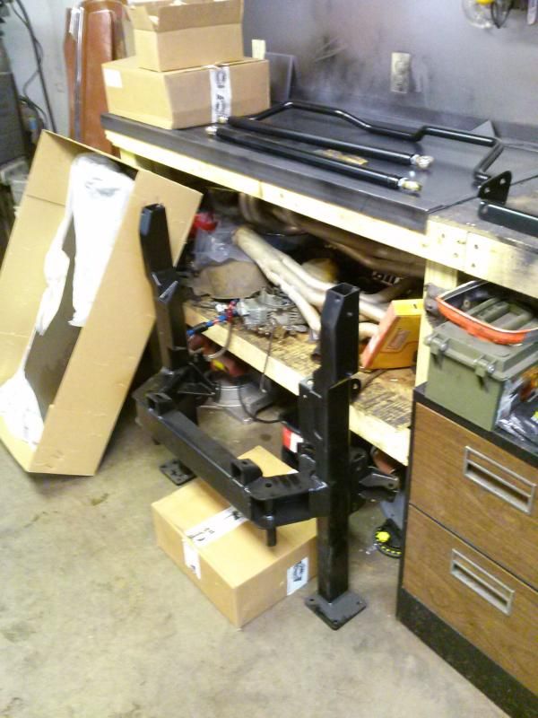

Dusty painted pieces, and my borrowed work bench
Gotta test fit the new stuff right?

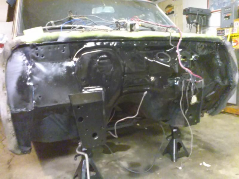

Cleaned up and painted the firewall as about 35% more of it showed now with the new subframe
re-painted the throttle linkage that hangs on the firewall as well as the wiper motor. You can also see my un-painted engine/trans lurking in the background

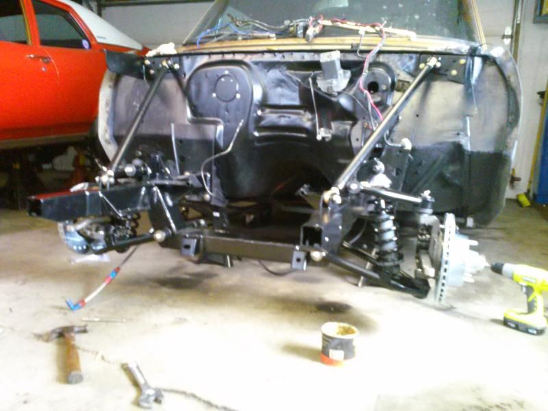

Subframe on, control arms on, firewall cleaned and painted.
Brakes and coil overs on
Test fit!

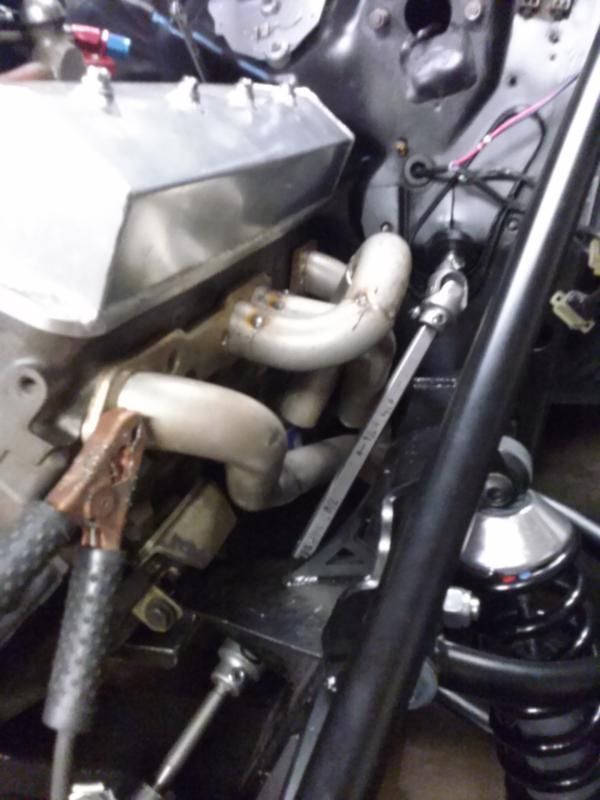

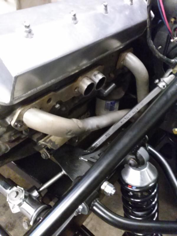

My old front end had very limited space for headers, so the ones I bought were definitely optimized for that set up. Well, now I had all kinds of room, but oddly enough the new intermediate shaft for the steering interfered with my old headers. They were a craigslist score to begin with, so I didn't feel too bad when I did this.
This process was extremely time consuming, and very rewarding. This falls under the category of stuff that people tell you you "can't" do. I grant you, the welds aren't pretty, and the headers have lots of 'cheated' bends where tubes don't flow, but they fit in the car, cost me nothing, and were a solution to a problem- one I didn't fix with just money. I could've ordered a set of $600 engine-swap headers, but I'm glad I didn't. I learned a lot about welding, and will build a better looking set next time. Plus I have the satisfaction of doing something I never thought I could do. The bonus is that they don't leak a bit! I'll let the pictures tell the rest of the story.
Keep in mind I estimated I had 30 hours when all was said and done into welding, cutting, test fitting, re designing, and painting these, so go easy with the criticism.
