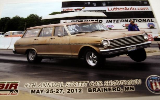

        Finally later on in the day one of my buddies comes up to me and starts hootin' and hollerin' about how my car was leaving the line, it was pretty aggressive he said...
        This is one of the coolest things I've ever felt in my car
        picture of a picture I know, but there is light under that left front tire! maaaany beers were drank in celebration of my first wheelie that night!

          That weekend I actually ended up winning my class which was sweet, though I won more because the other guy lost (ran too fast) than anything else, but a win's a win right?

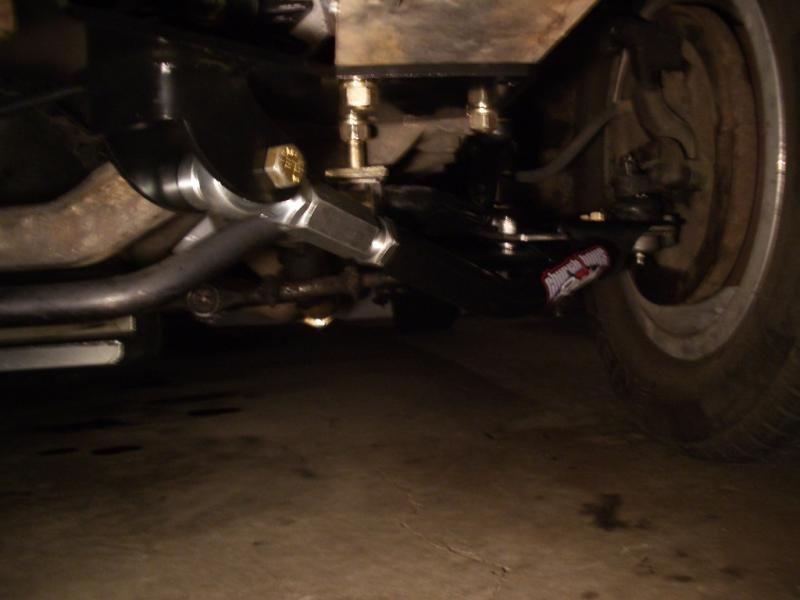

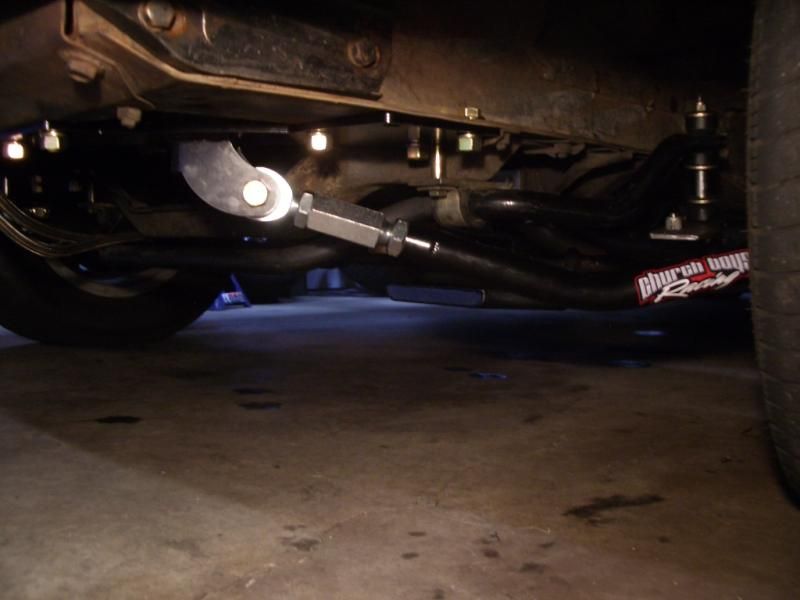

          I ran the car a few more times that summer, noting two things: First and foremost the front suspension and brake situation (arguably the worst front suspension GM has ever designed, and mechanical drum brakes) needed a dramatic update, and secondly the car still had issues on the top end. It pulled a lot stronger throughout the RPM range now that the trans was actually holding in high gear, but I had a fuel pressure gauge on it and it would read about 1psi going through the lights, a carburetor only needs between 6-9 psi but none the less it was low.
          I decided to ignore the fueling issue as the car wasn't sputtering or anything indicating an overly lean condition, and focus on the front suspension. I ordered a set of tubular lower control arms that eliminated one of the biggest weak points of the front end- the strut rods. Lots of cars use them, almost all are more efficient than this 1963 design. It was essentially a 5/8" threaded rod that bolted to the lower control arm and had a bushing under the front bumper allowing it to pivot with the control arm. Those bushings go bad, the lower control arms are weak anyhow, you stop hard and you can see the front wheel moving forward and back in the wheel well. It's ugly. I went forward with the new lower control arms, took almost no pictures as usual, but I did find these of them installed.
          These helped

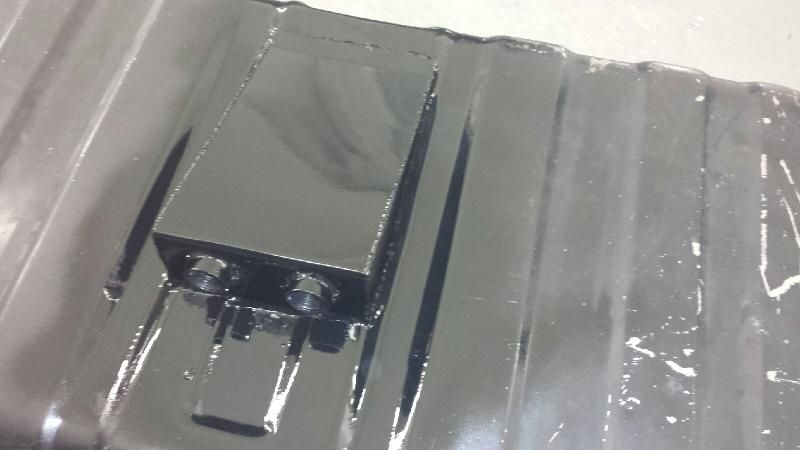

              Fall came around, lower control arms were installed and functioning, I decided it was time to spend more money. I mean address other problems, namely my fueling issue. It's pretty common for drag cars to 'un cover' the factory pickup tube in the gas tank. Under hard acceleration that antiquated design tends to slosh all the fuel to the back of the tank, exposing the pickup tube to air, not fuel. The common fix for this is to build a sump on the rear of the tank, placing the fuel pick up down low and in the rear, or to install a fuel cell. Since I have a wagon, and I wanted the car to not look all tacky and racy, I opted for the sump idea.
              I ordered hardware
              pulled the tank and gave it to a good friend with more skills (and balls) than I, who washed it out and got to work building the sump.
              view from inside
              all welded up
              painted
              external view
              Many thanks to my friend Brian who built the sump for me, it turned out great.

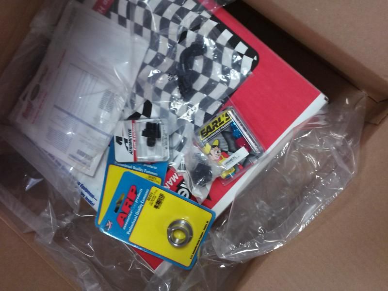

                              Stepping back a bit, Remember that big pallet of parts? Here are it's contents. I un-wrapped everything to take inventory of what I had and send pieces off to paint. The decision to have someone else paint parts for my happened before I had a garage space to work in, had I known that I would've painted them myself- I wasn't 100% happy with the results for the price I paid, but that would later give me motivation to tackle things on my own before sending them off to someone else and writing checks.
                              Anyhow, here's some 'fresh out the box' pictures of bits and pieces
