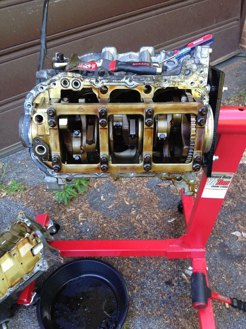

                      • #26
                        So I've been fighting with this engine for the last two weeks. I did my research or at least I thought I did before I tried breaking the engine down. Some jackass on the main gk (03-08 Tib) forum put not to open the oil pan or you risk damaging something. So I never did, I got curious after several failed attempt of seperation the oil pans from the block. Turns out I couldny seperate the upper oil pan from the block because there was like other bolts holding it together. So I am finally able to get to the crank, rods and pistons now!!!
                        • #27

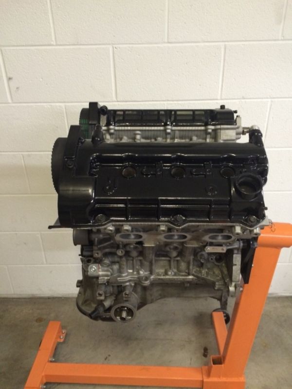

                              Small update
                              This year has been full of set backs on building my spare engine. First shop I went to balanced, and polished my crankshaft. They honed, and bored the block. They also pressed my pistons on. I asked them to balanced my pistons and rods. When I arrived to pick everything up I learned they didn't balance my rods, and pistons. They argued with me that they didn't need it. I also asked them about assembling the engine when I first dropped my parts off. They acted like it was no problem for them to do it. It was a different story when I went to pick up the parts. So I was pissed and decided to take my business elsewhere. It took me a week but I found another shop to fix the first shops mistake by not balancing everything.
                              No shop would assemble the engine because of two different shops doing machine work. I found a guy through the man who sold me the engine. Two months went by the guy was having health complications so I had to look elsewhere. The man who sold me the engine introduced me to his brother in-law who was willing to assemble it for me. Which worked out for the best because I did not have spare bolts or nuts. So the man who sold me the spare engine lended a spare engine for parts.
                              The engine is just about fully assembled I dropped off the last set of seals and gasket. So it should be done soon.
                              • #30

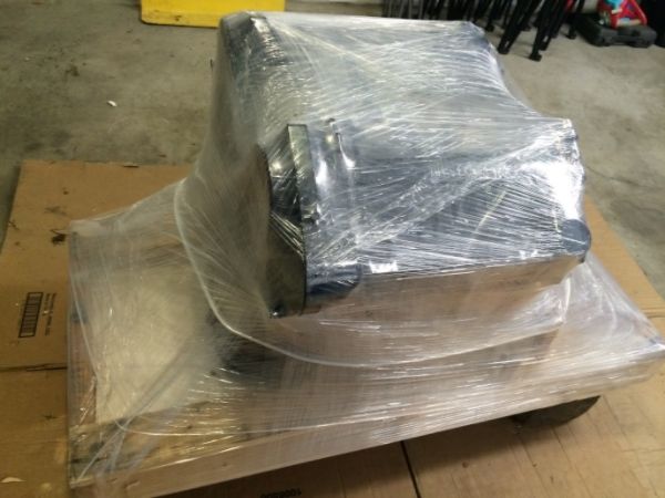

                                Woohoo!!! Finally a light at the end of the tunnel!!!
                                She's all wrapped up and ready to go the installer's house.
