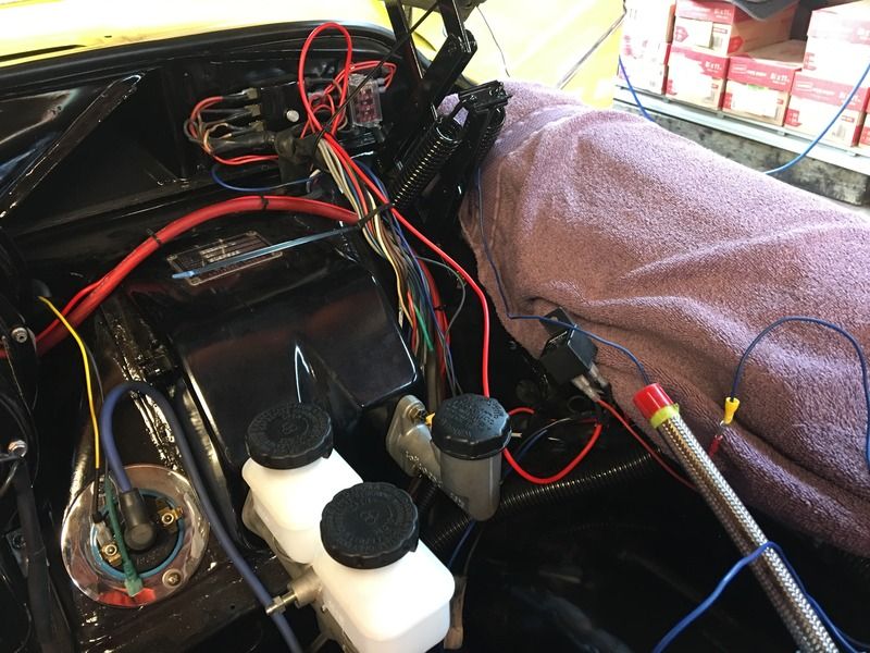

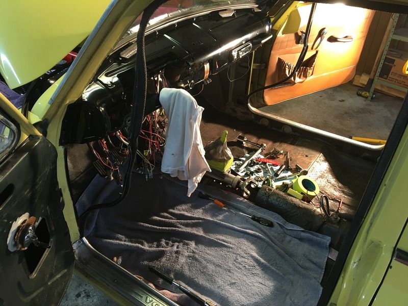

After spending all day Saturday and some of Sunday, I figured out the electrical issue. I will need to run a separate switch for the lamp lights for the cluster (voltage drops down with all the new gauges piggy backing off it). Blower motor sounds like it needs a little lube... All in all, very happy.

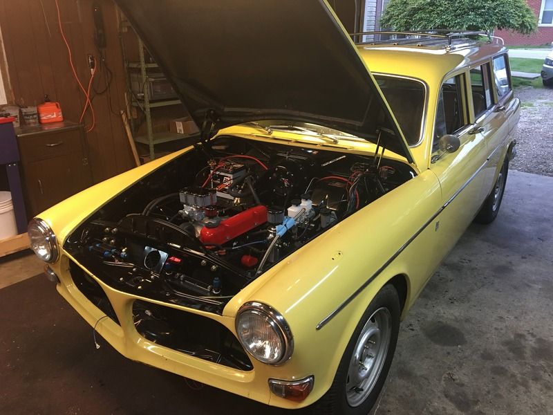

Here is a few update from the weekend and tonight...
I wanted to use the original light switch to control the lamp lights for the new gauges... When I went off this terminal, the voltage would drop to around 5v and only one gauge would work. I decided to wire in a relay and now the gauges are nice and bright (will post a night shot once the wiring is complete/ cleaned up).

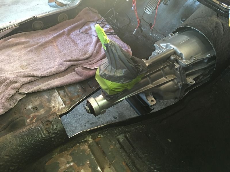

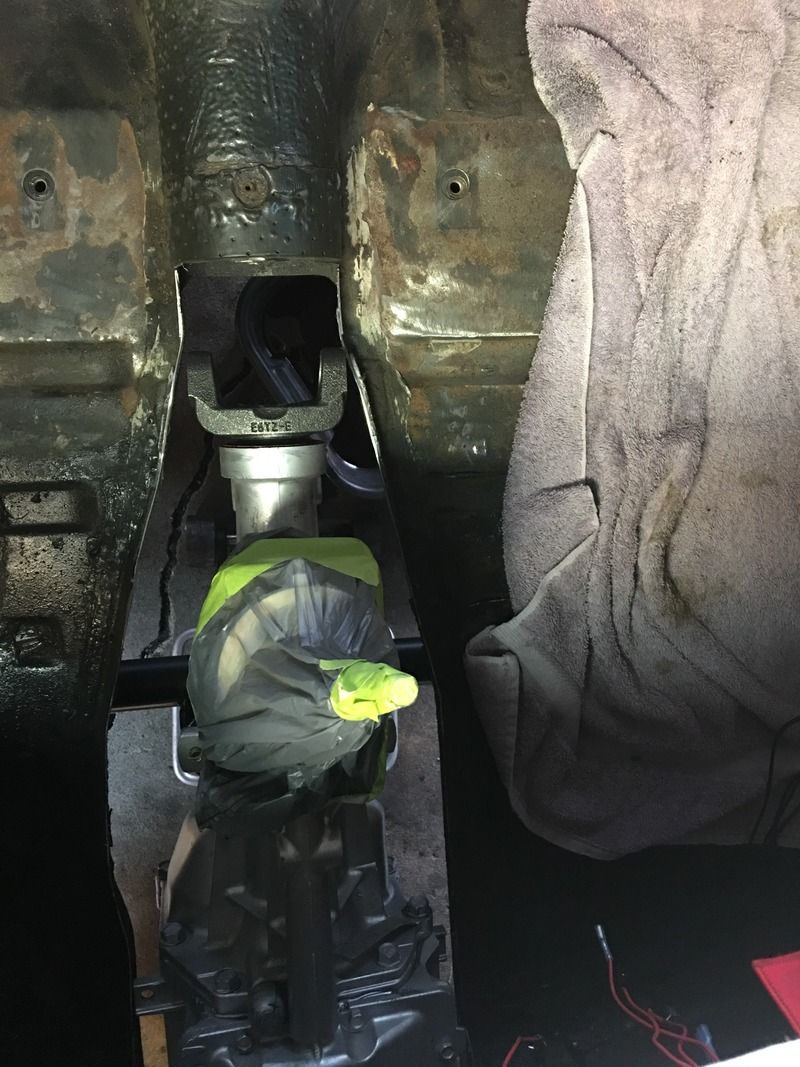

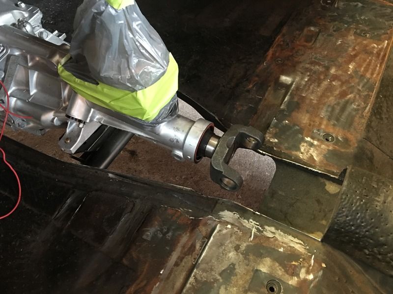

I also had to modify the tunnel... Again... I knew the tunnel would have to be modified for the T5 swap... Didn't realize how much was invloved till did it.

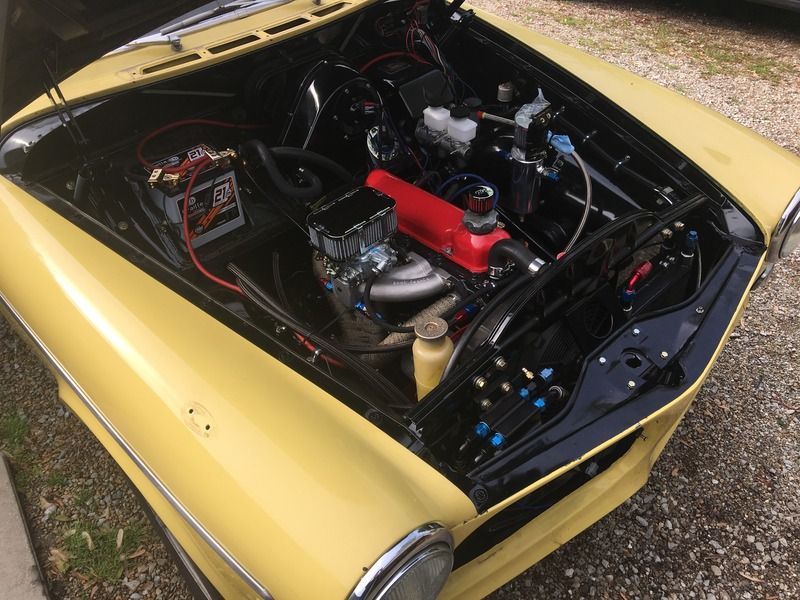

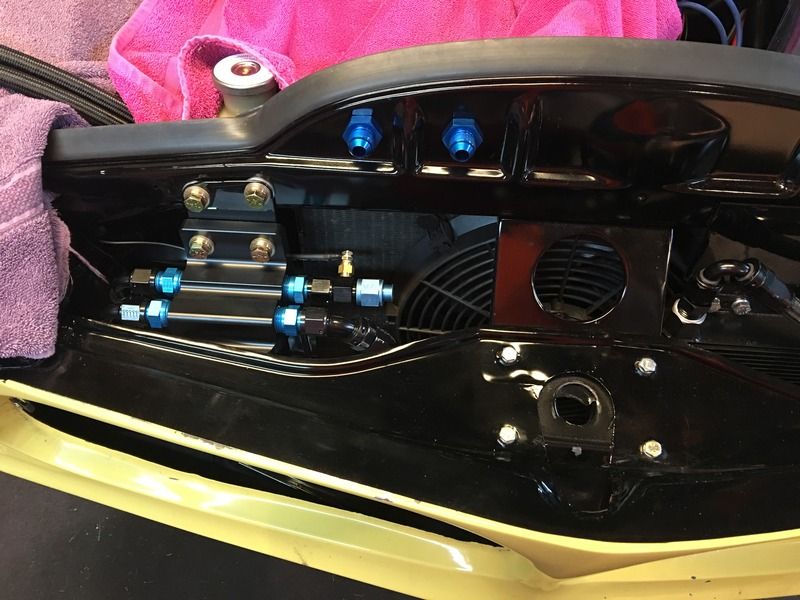

I installed bulkhead fittings for the oil lines... Not really what I wanted to do, but it should work. I'm a slut for a nicw AN fitting. Haha.

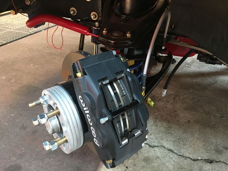

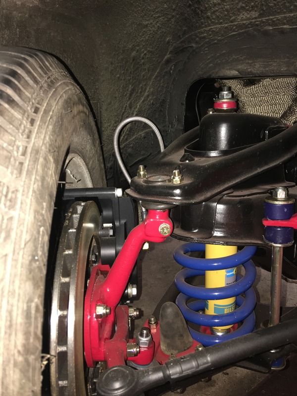

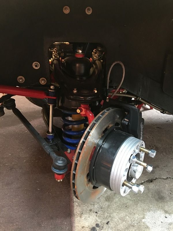

The break lines also came in with the outlet adapters. Still waiting on the inlet ones. I went with 16" lines (-3). I may have to go shorter with a different set of rims, but they don't seem to hit with the current set. Pictures taken at full locking position.
