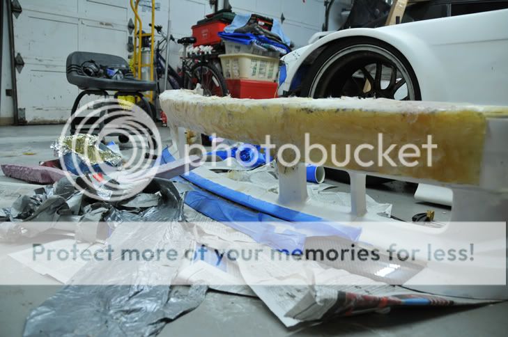

Started with a fiberglass mold of my friends e46 hood to create the nose piece:
so then step 2...
 wait...
yeah i actually ended up throwing everything away except the kidney housing
So next step after the headlights came in was to mock them up...fail.
they sat too far out in front of the bumper, this is what i was worried would happen..so I decided the best solution (since they all were a lot of work) was fabricate my top half to the bumper so it came out far enough to meet up with headlights, in progress:
prepped and ready:
Glassed:
After that, I attached my new bumper clip, laid filler and it was good to go
next step: the hood. I used that kidney grill housing from above and the headlights to create a mock up, then more glass:
popped that off, trimmed it up, and slapped on some filler:
and this is where i leave you for the day gentlemen, i didn't really want to post this up until i got it a little more cleaned up, but i figured this thread deserved an update, long way to go still, but for the most part all the structural components are done, just need to fabricate the corner pieced for fenders, and clean up the headlight socket and then the major glasswork is over with
