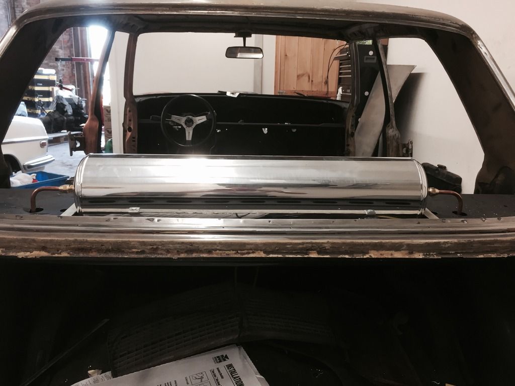

Also that tank placement is perfect.

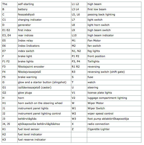

Hi!Originally posted by dineno View Post
Very nice build, I would also grab the chance to contribute to your build, since I am Hungarian I translated the missing parts
C: generator regulator
F3: brake fluid level encoder
F4: brake fluid indicator
G1: glow indicator (for glow plugs)
J3: interior lights
J4, J5: door switch for the interior lights
W3: wiper switch for the foot
Hope I could help, if you have any questions left feel free to contact!
edit: I've just realised that 'index' is a Hungarian term, if you haven't found out already, 'index' always means 'turn indicator light'Last edited by Veesenmayer; 04-20-2015, 04:34 AM.

Oh wow, thank you for that. I was trying to figure out the untranslated ones by process of elimination but some just weren't making sense.Originally posted by Veesenmayer View PostHi!
