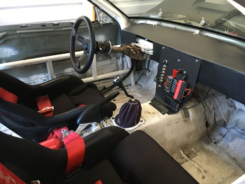

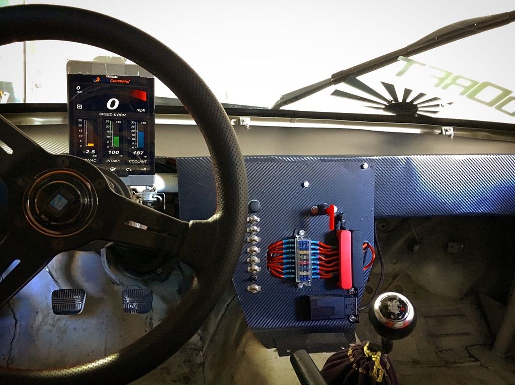

                    WIRING/ELECTRONICS
                    Wiring Specialties s13 - ls1 pro series harness modified to eliminate pcm fuel & fan control
                    no relays in chassis or drivetrain harness
                    4 seperate circuits on primary bus, 4 switches, 4 fuses
                    fans, pcm, fuel, starter
                    aux bus controls non mission essential functions
                    4 seperate circuits on aux bus, 4 switches, 4 fuses
                    lights, exhaust cutout, turn signals, horn
                    glass display - all gauges, ipad mini
                    logs data, displays all pertinant pcm data
                    connected to pcm through blutooth obd ii port
                    dakota digital sgi-5 signal conversion on tach output
                    Optima Red top battery
                    battery relocation taylor cable box
